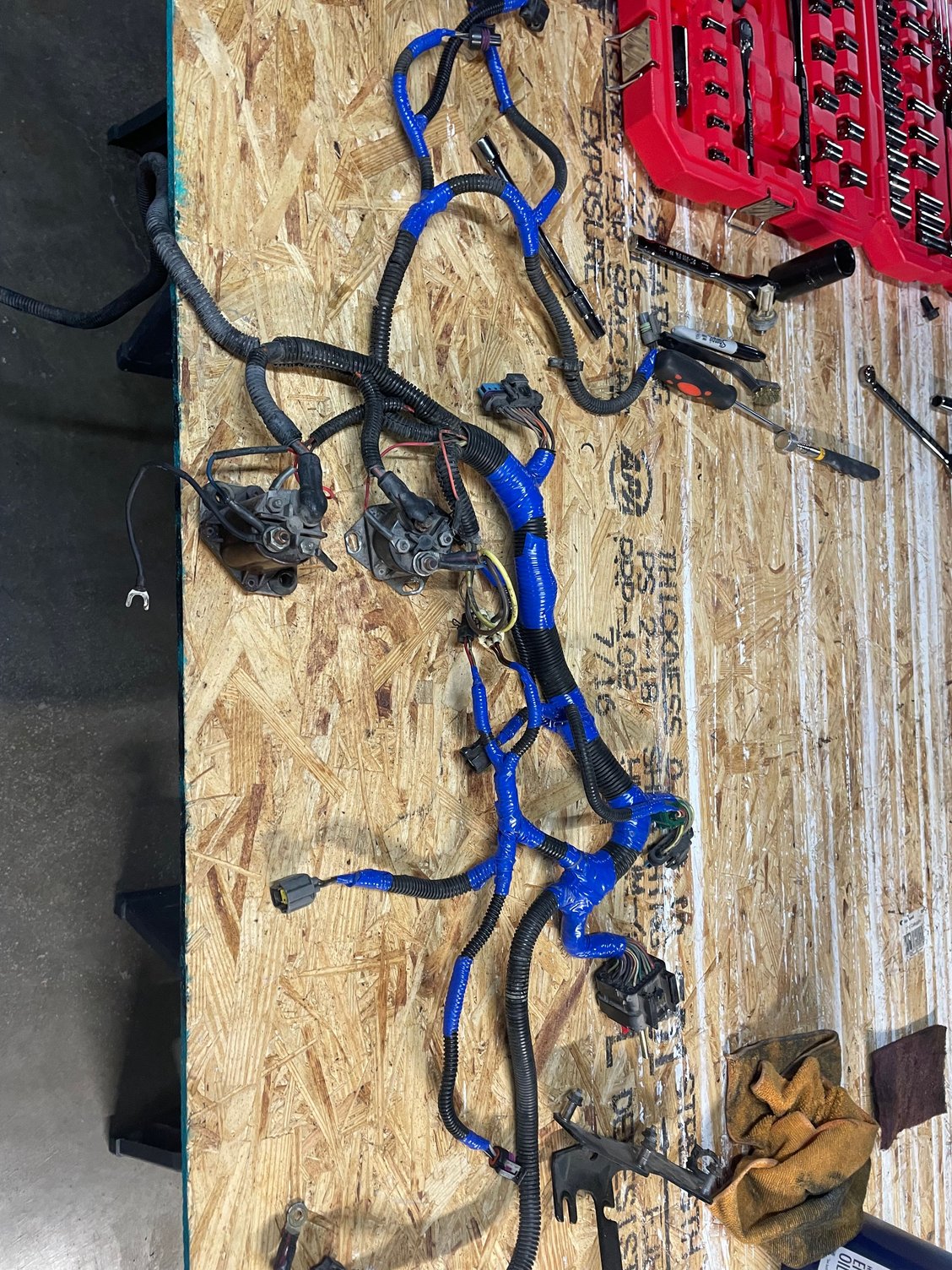

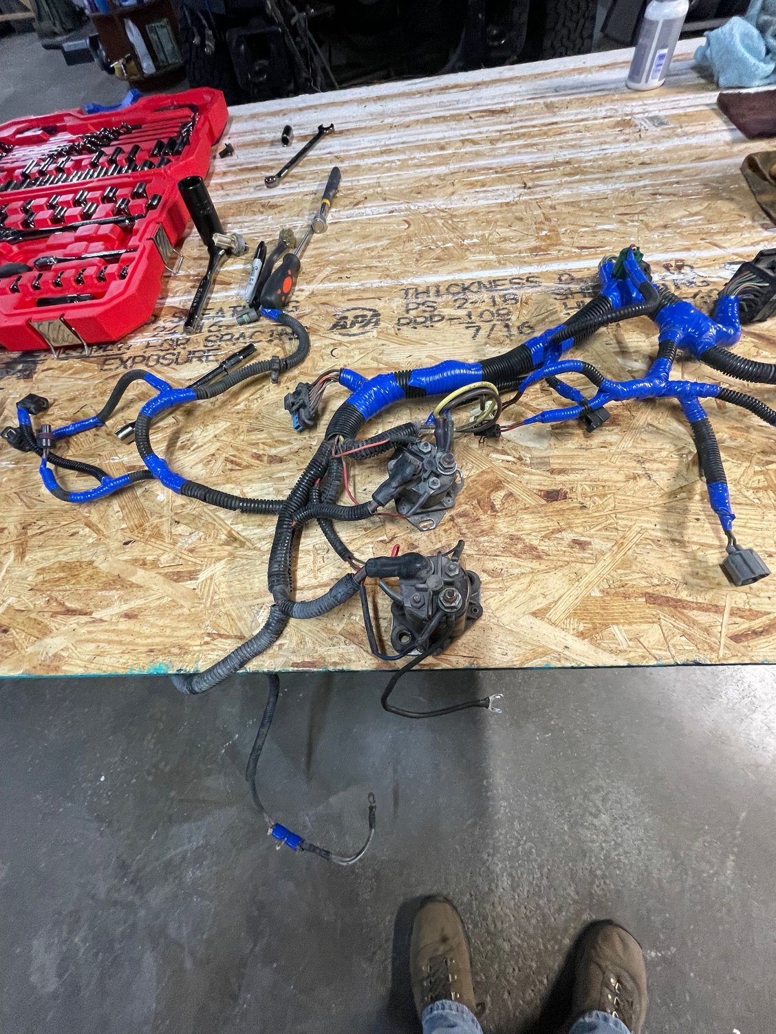

I got em. The wife was down there just listening while she worked out, just had to keep telling myself, happy thoughts, happy thoughts. Got it all in, turbo fully mounted all clamps on and up-pipes are tight.
Tore into the wiring harness, got it all taped back up and am putting my list together to relocate the GPR. For those of you that have done this, did you get rid of the AIH relay? Or move it somewhere? I deleted the heater and have the resistor, just wondering if it’ll throw a CEL if I just tape the wires up and tuck them away? Or is it just a soft code?
Tried to clean it up and replaced some of the old brittle loom. Most of the pig tails look ok, not the best but not the worst. I have a new rubber seal piece for the IPR connector as the old one was complete mush and goo.
The bracket is NOT going back in.
Hope to get the harness in this week, and the accessories back on, with any luck I’ll just be waiting on my new fan and condenser to arrive.
edit still need to figure out what im doing with the 42pin connector…..seeings how I cut the head of the bolt off and all that. Don’t know if I could rig something to keep it tight or not.

I deleted the aih relay. It's just a soft code.

42 pin, could you put a bolt clear through it with a nut on the other side? 🤷‍♂️
Sorry if that’s a dumb idea. Been a while since I’ve had mine apart. Picturing the nut built into one piece and the bolt built in the other.

I honestly haven’t even looked at it, but I recall reading on here someone with the same issue was able to gain access to the nut. If I could do that, I could figure out a way to either get it out, or re-secure it, via glue or a new nutsert or something along those lines. I’ll look into tomorrow when I get home.

That's kind of what I was thinking if he could get broke piece out. Or drill plastic out and put a nutsert/rivnut in it possibly?

For the 42 pin you could always apply the Redneck Arts with some twisted up safety wire to hold the halves together.

Good ol' fashioned rebar tie wire, will be the temporary fix. I'll put it out there for the world to hear! Tore into it a little bit tonight, got the wires ready for the gpr extension cables, and taped up all of the aih wires (dont want to cut them.....just yet, I know it looks half assed, but I have my reasons). Messed with the 42 pin connector and immediately started breaking crap. Done. Its near impossible to gain access to the backside, with all of the wires still connected, and without that access, I cant really get to the back of the nut, so I am just quitting while I'm ahead. Have some time off the next couple of days, going to try and get the wiring harness back in, and basically button it all back up. Putting the new AC parts on hold for now, as well.......in Ohio I wont need AC until may at the earliest, and saving some dollars is nice while work is slow. Getting the fan ordered first thing in the morning, had planned on doing it earlier this week, and completely forgot about it as I was cleaning some stuff up this evening and looked over at it and said shoot I might need that!
Need to watch some youtube ed-uh-muh-cation videos on getting rid of the useless vacuum hoses as I have manual hubs, does getting rid of that solenoid throw a CEL or just soft code as well? Soft codes I can live with as I'll know what they are, and am the only one that will ever work on my vehicles, but I don't want to be looking at that check engine light.
