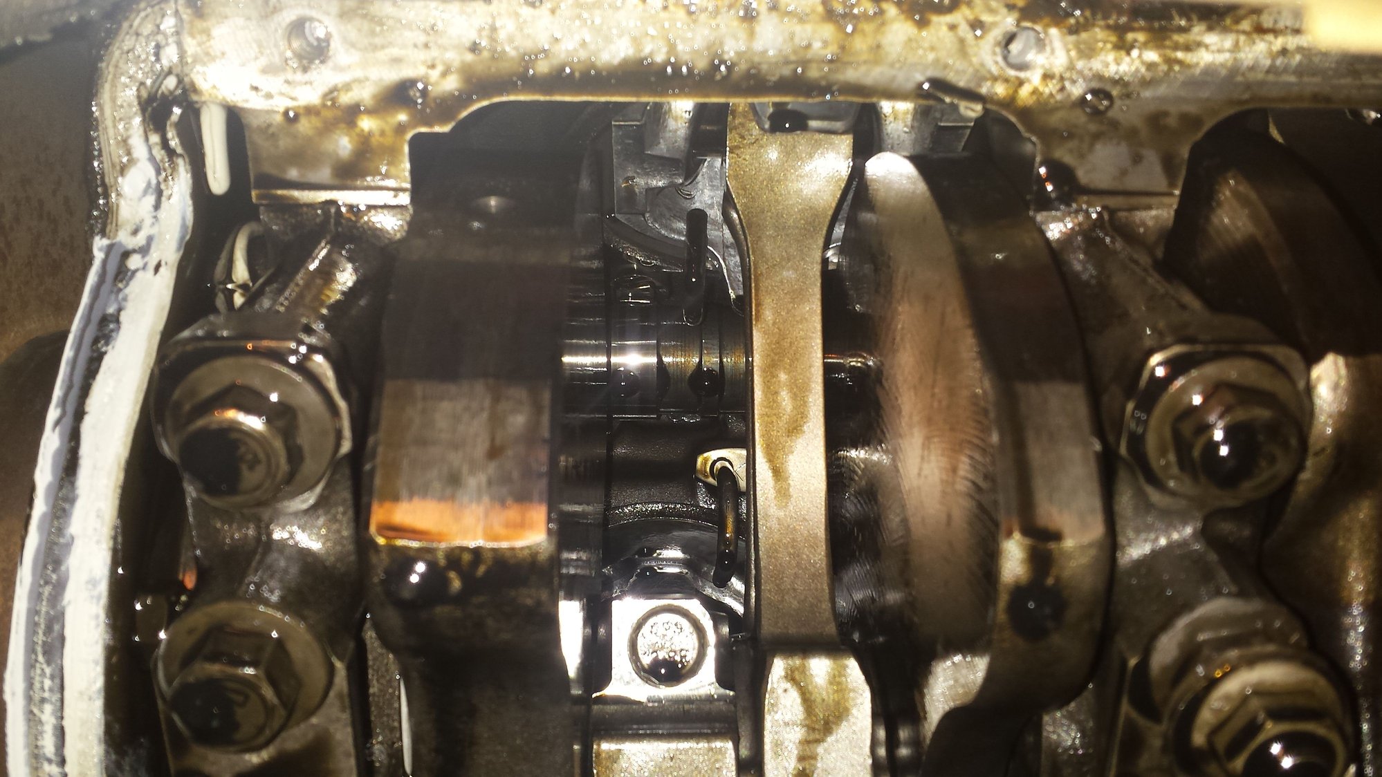

Are my conmecting roda forger or pmr I had the oil pan down the other day and got some pics

Those are PMRs.

Dang I was hoping they would be forged

how do you tell the difference between forged and pmr?

Agree, PMR because they have bolts. The forged would have nuts on the outside.
There are physical differences that are easy to spot after you know what they look like. The last picture in this post shows forged rods:

Pikachu, are you seeing nuts or bolts on the end, I see bolts which mean PMR rods. If I'm wrong and they are nuts on the end then they are in fact forged rods.

I see bolts. The shape of the bearing cap gives it away too.

OK, it looks like the differences are nuts vs bolts (they are odd looking heads on those things) and do the forged rods have sharper edges on the cap?
