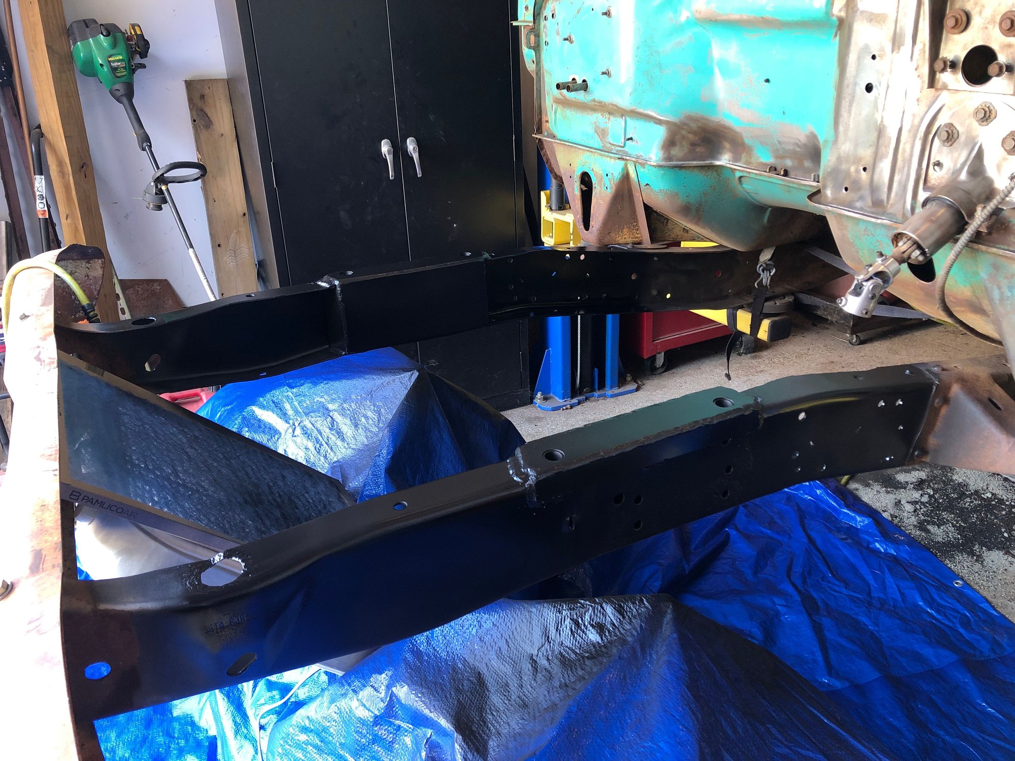

I unbolted the CV front end and cleaned the surface rust off of the frame from the cab forward. I mixed up some Zero Rust with SPI medium reducer and TP Tools synthetic hardener to paint with. A couple of coats and it was ready to be reassembled. I’ve almost got caught up with Honey Do list and the summer craze with broken AC. My next plan, is to assemble the drivetrain and install it in the chassis. Thanks for looking.
