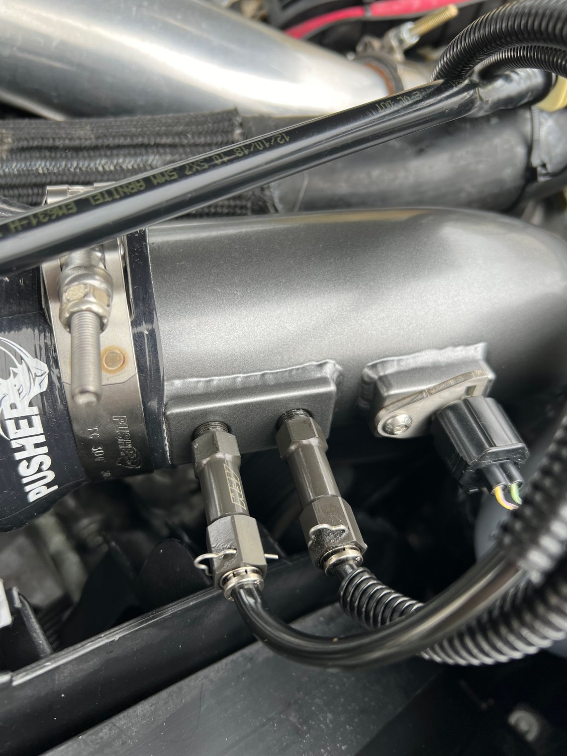

it worked . No more MAP, MAF, EGR codes. Switching to a cold side that has the IAT first, solved these codes. No more IAT getting wet from nozzle spray.
Also, I’m back to two 250ml nozzles.

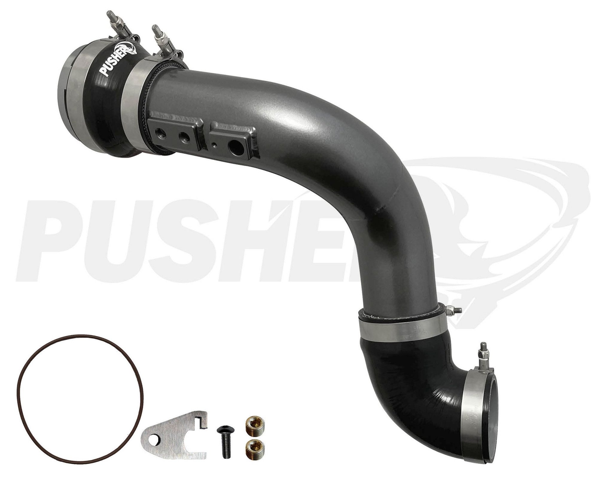

Thanks, I meant the silicone couplers... if I replace my Rudy's, I'm going with a Pusher cold pipe in case I ever do methanol injection myself.

Pusher is inconsistent about where they place their npt ports.
some picks show same side of IAT, some show opposite side of IAT.
i paid the extra charge for 4 npt ports to ensure that I would get at least 2 on the same side of IAT.
if I would have revived npt on opposite side of IAT, would have had the same wetting of IAT problem.
AND
if we say the location of the IAT in your photo is 3:00 position, putting 2 ports at 9:00 position is useless since water hose is in the way….maybe a 90 degree adapter would allow a sensor or something to be used on the 9:00 position side. 12:00 would be a problem with hood. 6:00 would be fine. So I got 2 at 3 and 2 at 9. Would have been nice to have 2 at 3 and 2 at 6.
live and learn.
if you ever go methonal, get the snow kit…plug and play…I would say AEM is less expensive…but pretty much manual system. Driving a lot of local set at 5 or 7, driving on highway set at 10, driving on interstate set to 12….oops it’s going to rain hard…set my settings to a higher number.
snow has egt sensors and one you pick your goal ( mpg or power), the snow computer does the rest. If it rains hard the snow computer will get lower egt readings and reduce the injection spray..if it is a hot dry day the snow sensor will get high egt’s and increase the spray.
for AEM, you have to decide and rotate a dial if your going into extreme situations
i paid 500 bucks for my AEM kit .
snow is a little over double that.
also, there are diesel kits and there are gas kits. Makes a difference.
