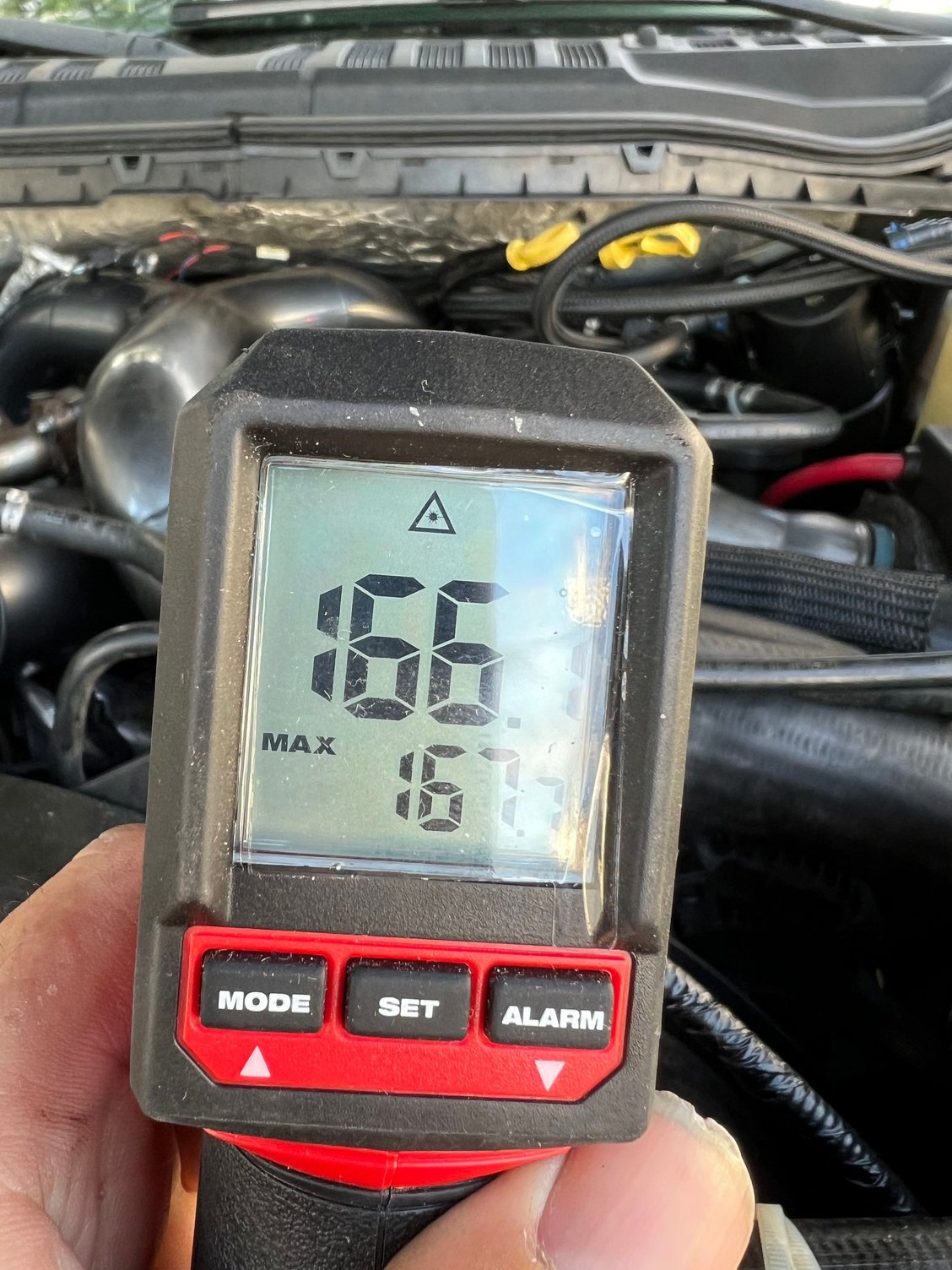

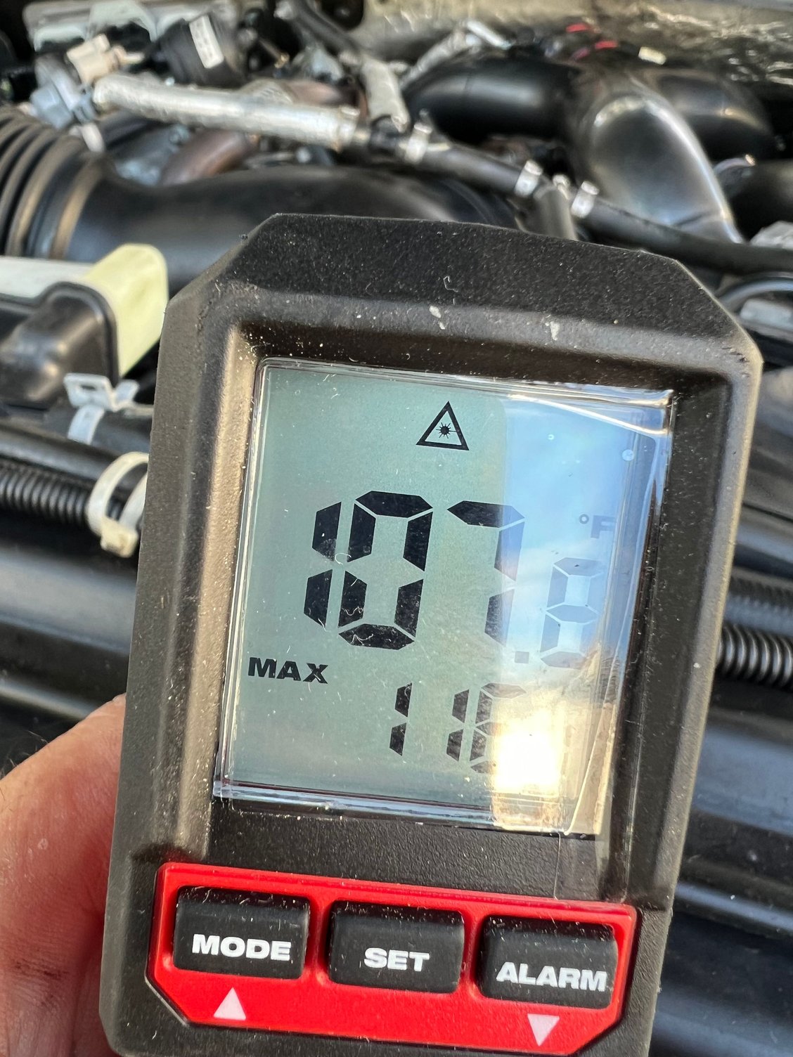

Took it on the highway for about an hour
getting better boost…don’t know if I had loose tubing before and the new tubing fixed it due to proper tightening
the dpf % soot started creeping…so at least that is t broken
temps in the engine bay dropped big time…so if the truck is rolling…it’s probally fine.
What's up with the pics of the temps? So you're saying when you pop the hood now when it's hot, they are less now than when the factory upper intake was still on?

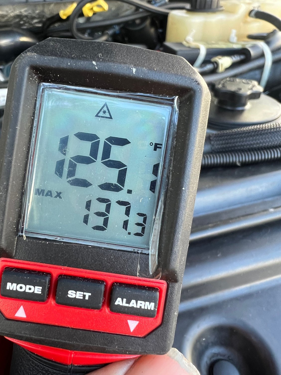

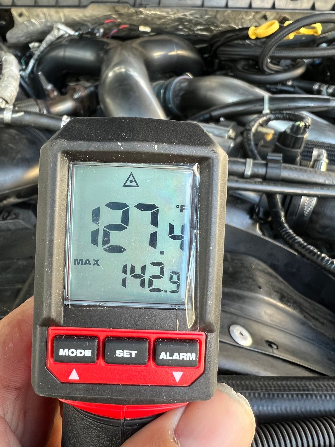

yesterday after the install I was checking things out and was idling for quite a while…when I checked the heat at various places along the tubes…I was surprised how hot the pipes were.
but today driving around town I checked the pipes when I got back and the tube temps were 50 to 75 degrees less than yesterdays idle temps.
i don’t know what oem temps are so I have nothing to go by.
my heat proof tape will arrive today. Plan on heat proofing the wires and hoses in the area of the pusher tubes.
i am also thinking about removing the sound proof blanket so that heat can more easily transfer to the hood. That sound proof blanket sits pretty low and I don’t think it helps cool things off.

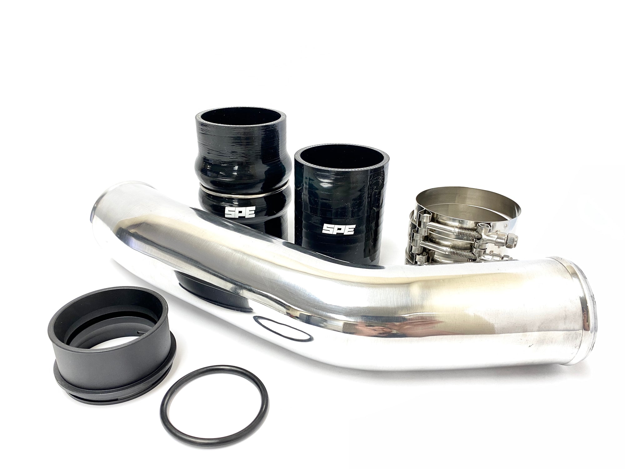

I didn't see any options at S&B for 2020+ models. Only other similar complete-kit option I've found is from SPE: https://www.spemotorsport.com/collec...ake-piping-kit
Spec'd out with raw finish, plus an upcharge of $200 for 2020+ models, and including the hot-side plumbing, ended up being $1,650. This one also comes with an extra bung for tapping into.

But I have to admit, I like SPE's hot pipe because the O-ring for the turbo adapter is thicker than factory... and they state than other competitors.
