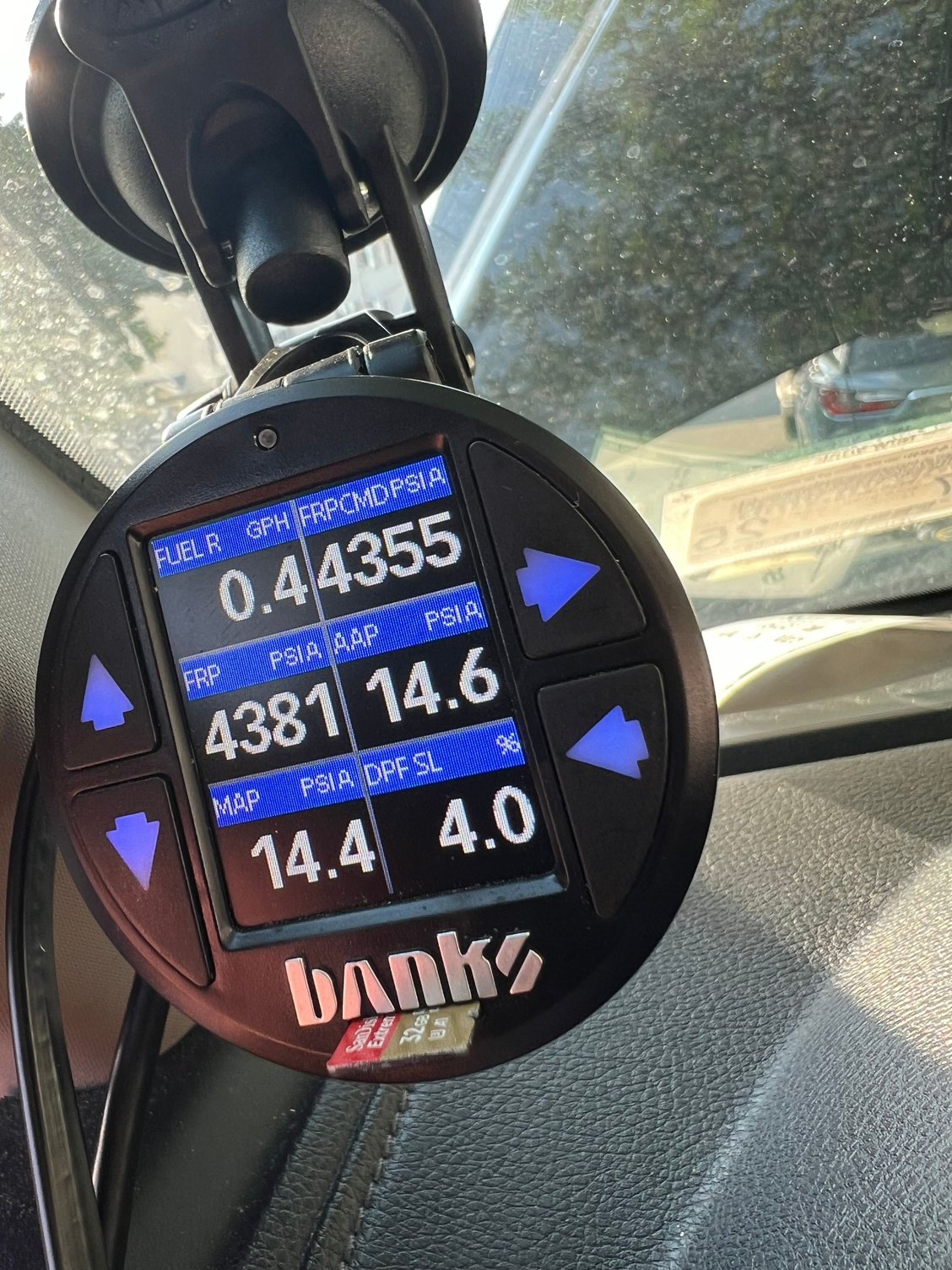

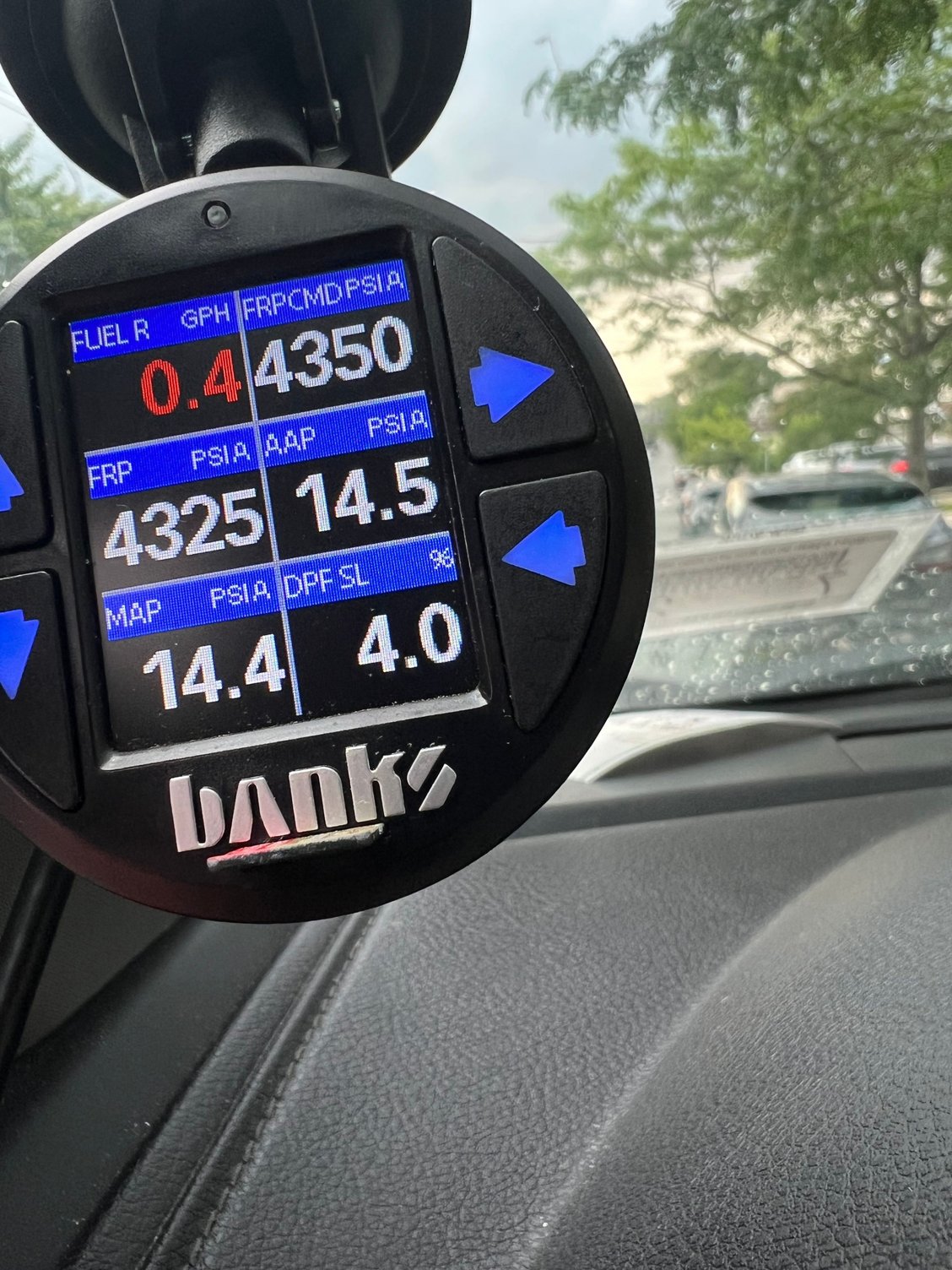

I wanted to do a basic test.
Thinking that a static regen should provide useful data
i normally have 6 to 9 percent soot left after a static regen. 9 or so when it is warm to hot and 6 or so when it is cool to cold.

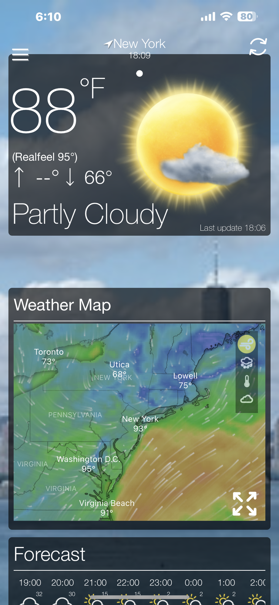

today at 88 degrees I have 4 percent left after a static regen. The truck had never finished a regen that low. So yes…it’s definitely flowing more air .
lower right hand corner is percent dpf soot .
now I am wondering if I get a dpf. Ack exhuast ….will the soot level remaining after a regen go down even further.

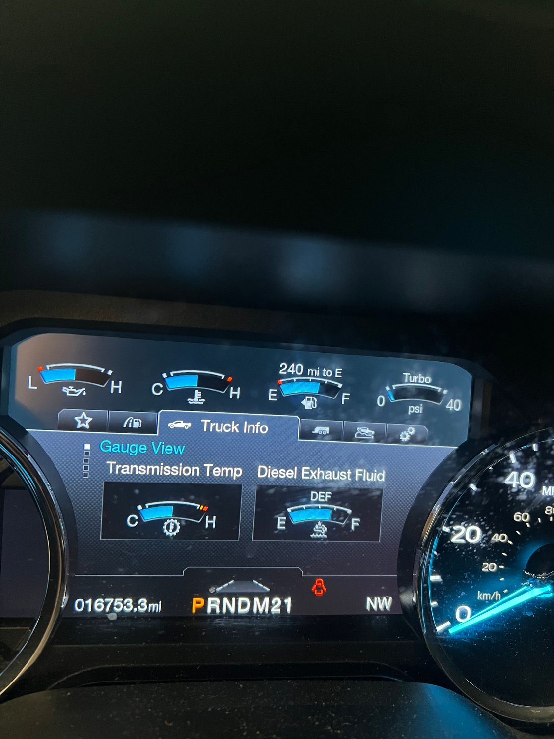

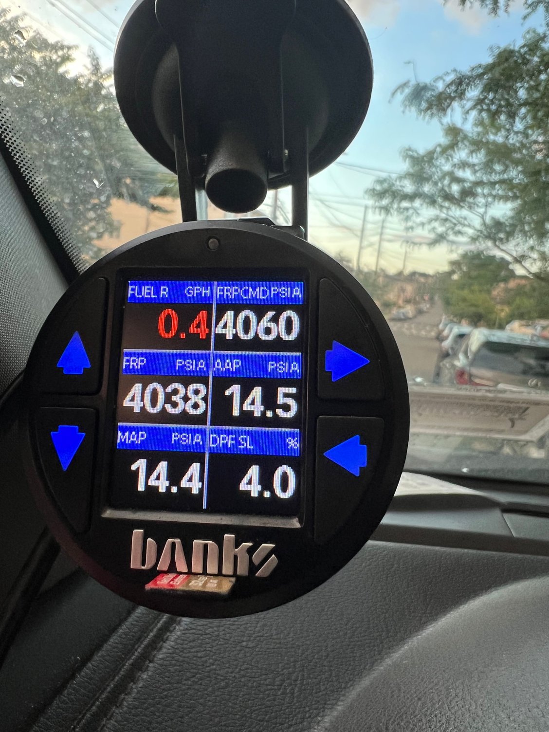

It’s been idling for over an hour
At 5 percent dpf soot level
used to start clicking up wards on percents if left idling for a while.
Old Jul 29, 2023 | 06:31 PM
  #41
speakerfritz's Avatar
speakerfritz
Joined: Jul 2013
Posts: 14,302
Likes: 2,197
Idling for 90 minutes

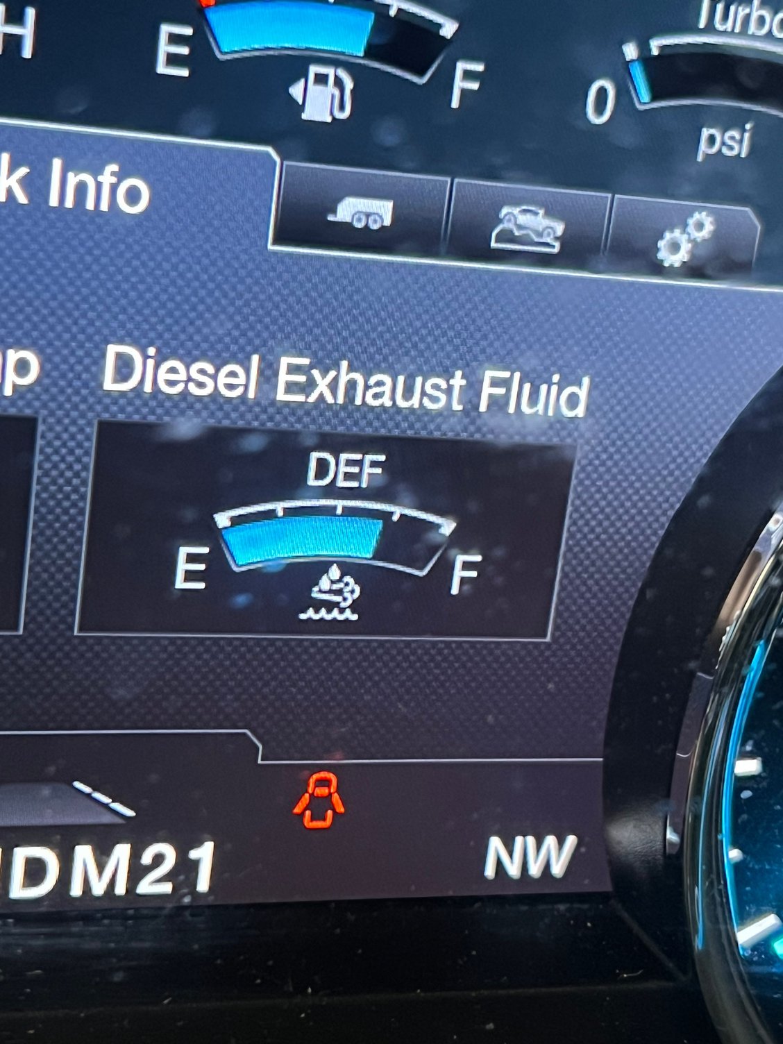

DEFinitly burning more def
it was at 3/4 point 90 minutes ago

Over 2 hrs of idling and still at 4% dpf soot level. Truck has never done this. Would have been at 15% soot level if idled for 2 hrs.
so what have I learned today
engine sounds like a diesel
creating less soot
using more def
generating more engine bay heat….ordered some heat proof tape to wrap the wires and hoses….could be hot just becuase it’s idling and not moving thru the air.

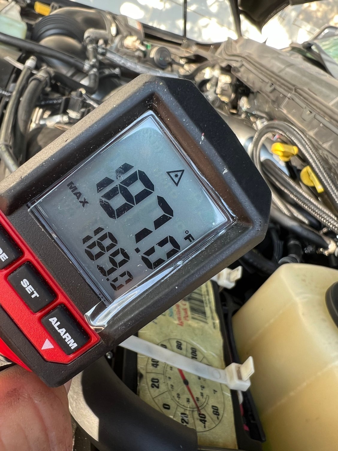

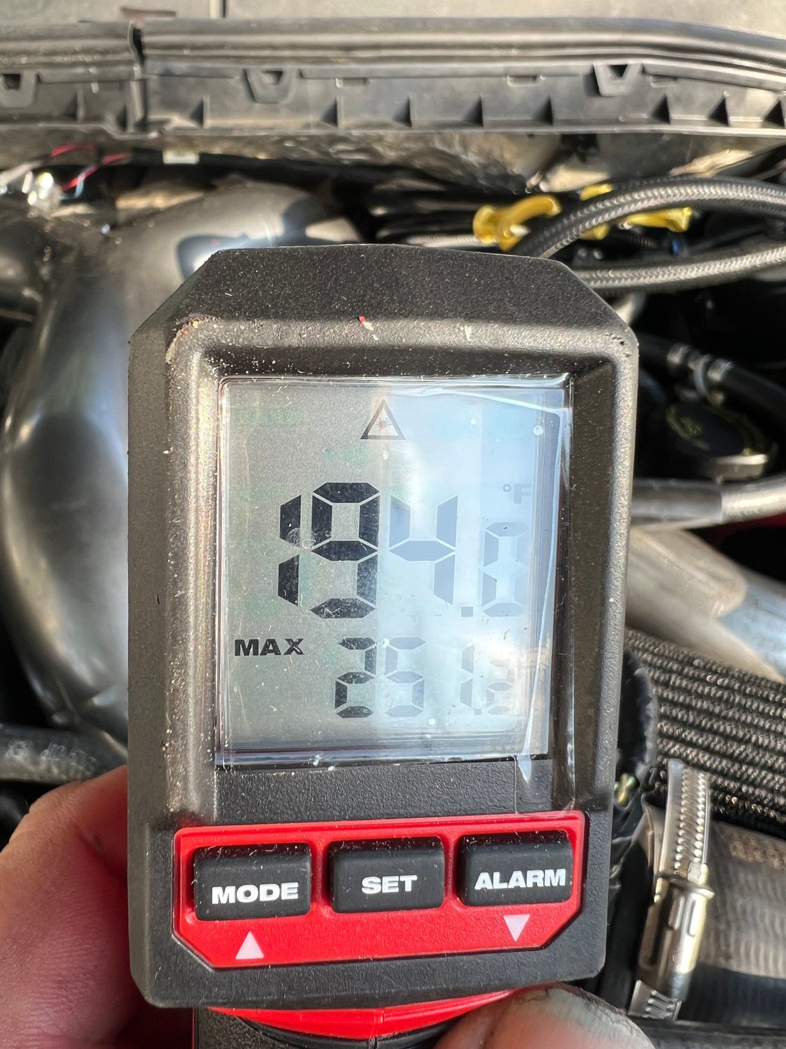

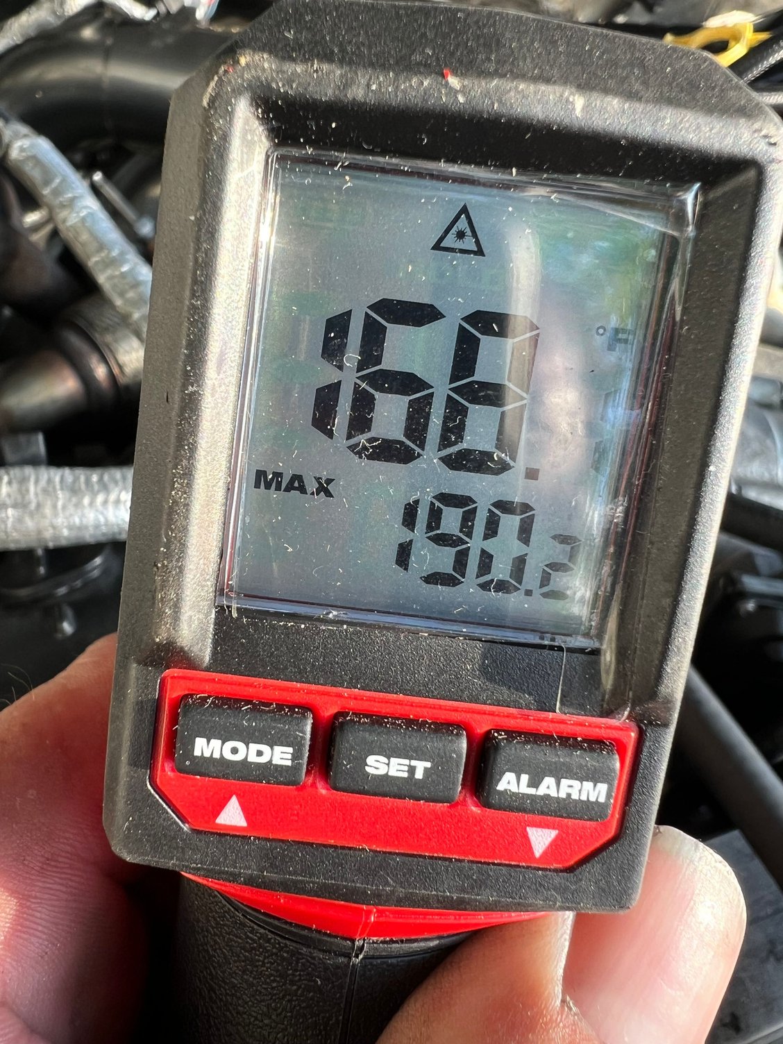

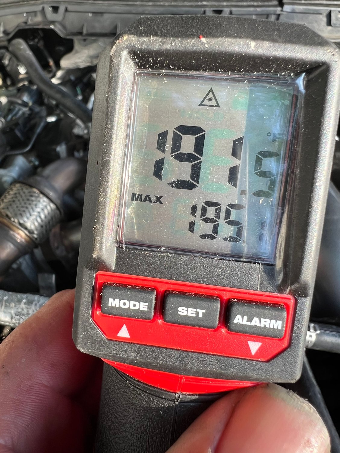

Some heat readings along the piping.
