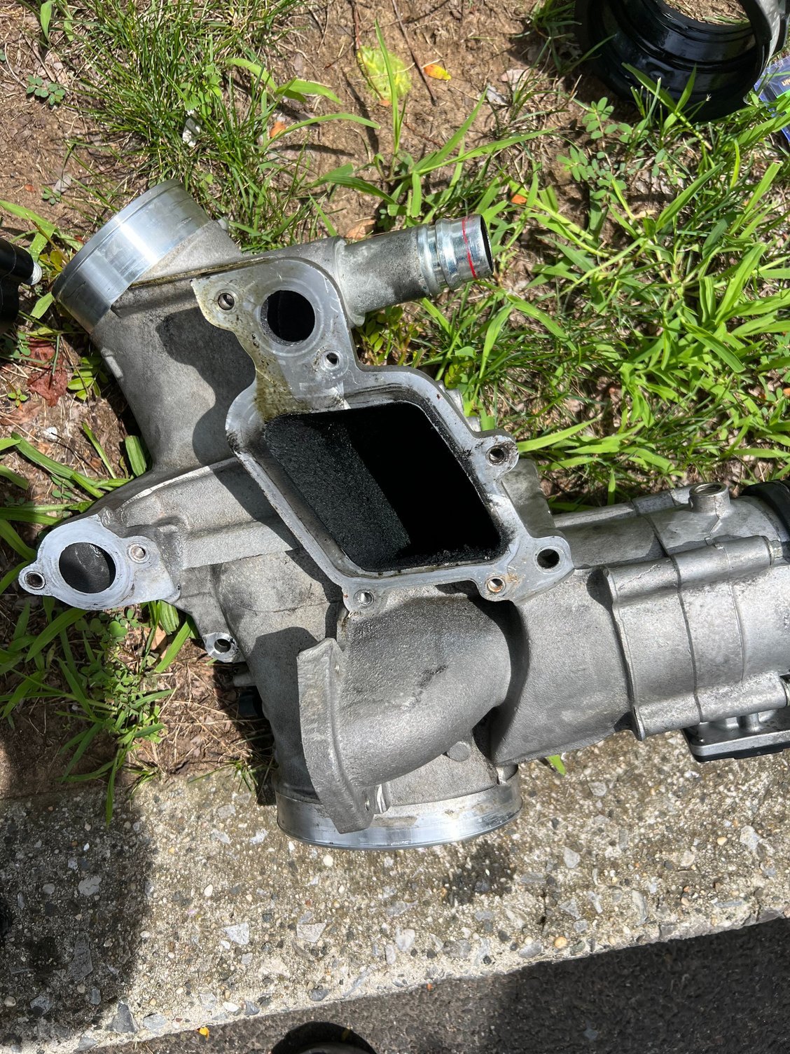

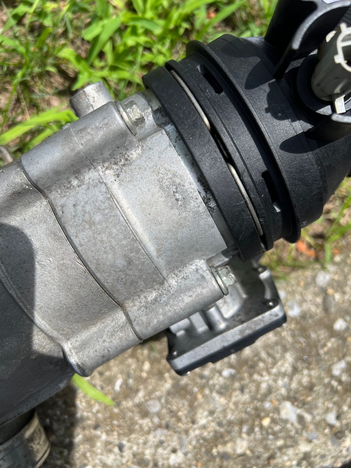

Received yesterday
need a cloudy day or find a nice shade spot.
blazing heat in nyc right now.

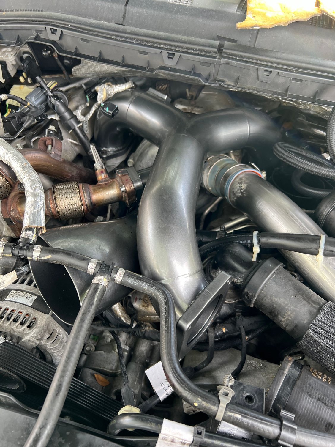

Started at 7:00 am
took about 4.5 hrs to get to this point
Remaining is
flapper valve move from old to new
rubber connection from air filter to new pusher horn
i broke the fitting that feeds the coolant degas line…but it looks like super glue took care of that…I hope.
going for lunch.
May or may not finish today.

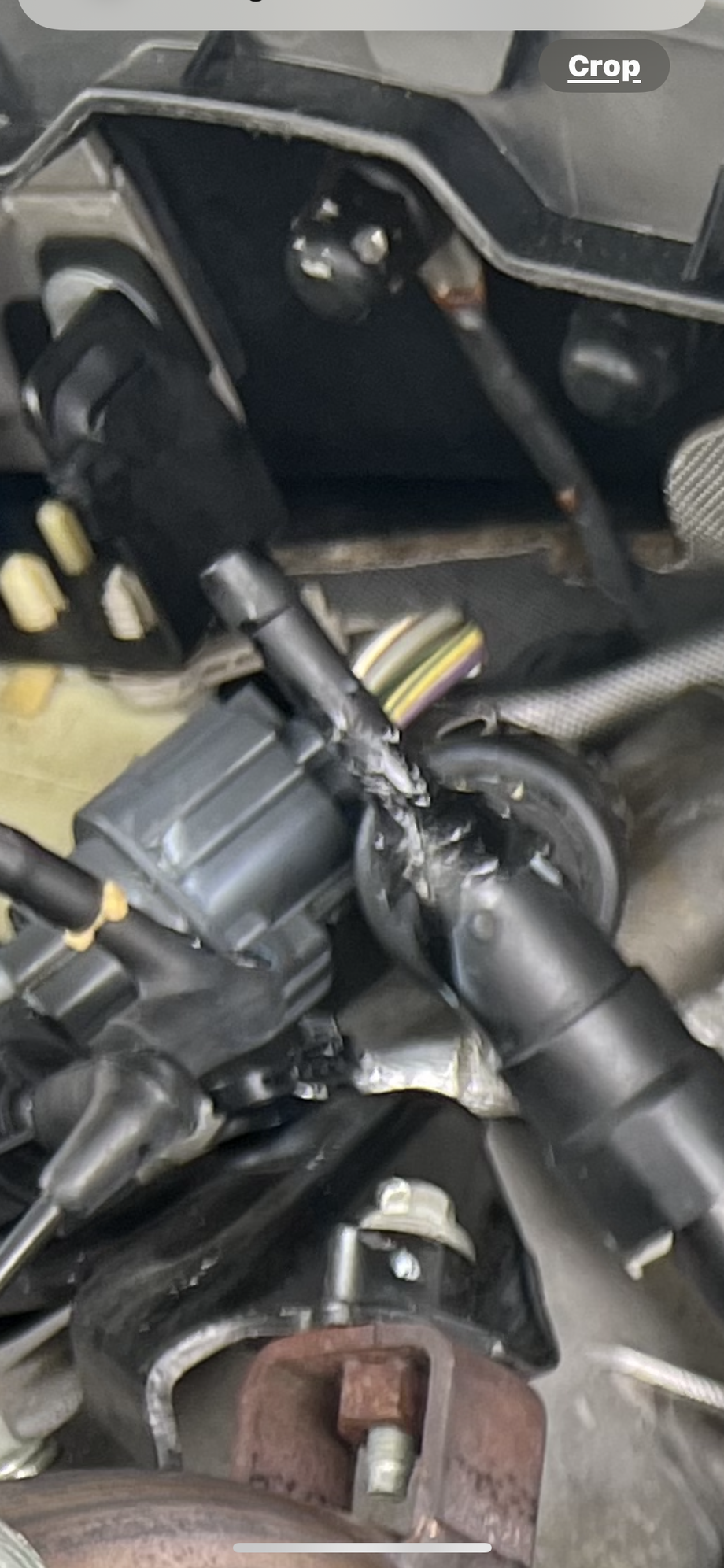

This is the coolant degas fitting the broke. Super gluing it until I order another one.

Sounds more like a diesel and less like a sewing machine.
no more intake noise cancellation for me
