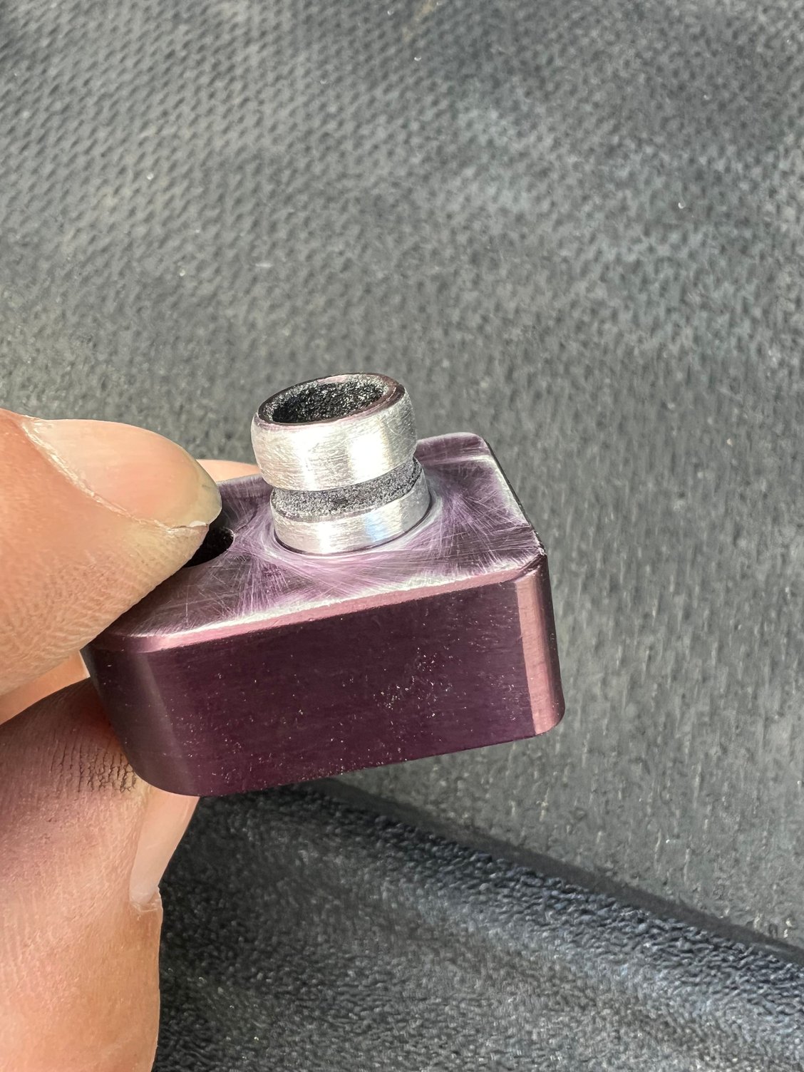

When I did my pusher install the s@b map spacer would not fit in the hole so I did t install it.
but, since installing the pusher intake I have had 2 cels related to map sensor. Both during super long idle times (playing with idash settings).
since the pusher intake is super hot… to get the map spacer back in….had to sand it down for a while, clean it off, then stretch a new undersized heat resistant oring on it. I used the smallest oring I could get on it. The spacer is a tight fit and the oring seals it pretty good. New heat proof oring for the map sensor as well…normal size.

i changed the o rings to the nap and spacer to heat resistant ones . Other than that…I guess I could put an egr blocking plate in and drill a hole in the plate …playing with the hole size to both prevent egr flow errors on one hand and reduce heat on the other…if there is such a thing.
