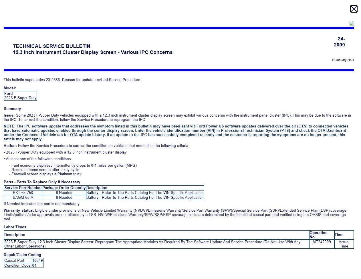

This should solve your problems
Originally Posted by blairlittlejohn3
Can you help me out too with the no compass issue? I've visited several dealers and none of them have any idea how to resolve the problem.
Thanks
If you go through this thread https://www.ford-trucks.com/forums/1...nu-screen.html it has a TSB that will fix your lack of compass issue. It may even give you fixes for things you didn't know was wrong. I had many issues with cluster. I had to bring the truck to 2 dealers 3 visits along with copies of the TSB and almost beg to have them perform the work. I got the compass fixed, the truck stays at the screen I was on when I turned it off, I got screen choices I didn't know were available to me. It was the perfect cure all!
Read through that long involved thread and I am sure you will be happy after the work is preformed.

Thanks LMB (MN) for the tip on the TSB! I printed it out and made a service appointment at my local Ford dealer for next week. Fingers crossed that with the TSB info they'll finally be able to fix the problem that I've been complaining about since the bought the truck.
