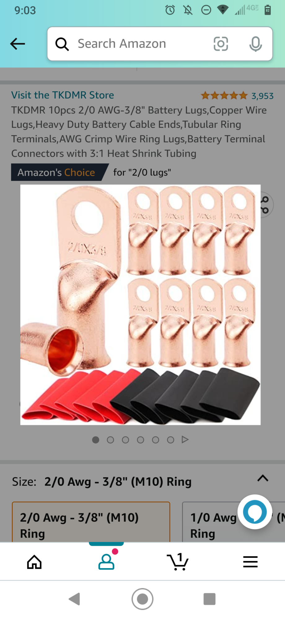

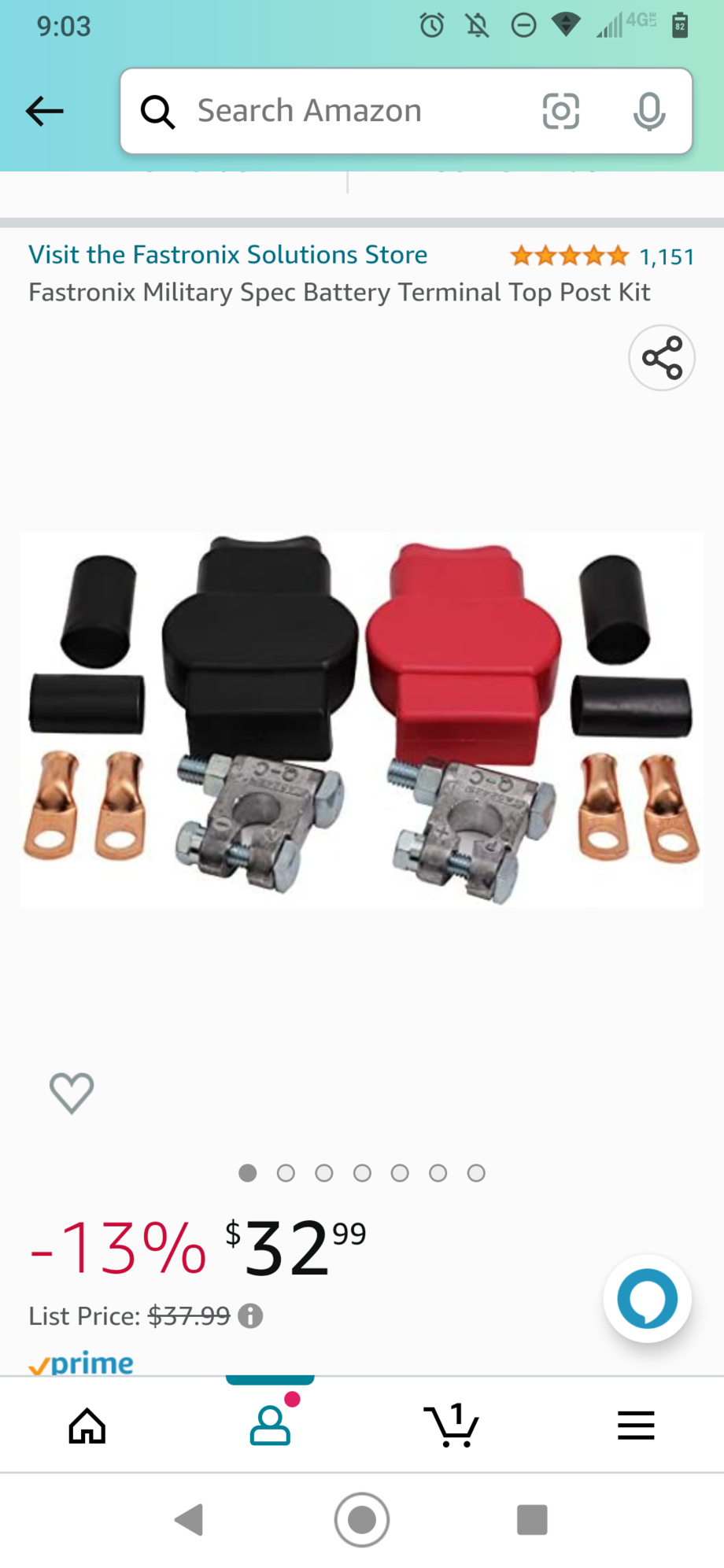

Tristan I bought and installed these last winter. Neighbor had a hammer style crimp tool.
Those are the ones I ordered. I didn't know what size cables were on my truck so I just ordered an assortment of battery cable lugs. I bought a pack of like 280. Half of that is heat shrink but, I do a lot of work with battery cables and seem to always need cable lugs so I figured I'd go ahead and get a big pack.
Here are the crimping tool and lugs I ordered.
Battery Cable Lug Crimping Tools with Wire Cutter-haisstronica Wire Crimper Tools-AWG 10 8 6 4 2 1-Battery Terminal Crimper for Heavy Duty Wire Lugs,Battery Terminal,Copper Lugs Terminal (RED) https://a.co/d/9q7i1jE
280Pcs Copper Wire Lugs, 70Pcs AWG 2 4 6 8 10 12 Battery Cable Lugs Battery Cable Ends Ring Terminals Connectors with 80pcs Heat Shrink Tubing https://a.co/d/gXnBaxR
This kit probably doesn't have big enough lugs for my cables but, I will use them for something. They were cheap anyway.
