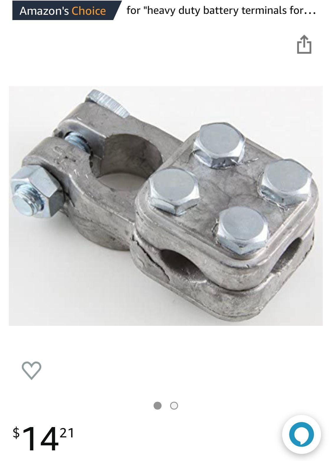

This is the style I used back in the day. I’m sure it was the “best” of what was in stock at the store and recommended by the parts guy. I’m not saying to use this one, just showing this option. It is a lot better than the 2 bolt style in your photo.
2-4/0 Ga. No-Crimp Three-Way Positive Lead Battery Terminals (1 per pack) https://a.co/d/4Zrcxsc
That is a lot better than what I have currently. I think I'm going to order a set of those military ones from Amazon. I might have to buy longer bolts but I like those a lot. And it comes with lugs, and heat shrink and, new terminal covers. Pretty good deal too. I appreciate your help! I'm hoping my truck is going to crank it in the morning!

None taken sir and as Jason said, you are in your way to fixing it. Those terminals and wires are quite bad..
