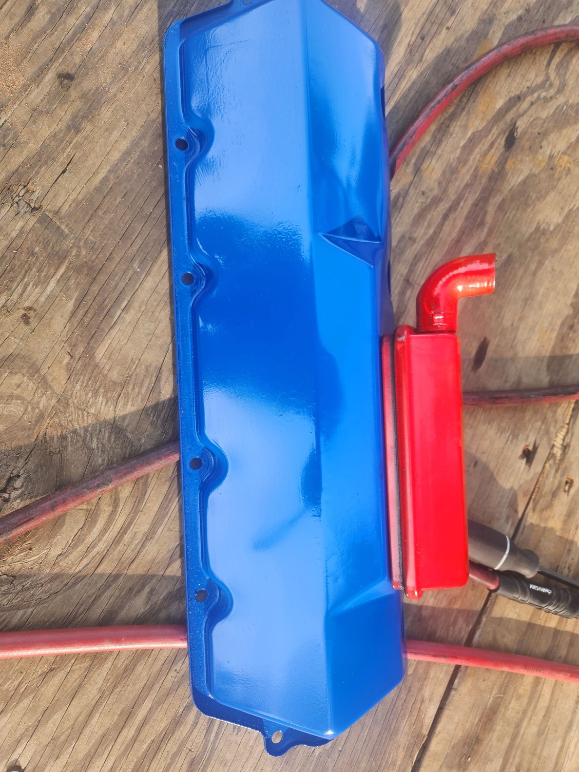

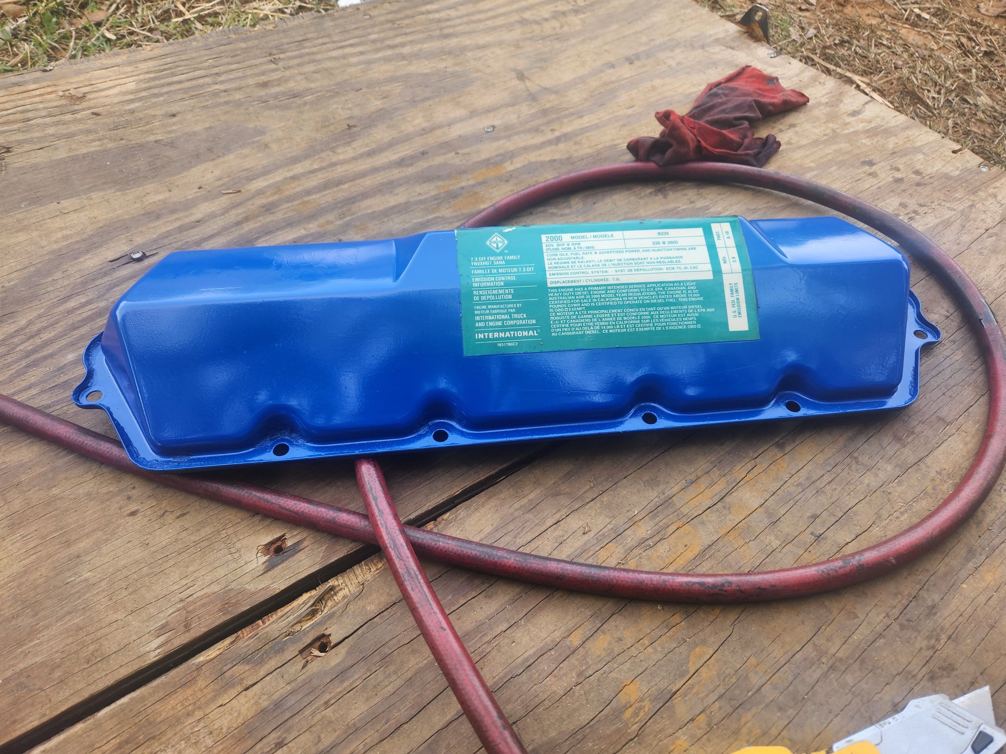

Well, sure enough, put my glow plugs back in and started plugging in the glow plug connectors and, the wires are already starting to split and crack. I think it's been a year maybe a little bit more since I put this dorman gasket on. And now I'm going to have to replace it. Fortunately I do not have the parts or time right now so I'm going to have to put it back together for now and order me a new motorcraft OEM harness and gasket. Luckily it's on the driver side so it's the easy valve cover to take off not that the passenger side is much harder.

Old Nov 20, 2022 | 01:36 PM

Old Nov 20, 2022 | 02:38 PM
