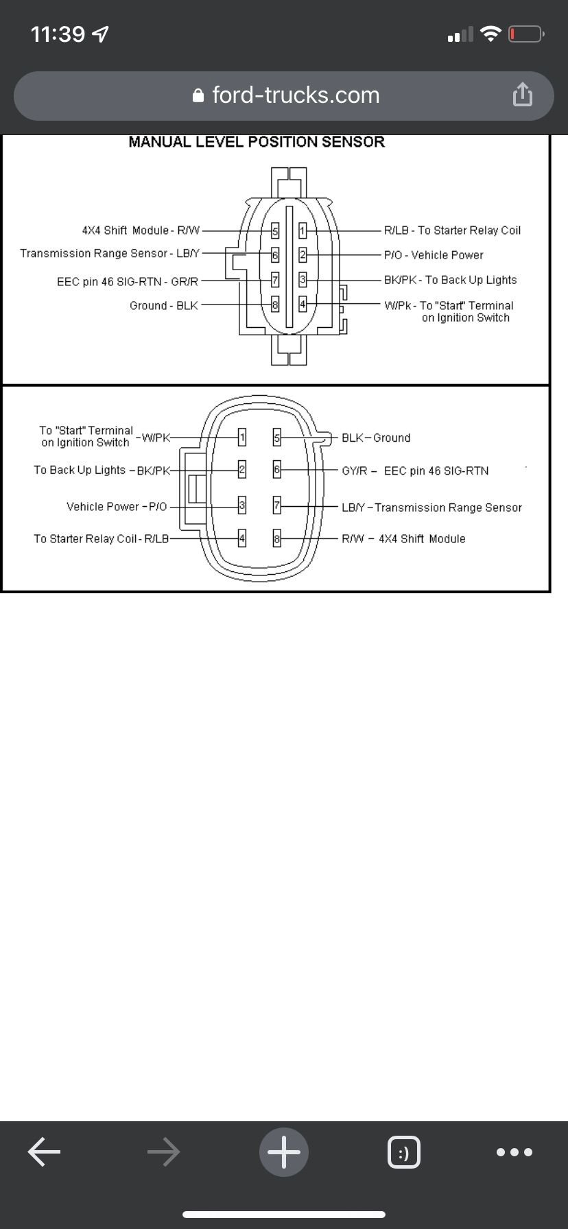

what’s confusing me is the new only starts in neutral problem. It started in park fine before repinning. I am going to try repinning the plug and see if I did it backwards (looking at the plug from the back versus the front. In this diagram, it should be from the face of the plug correct?
That is looking at the pins on the connector. The wires would be on the other side. Wouldn’t hurt to double check to make sure they are in the right place and that they are fully seated.
Not starting in PARK sounds like the MLPS. Did you line up the marks on the MLPS when you installed it? You should be able to find a picture showing the resistance readings for each gear position. That will help verify you have it set right.

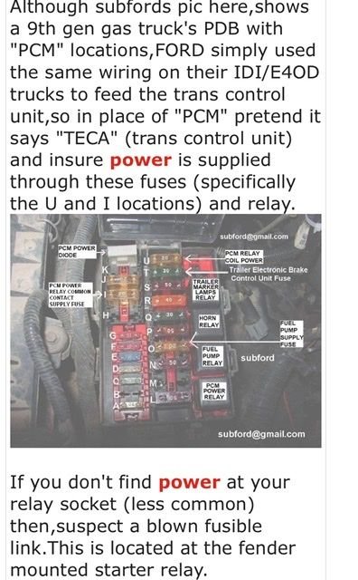

I read a thread in the full size van forum where Mark said that power to the OD cancel switch comes from fuse 20 on the interior fuse panel. Keep in mind that it might be a different fuse on your truck. Hopefully someone can post wiring diagrams for your truck. You will have to be more proficient at using the DVOM to find the problem. Unfortunately you might have introduced more problems by doing the shift kit.
🤣 sorry I was also, just saying I’m not in a position to be swapping trans atm. Thankyou for the guidance here. I’m going to test continuity in the relay today, and finish requiring harness. I’ll update soon. Thanks everyone.
