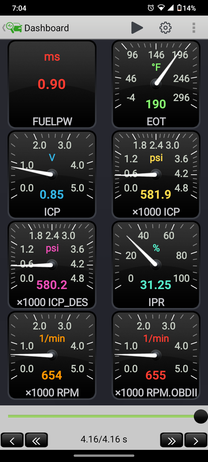

I'm not sure if the IPR valves are different on an 04, but your hot IPR% looks very high. My 05 & 06 would both run around 24% at hot idle (maintaining 580psi ICP). You are running 31% so something is definitely wrong. Likely a HP oil leak somewhere. Being an 04 you've also got the potential for the HPOP to be having issues, I don't recall the exact symptoms you'll see but I know they are known to go bad around 100k so it might be time.
Since it's simple, I would first try swapping back to your original ICP sensor and see if the hot IPR% changes. If not you need to air test and find the leak.

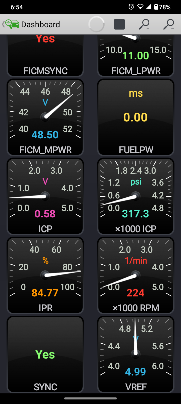

So a little update, after air testing again a while back found that the J-tube was leaking as well. Got that replaced this past weekend and finished mounting the turbo and everything else last night. It fired up on the second try, IPR is still sitting at 30% while hot idle. Well it still will not start while hot. IPR jumps right to 84, no slow build. Possible air still in the system? Bad IPR? ICP sensor reading not right because it is not OEM? or my fear a bad HPOP. But if it was a bad HPOP would it even start? ICP and ICP desired are always real close while running, wouldn't desired be higher than actual? Tried it again this morning and it fired up right away, no long crank or anything. Tried it 3 times and fired right away. Let it idle while I took my daughter to school EOT was at 177F and ECT was at 182F. Tried to start it again and crank no start and that's when IPR jumped right to 84. Man I am frustrated right now!
