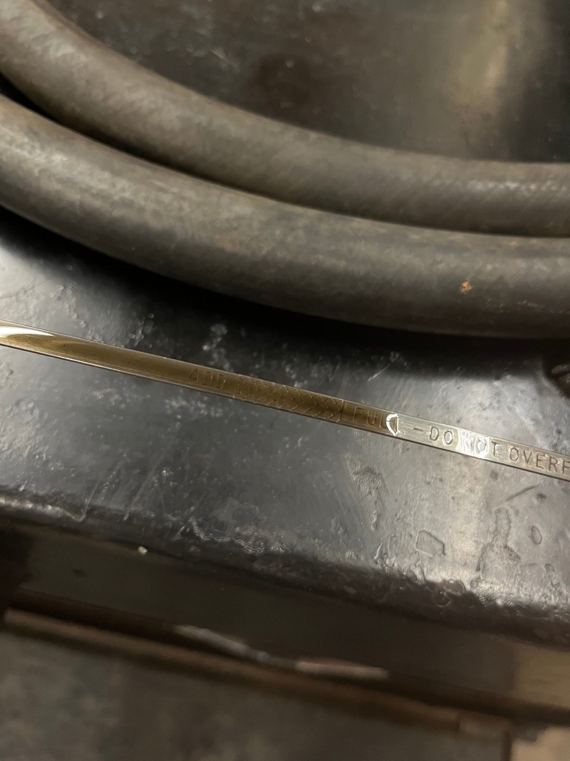

Thanks farmer, have and photos of the 96 c&c?
When I changed oil about 100 miles ago, I had it about 3/16 below the full mark.
Checked it about 50 miles later and
Another 50ish miles and
Old Feb 5, 2023 | 01:28 PM

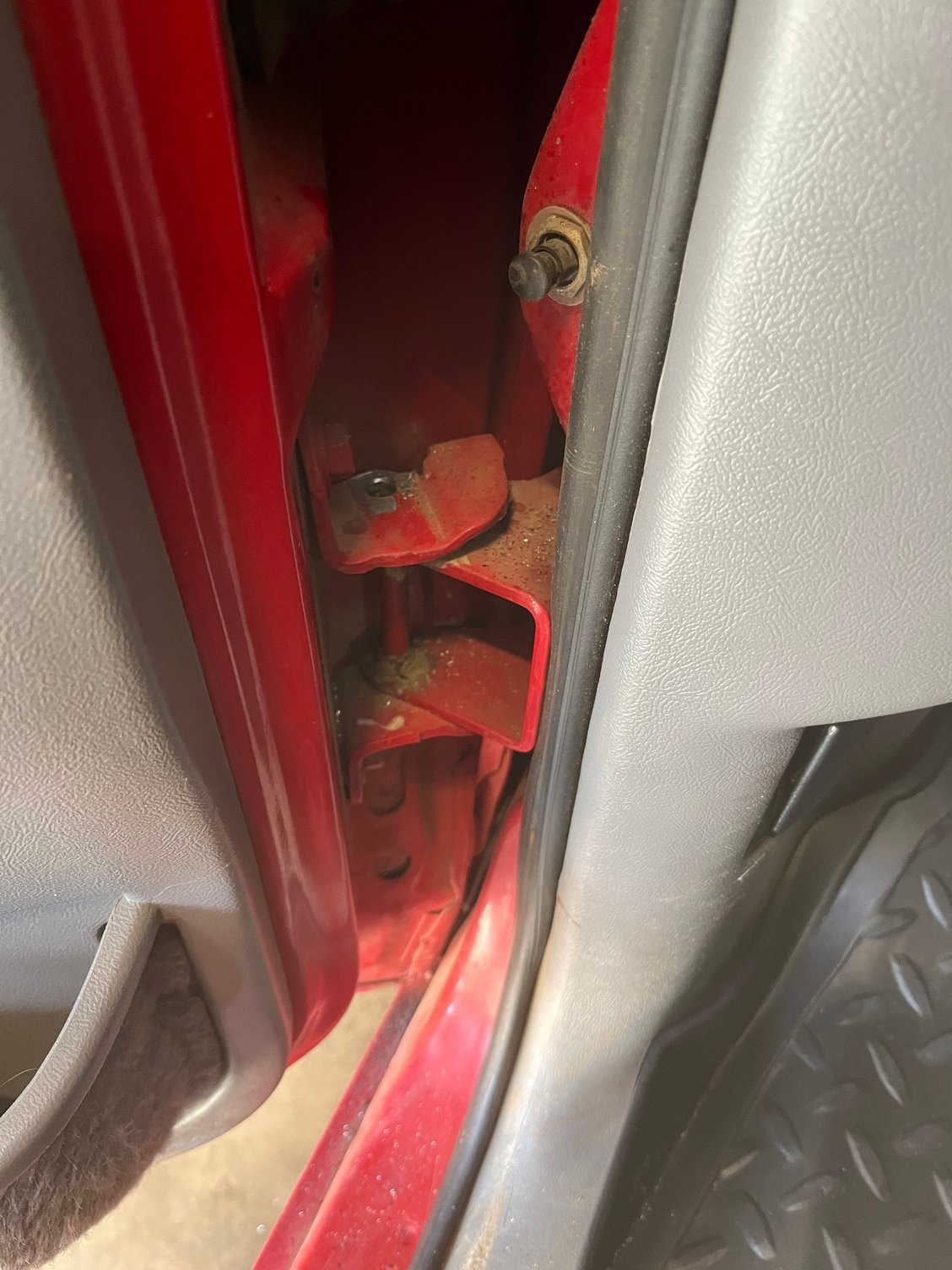

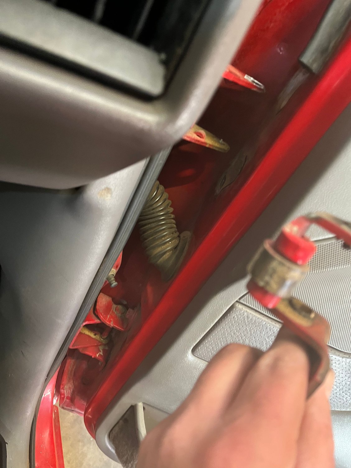

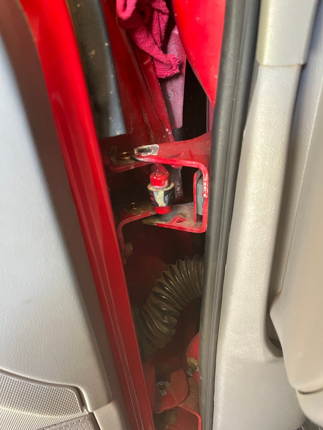

Got door pins and bushings installed changed out the strikers also. The plastic bushing on the strikers ended up being slightly to large and causing the door to stick.
I milled this down in a highly technical process using a pair of needle nose and a flap disc.
The passenger side only needed the upper pin and bushing.
The doors shut like they should now, crisp.
Pass side
Driver
Driver

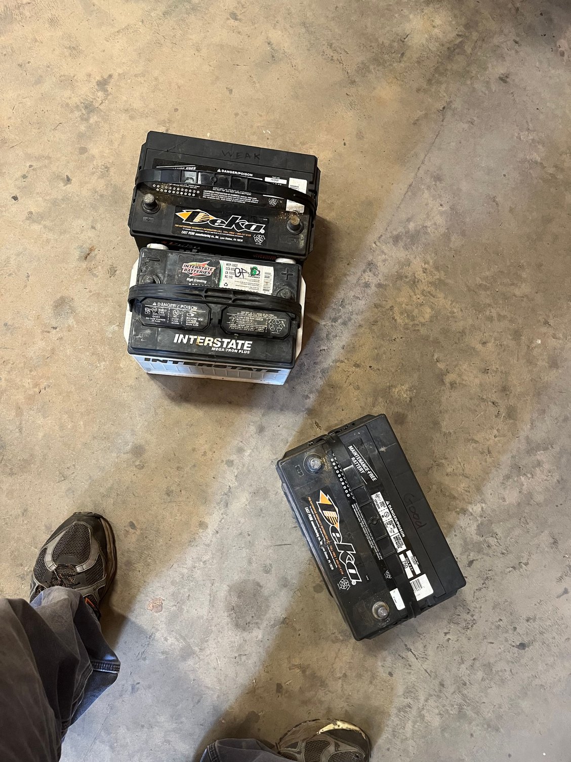

Looking forward to feeding the 6.7 Starter properly. One of these batteries load tested good and it’s sitting at 13.2 V the other one is bad and below 12v so keeping the good one as a spare for the shop. My old shop battery is going as the other core.
