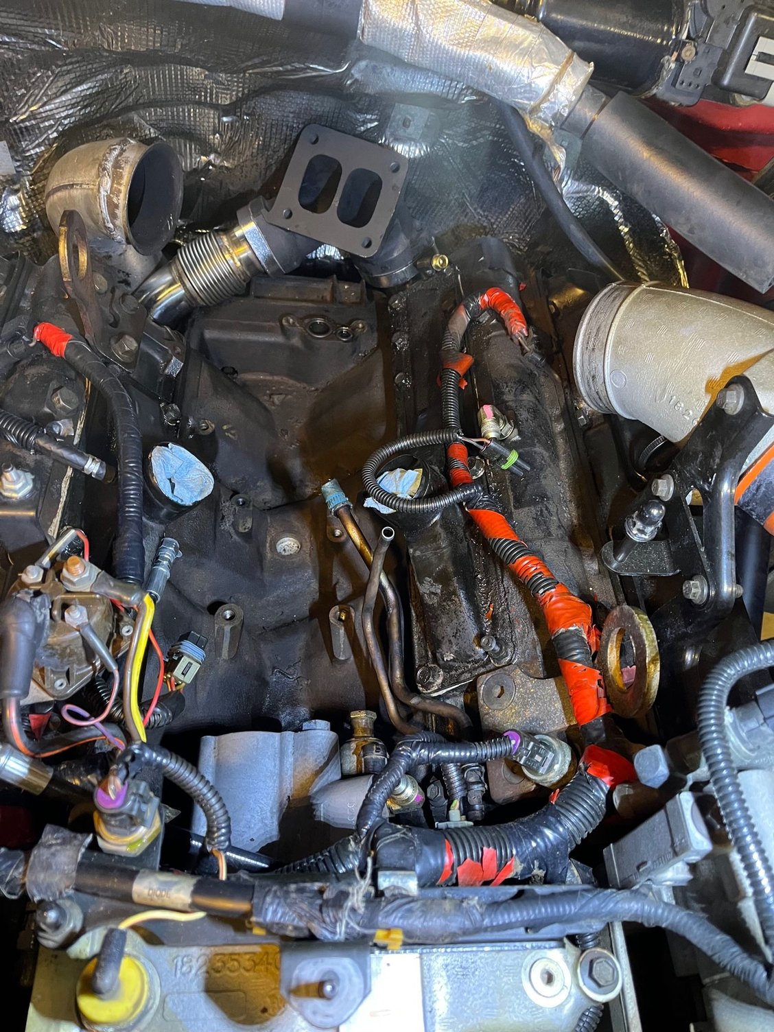

Found a couple hrs to work on it sunday.
BIL gave me a hand with the up pipes, Man that really helped. Took us about 30 minutes.
Next stuck new o-rings on the new to me ipr, thanks again @Tpayne621
Cleaned mating surfaces and put on the 17* hpop with obs fittings installed.
Stuck on the motorcraft hpop hoses and called it a day to spend time with kiddos.
Hoping this weekend to get turbo rebuilt and e-fuel on, I need this truck back up and running.

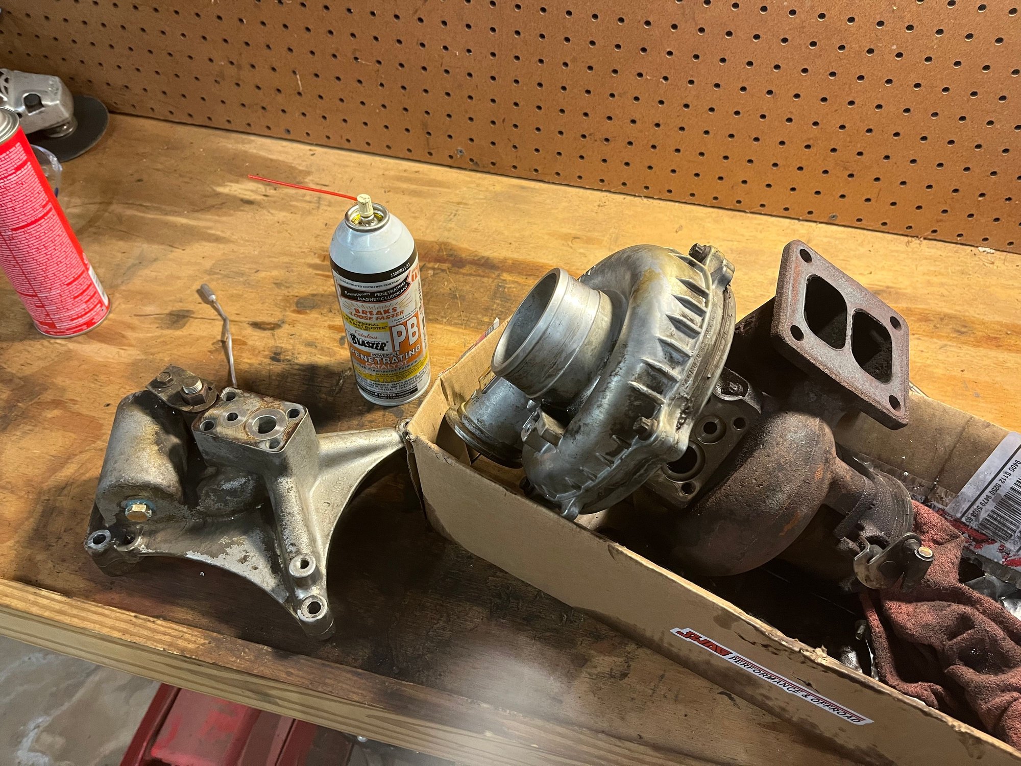

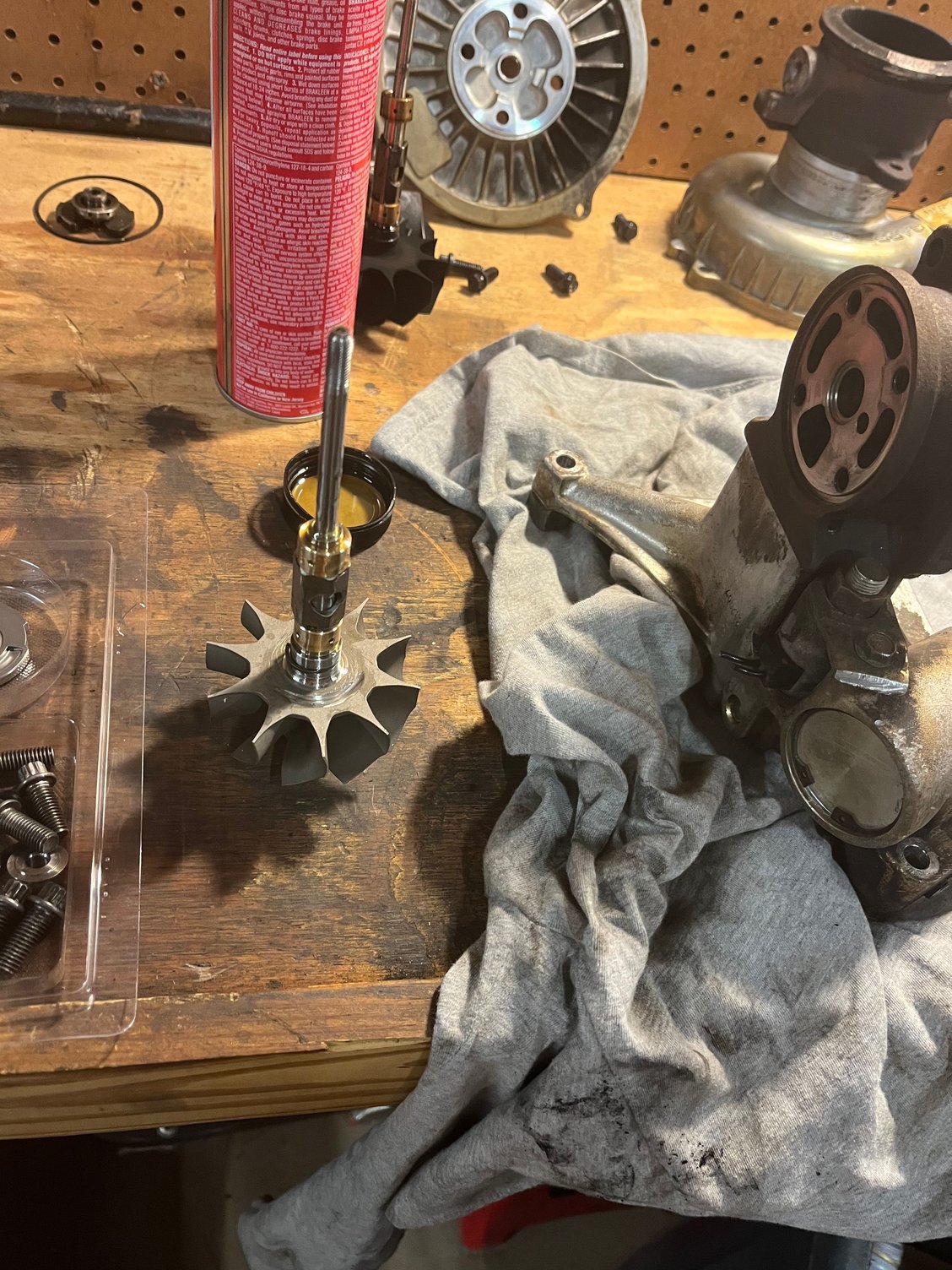

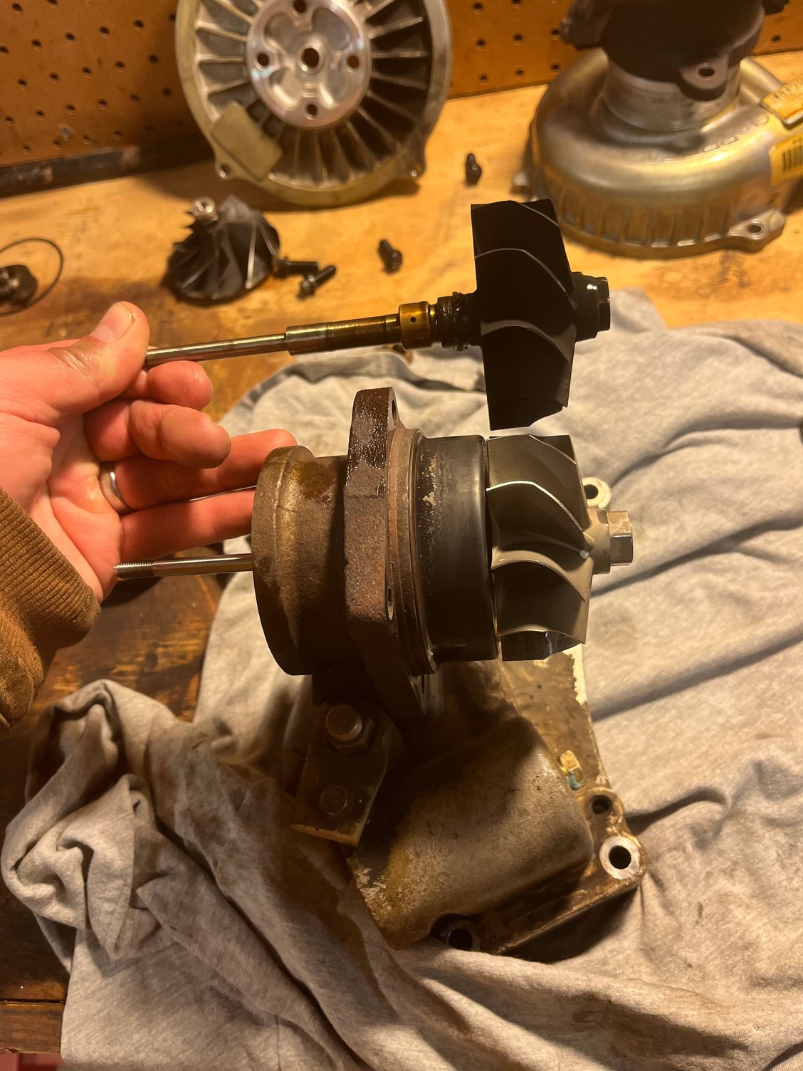

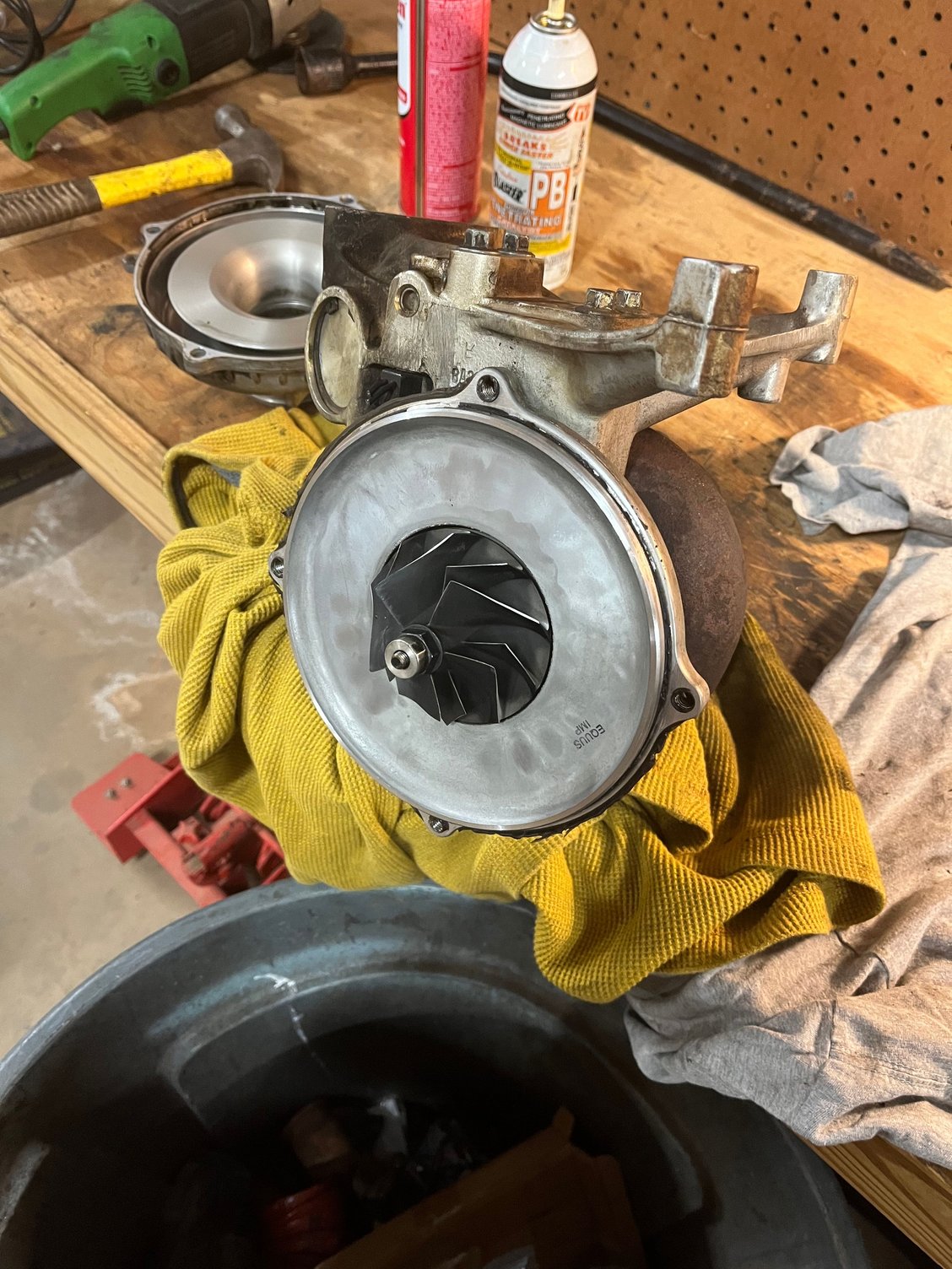

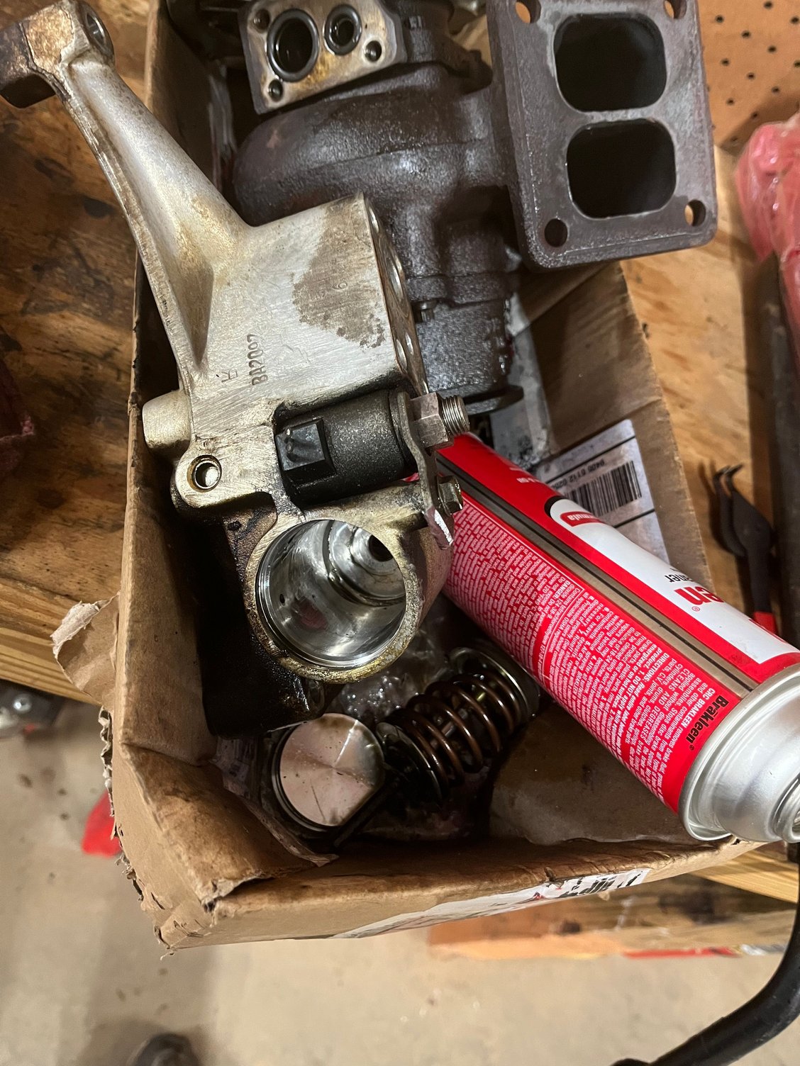

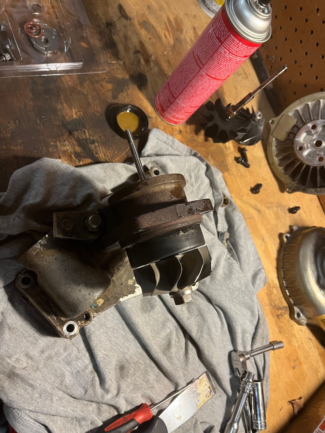

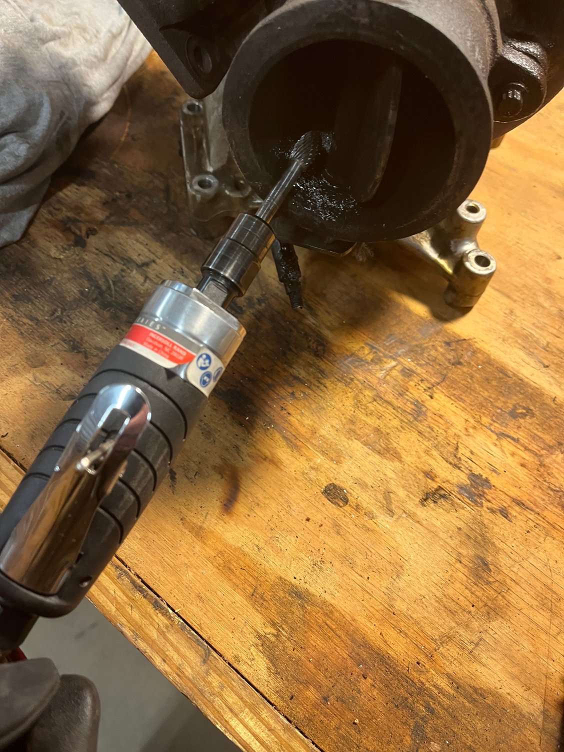

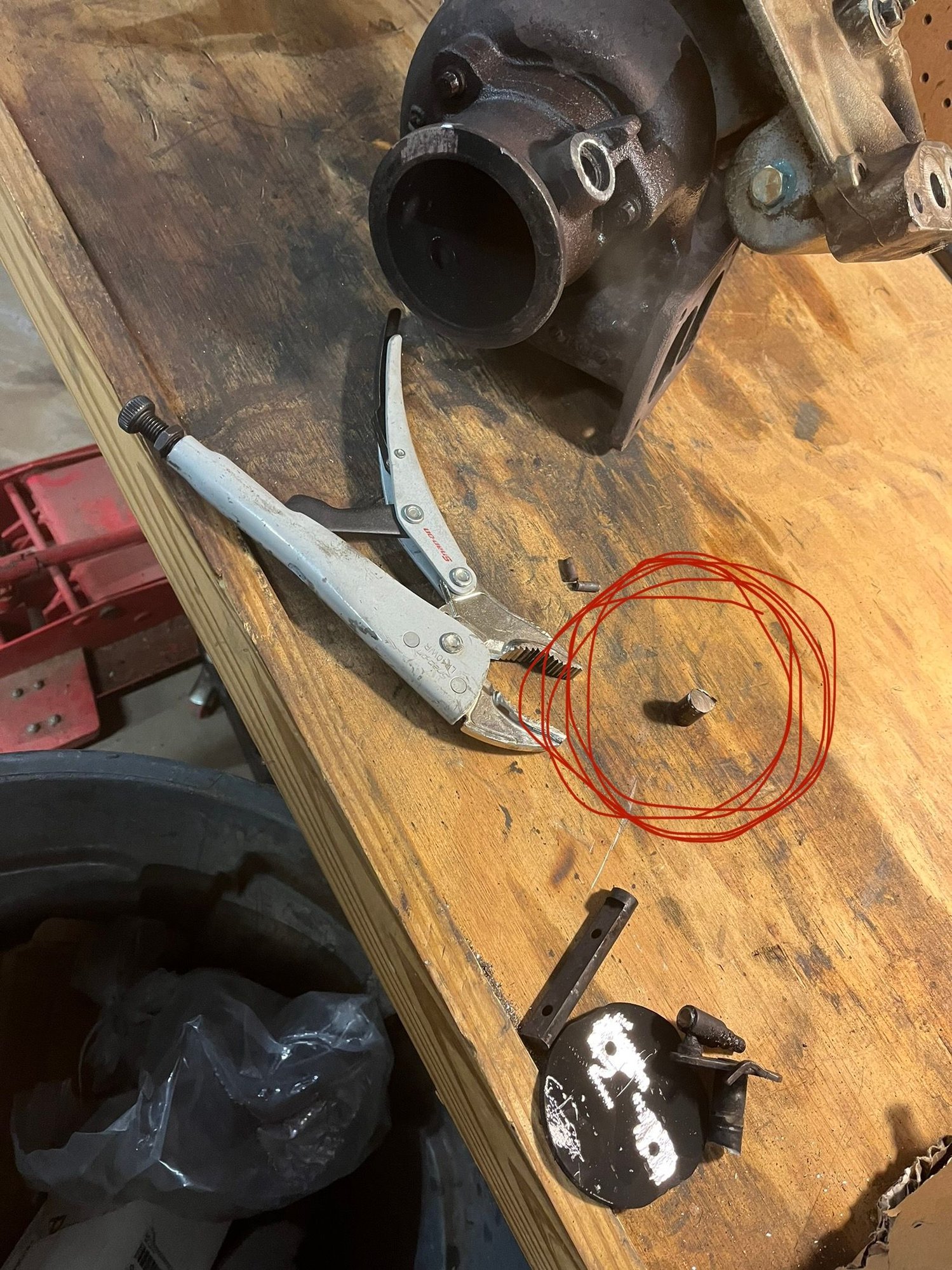

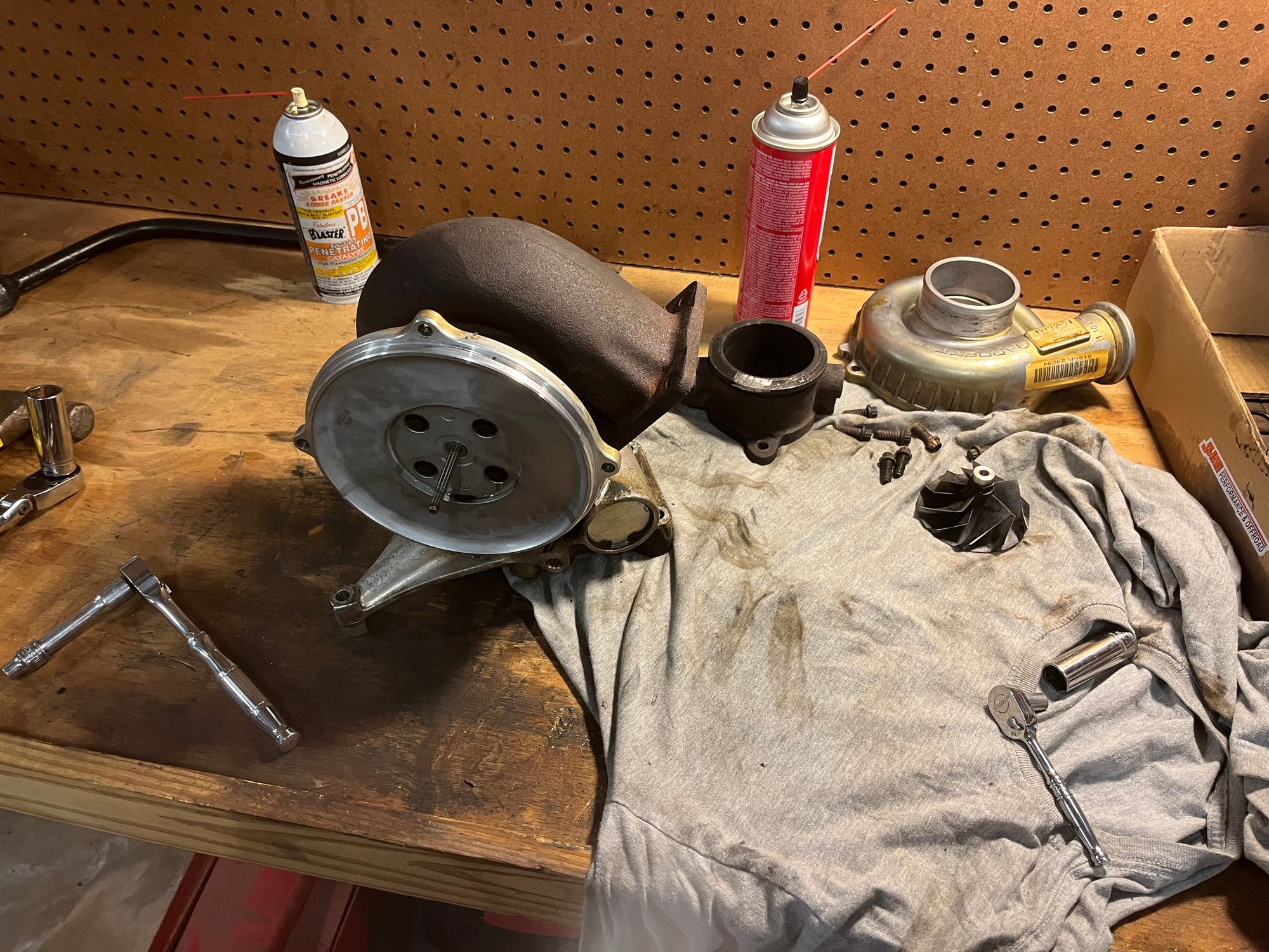

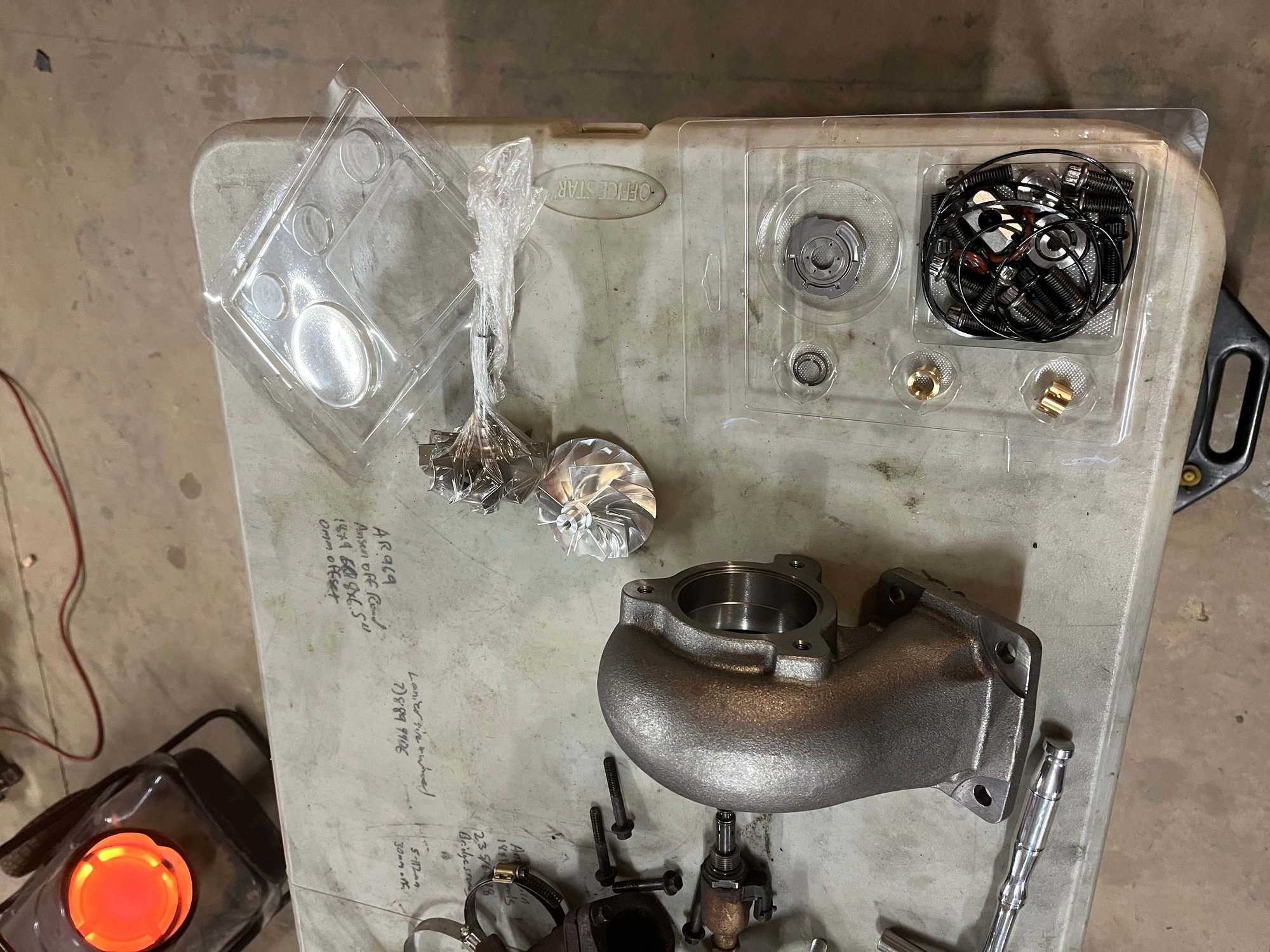

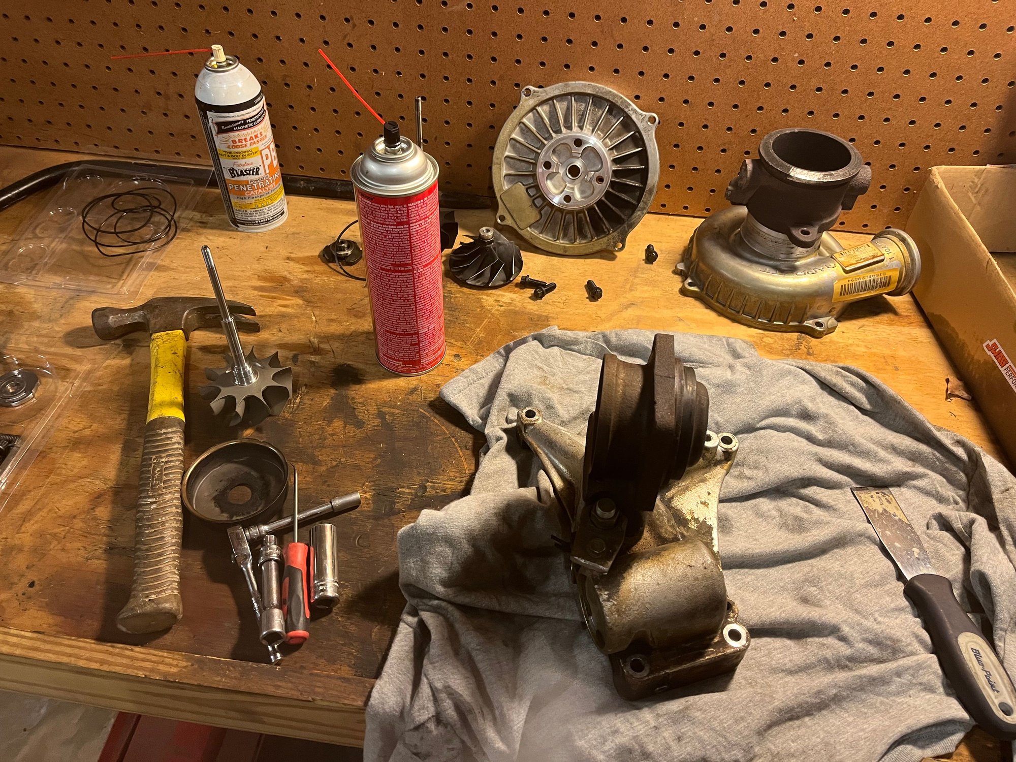

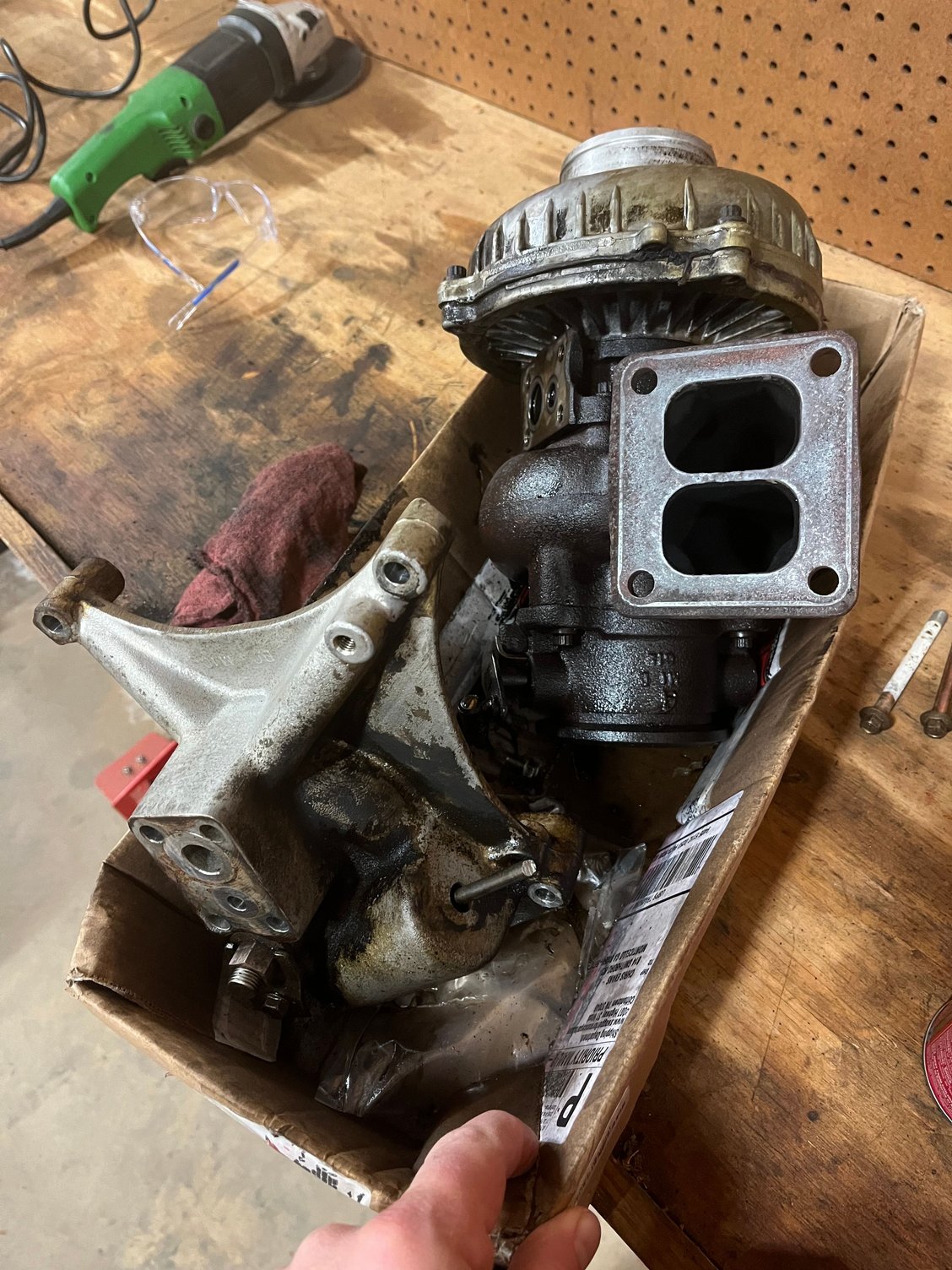

Took a few hrs and got some stuff done.
fan was stuck in diesel torpedo heater but got it freed up and working and got started. Kept it about 40-45 i would run about 20 min and cut off about 20.
got everything dissassembled and cleaned.
turbo has been apart before from what i can tell….friggin compressor housing was sealed with rtv, what a pita mess.

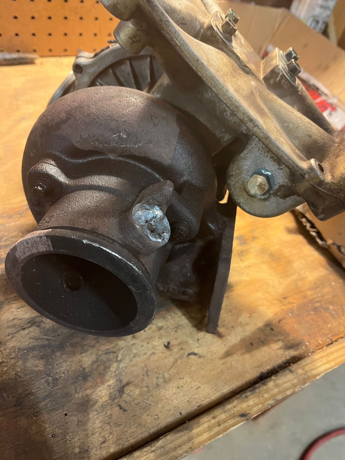

Diy ebpv delete
Die grinder to grind rivets.
1.0 housing and ebay turbine/conpressor and rebuild. Pissed at myself for trying to be cheap on the wrong part. More on that later
Cut that off shaft to plug hole and weld up
Friggin silicone all in the oring groove🤮
Clean
Rear seal was weeping pretty good , heat shield had alot of soot/oil buildup…
Going back together, noticed wheel looks same as stock
Decided to stop at this point and order kc turbine wheel
Ebay turbine same as stock….. shane on me for trying to be cheap .

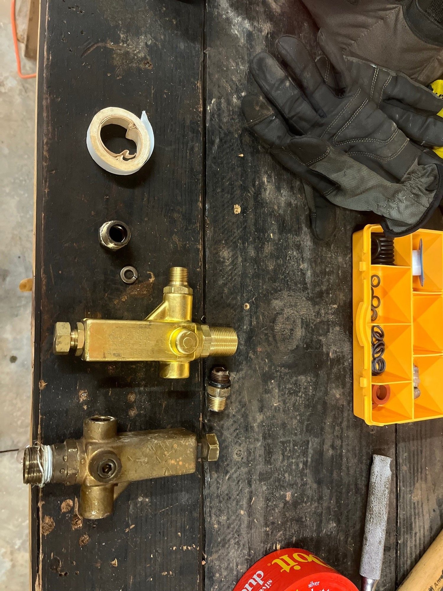

I did not re-do rear brakes. Once I opened them up looking for the gear oil leak, i found them to be nearly new condition and moved on. The right rear adjuster was difficult to turn so i pulled it apart and cleaned/lubed it.
Thats a great catch on the rear brake shoes, I didn't pay much attention to them, but looking back at the pictures I can see it clear as day. Damn it, I hate doing drum brakes...added to the list
I've got new brake hoses sitting in boxes on the bed, looking forward to flushing brakes. Since I blew a brake hose in a 65 Chevy at 15 yrs old and ran thru a fence & hit tree I've developed a tendency to overdo it with brake systems.
I got the pressure washer fixed BTW with new unloader valve.
I dont know the proper name for it, scroll up to the picture of the new turbo parts, see the glowing round metal cylinder in the background? Thats what I'm referring to.
Only benefit to piecing the turbo together is cost, spending less than $500 on rebuild / parts vs a little over a thousand for a stock plus KC turbo.
