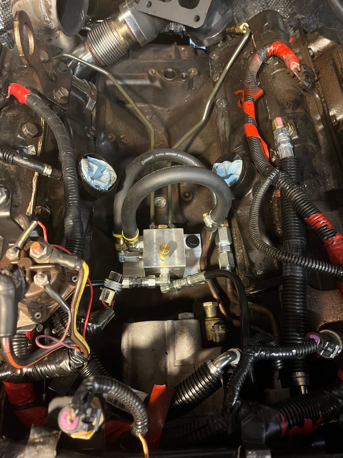

Got her buttoned up. Was able to find a few hrs to work on her today. All that's left is the pump/filter assembly and wiring(including ipr harness reduction) till I can take her for test drive and bring over to my house to finish the little things a bit at a time. Left the turbo intake boot off to verify turbo spins upon startup. Chinese up pipes took a little persuading to get lower t4 flange bolts started but got er done. Slowly worked up pipes snug, then tight and appear to be sealed.
Went ahead and tapped the y for boost and stuck a random 1/8” shrader valve to plug the hole until i install the gauges.
Stupid allen heads

Is that drivers side plenum clamp low enough?

I didnt get them perfect but close.
i dry fit the y before i installed boots and the y sits flush on top of the plenum inserts. The boots are a little on the long side i guess i could trim them a bit
So the clamps are good i may space them apart a bit after looking at pictures?

I was just concerned it might be partially above the plenum pipe. But if it’s good then send it!
