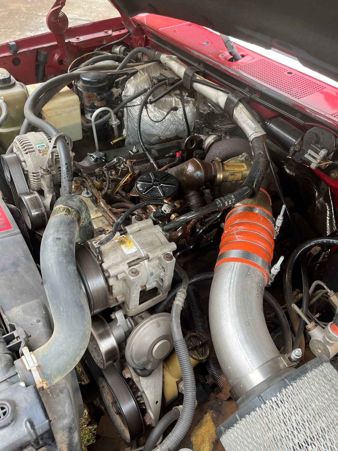

Parts starting to trickle in. Plan to swap this in today, pull front tires off and check out the situation with front bearings/brakes etc.
Rear leak was an axle shaft seal, wheel seals looked good. got it cleaned up, replaced the oring and left off centercap to monitor for leaks.

I just noticed the parts pile, looks like my 4.9 inside. You will love a high power starter in these rigs. I have a real deal Denso and spin over crazy fast

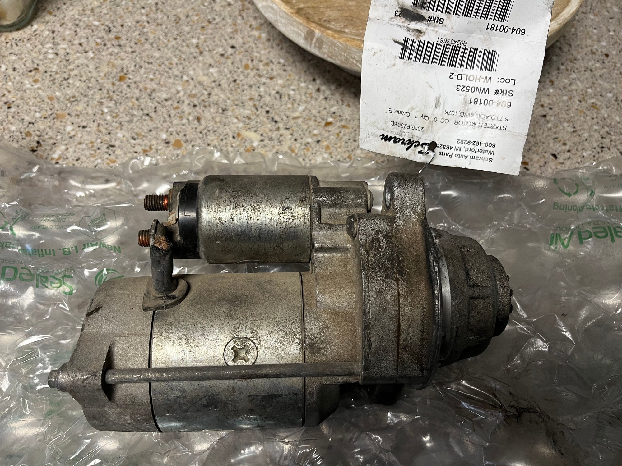

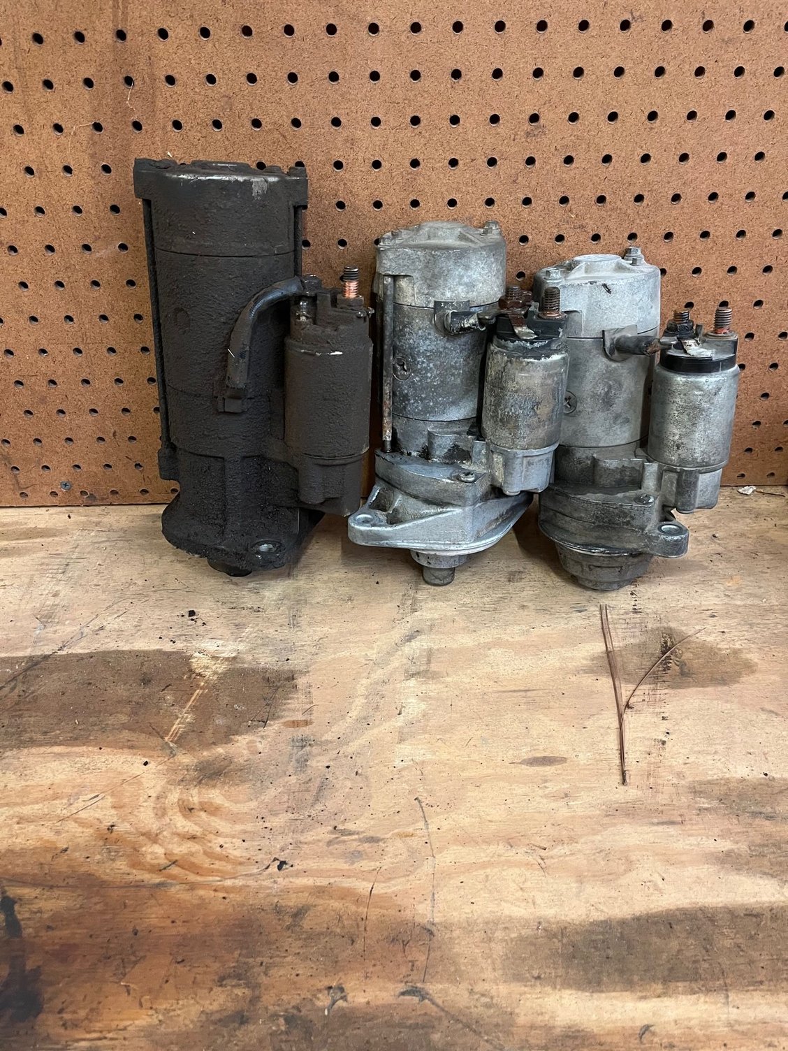

Ive got a denso in my 2001 and have loved it. its almost 3 yrs old now. Decided to try 6.7 route since i had the stock starter off the 01' to donate it's nosecone.

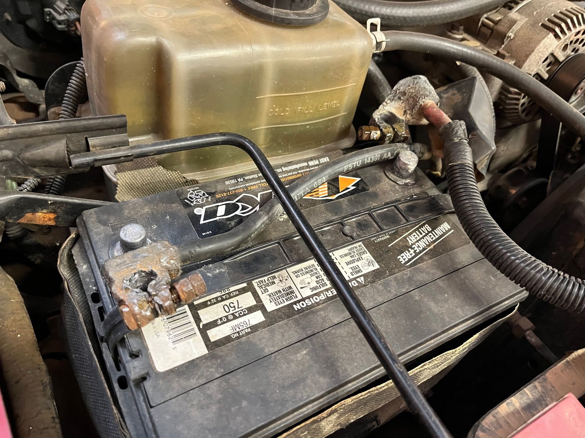

Unf-ckd & cleaned the battery cables and got them properly pushed down/spread out on the posts. Batteries are 4-5 yrs old but starter still made a nice improvement.

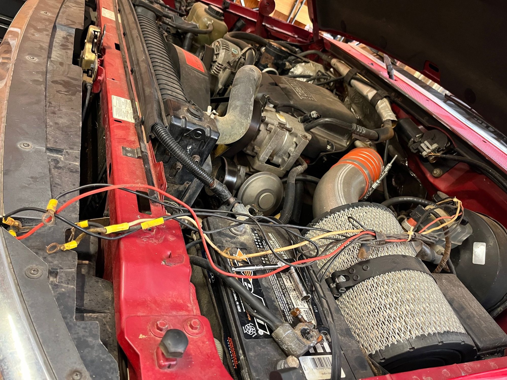

Getting rid of this mess, it feeds the trailer brake controller, 7 pin at gooseneck and 7 pin at the rear. I dont care its a rats nest at the rear of the truck too and its all going to go front to back.
left to right - original starter, 01' 7.3 starter, 100k mile 6.7 starter
7.3 starter and parts on the left, 6.7 on the right. swapped the nose cones like the tech writeup in the 99-03 forum. I was able to get the 6.7 starter separated without pulling the armature out of the brushes so I was happy.

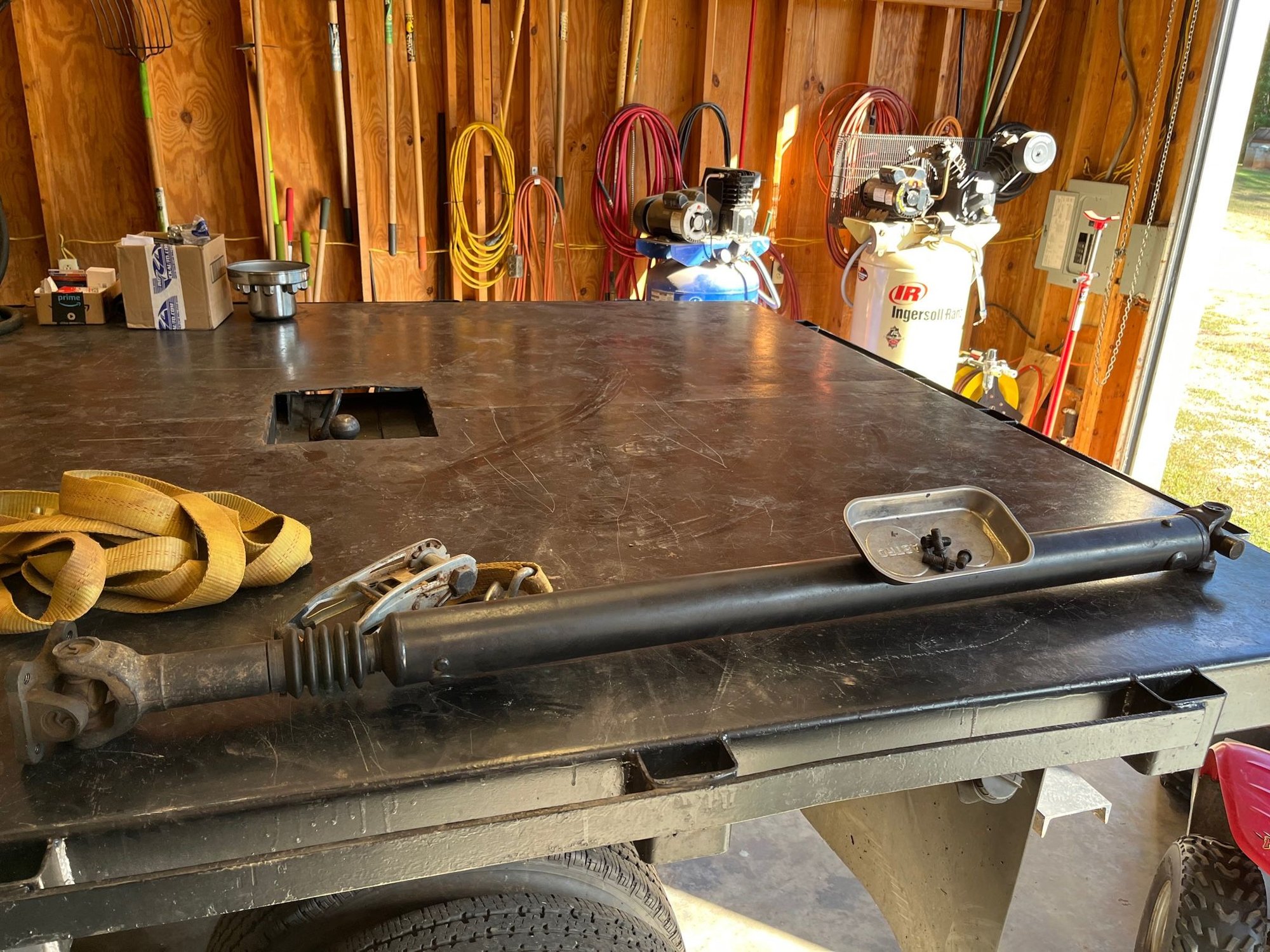

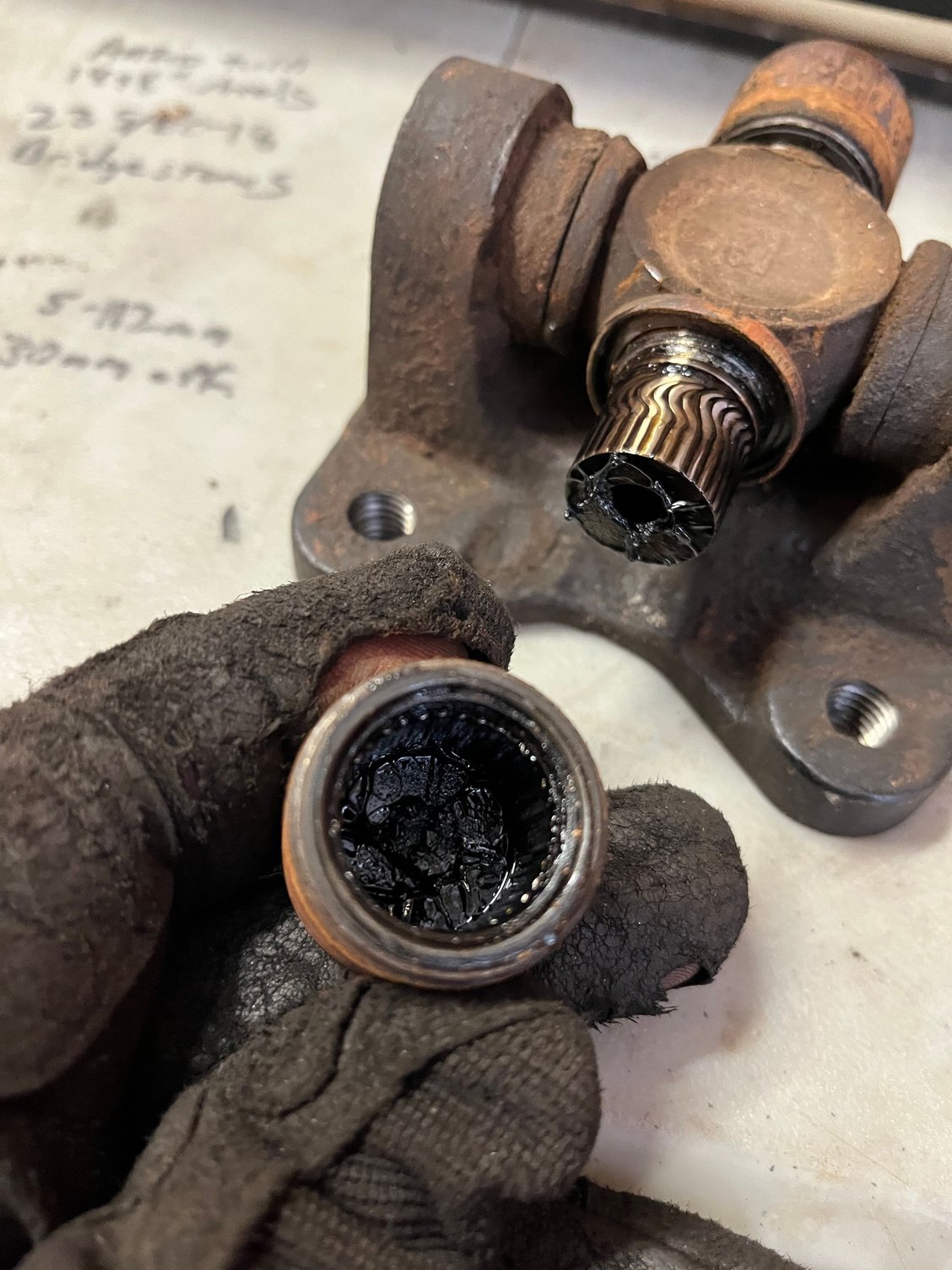

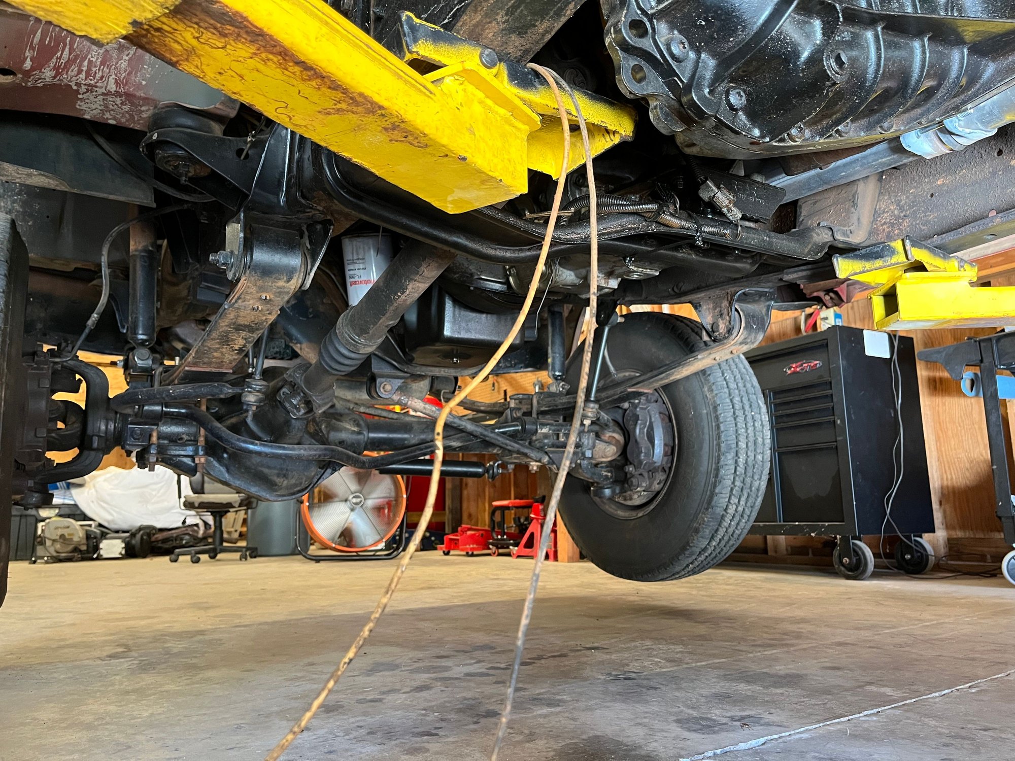

Went ahead and yanked the rear driveshaft before called it a day. Someone replaced the rear ujoint with a non greasable cheap parts store junk joint. Its grease has already about turned to liquid and it has stiff spots. Going to replace both with 1350 spicer life series joints.

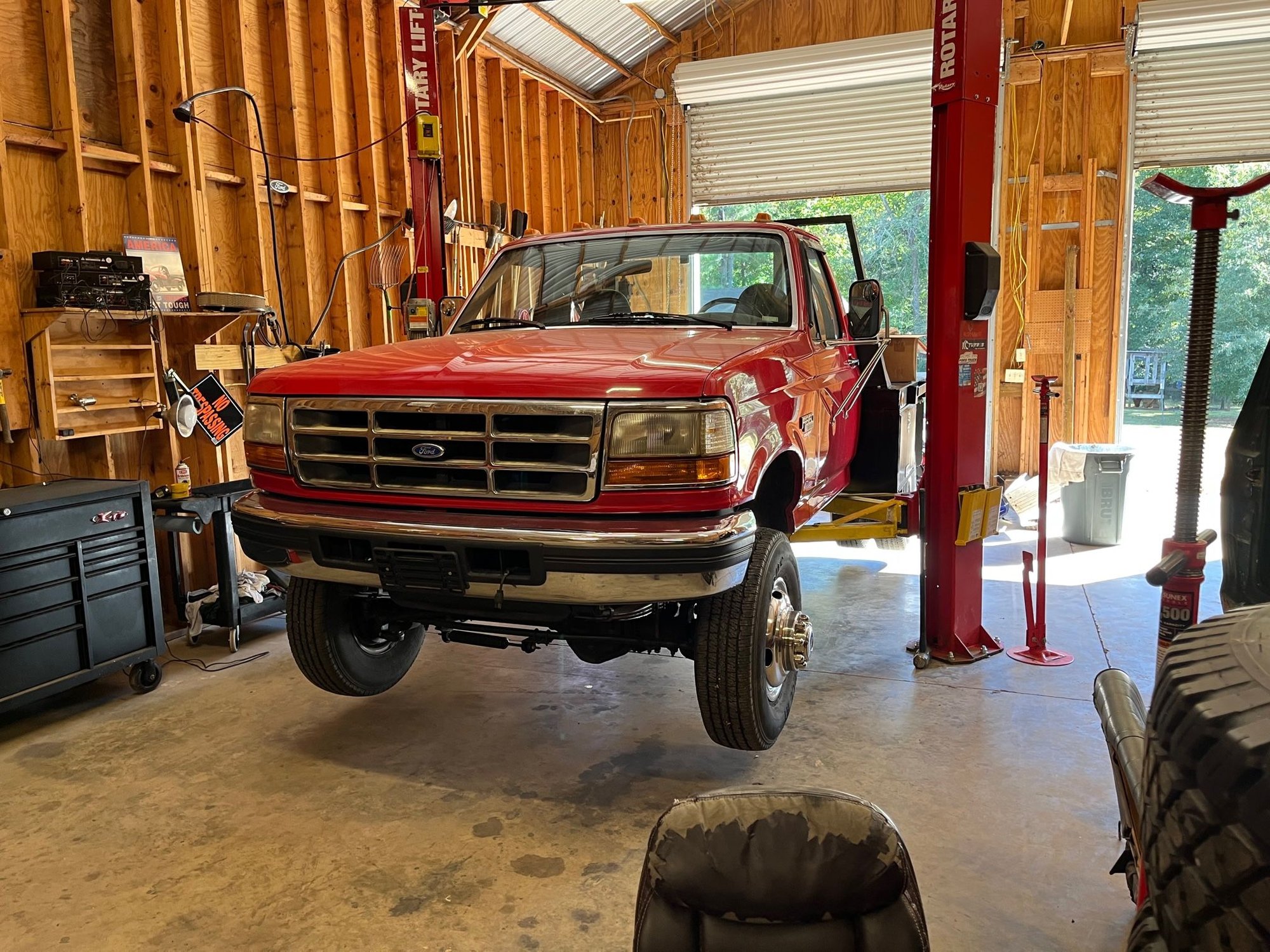

For some reason I'm nervous about raising this thing up on the lift. I think its the weight of the bed/100 gallon fuel tank. I estimate it about 8-8500. My lift is 10k and my 01 weighs about 8k, and i had my 9,000 2017 f350 on it many times I'm just overly cautious because the balance point is different..

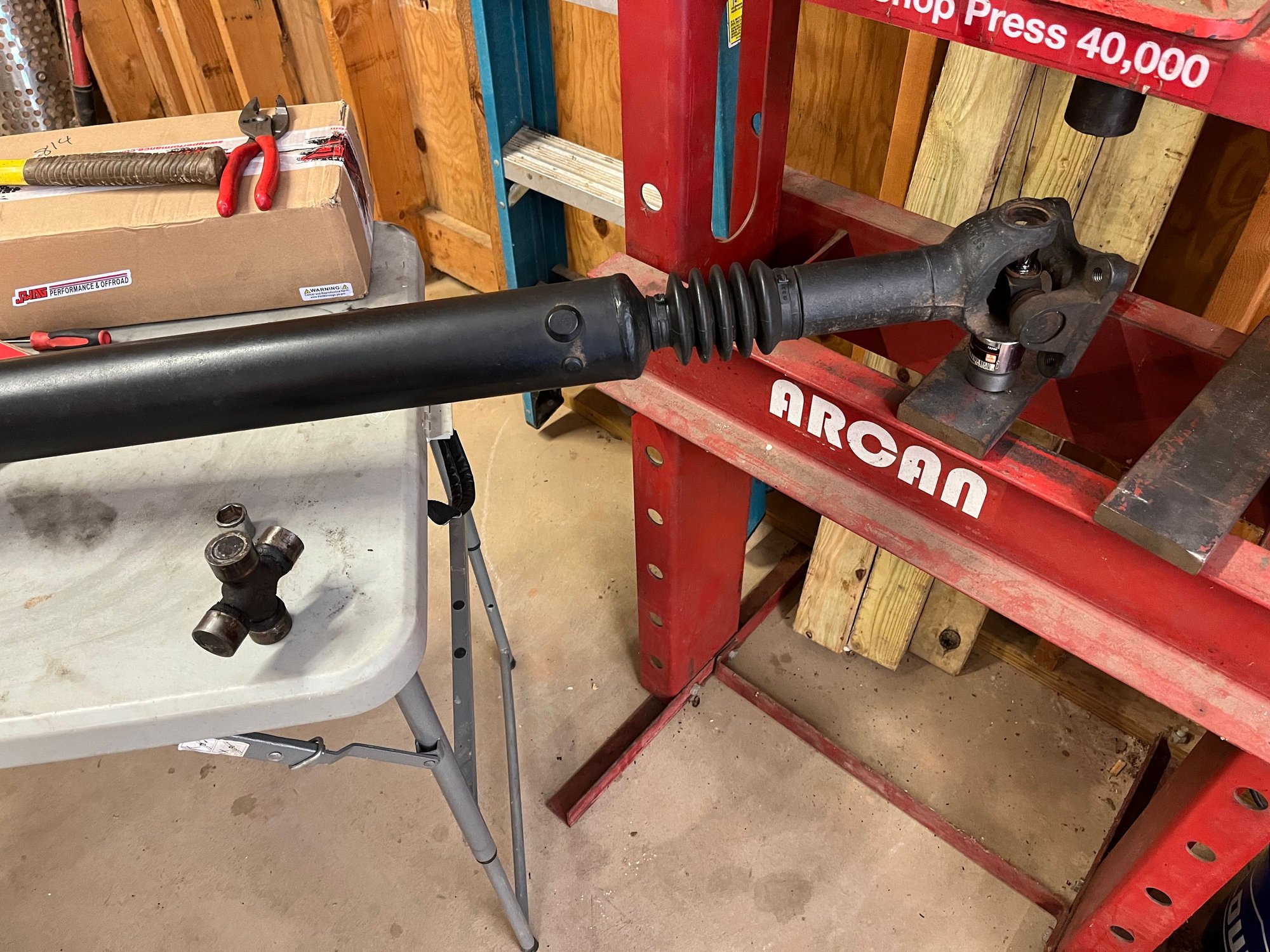

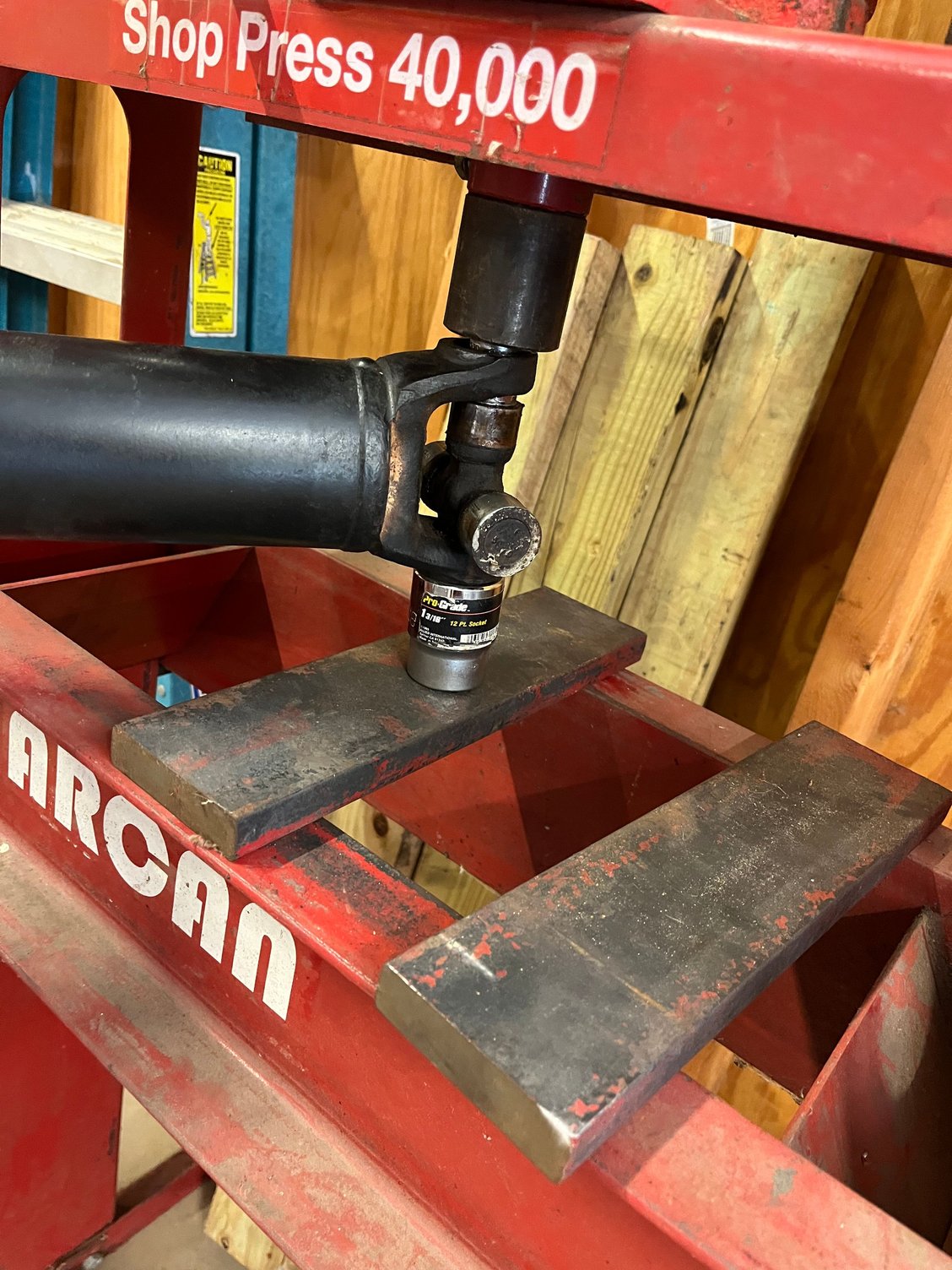

today wasnt much.

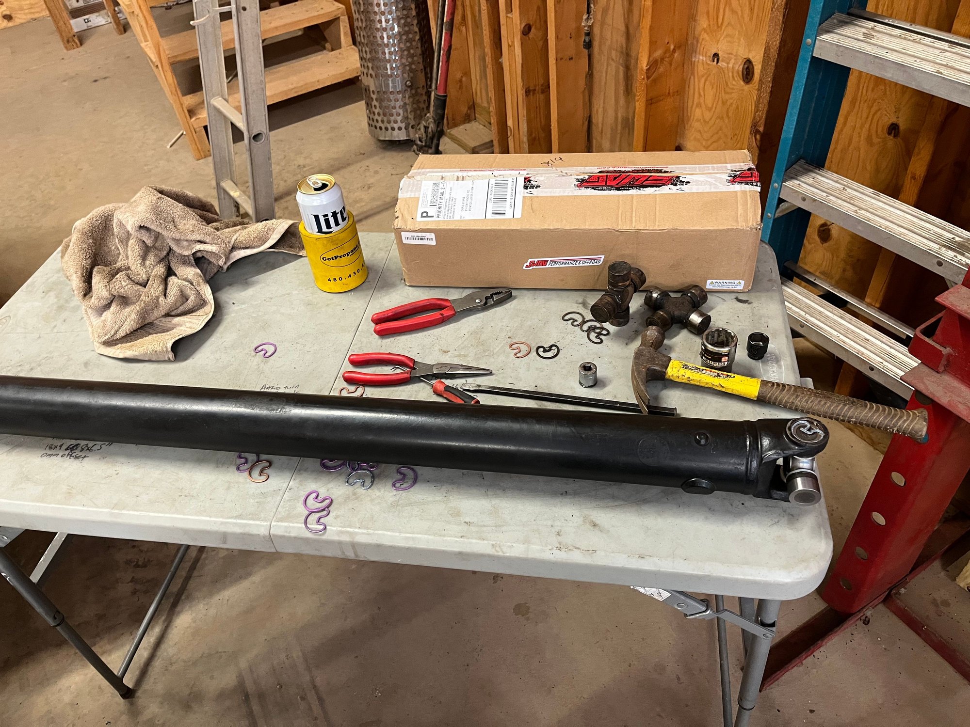

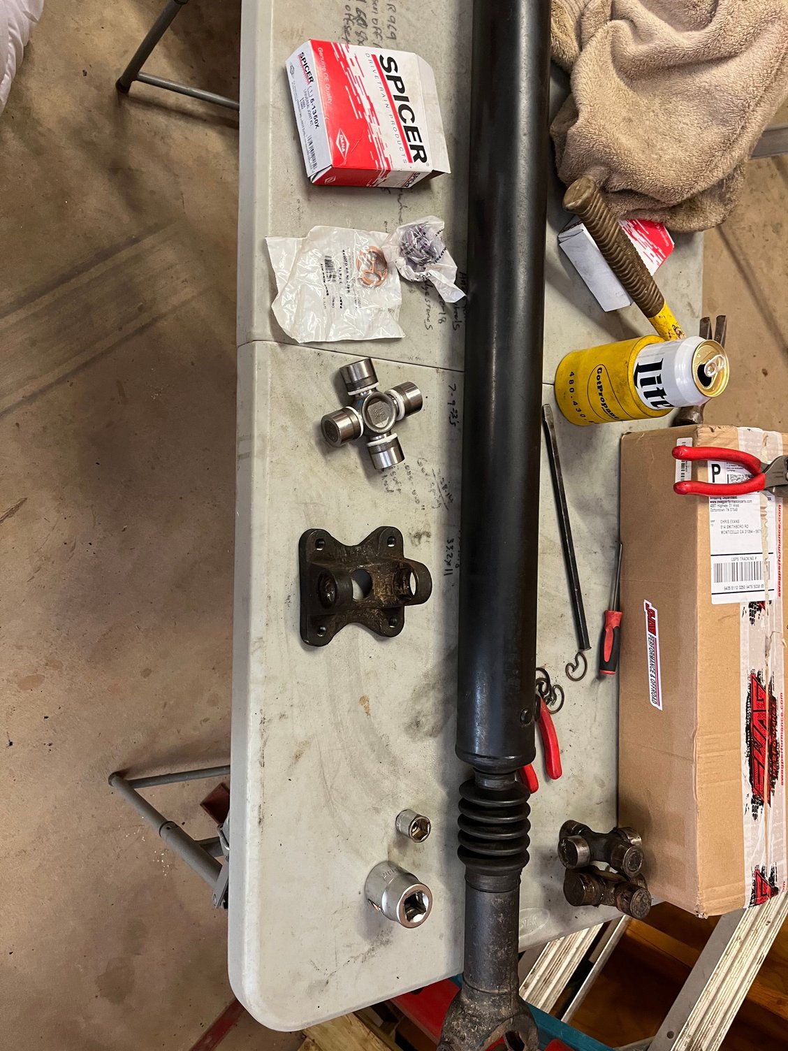

threw ujoints in her. Snapped a few extra pics to highlight why I’ma fan of non greasable spicer life series ujoints. Obviously the newer joint was the junk parts store garbage at the pinion and the original at tcase looked way better. Probably would have been fine to keep running.
pretty standard stuff, missing my vise but thankful for my press. Until recently all ujoint jobs have been concrete floor and wood blocks with a alot of cussing

I hate janky wiring too, these are prewired under dash for a trailer brake. Companies like Curt have adapters to use their controllers into stock wiring with no hackery. New starter spins over quick now.

Good to know, I was hoping that might be the case, I'm taking it all out and starting over, ill snap a pic of the giant nest at the rear. Also noticed two of the wires that were hooked to battery with no fuse just dead ended right at the back of the cab, short/fire waiting to happen..

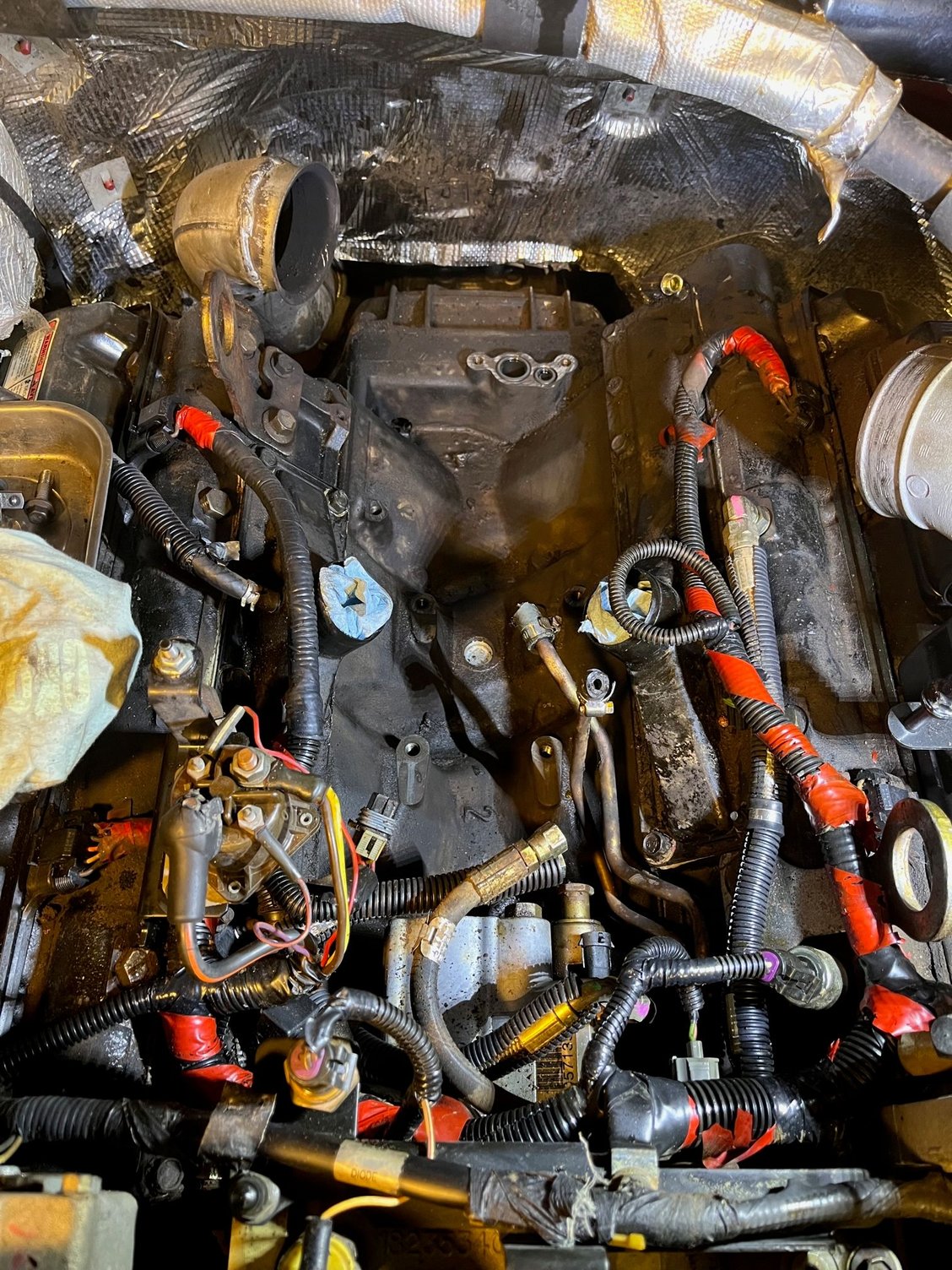

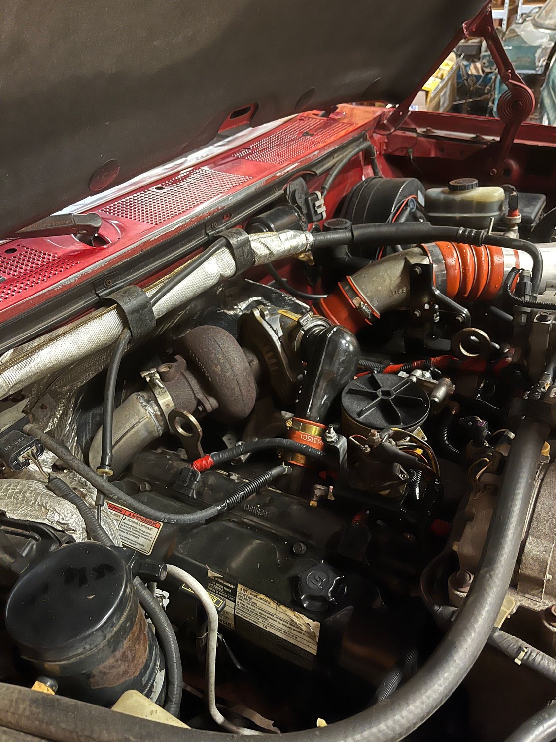

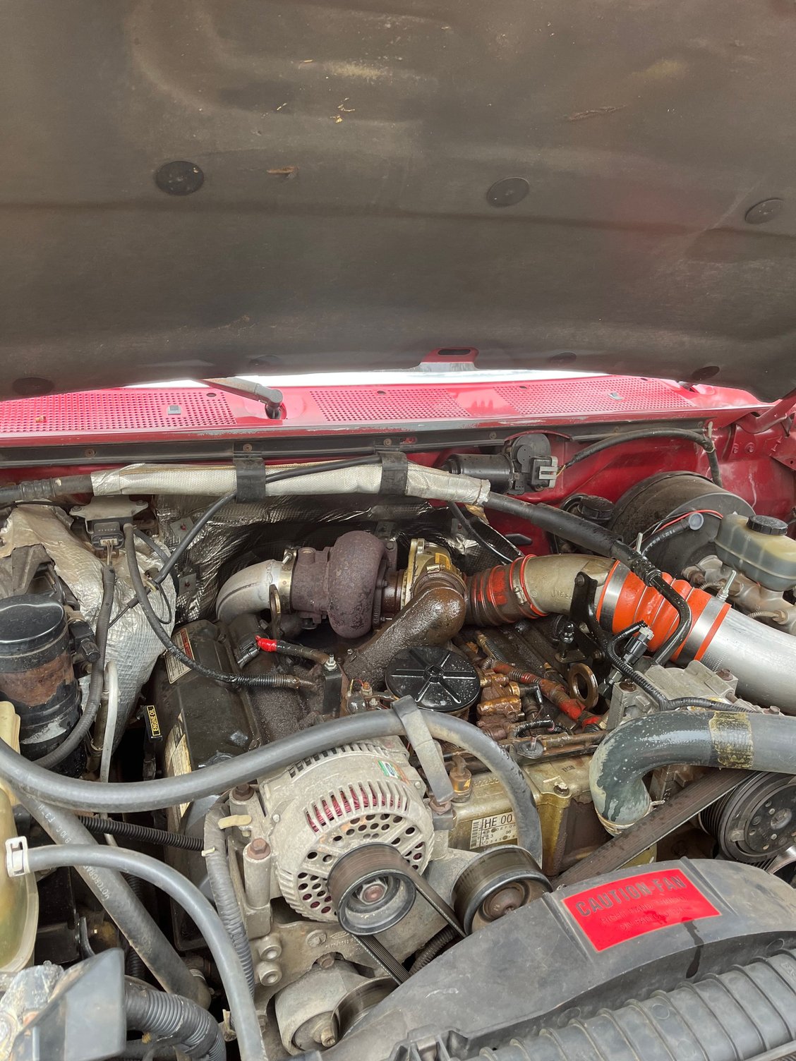

Set out to get her torn apart. First ran batteries dead cranking purging air in fuel system, finally got started.
Ripped the rest of the fire hazard wiring out and took her to get cleaned.

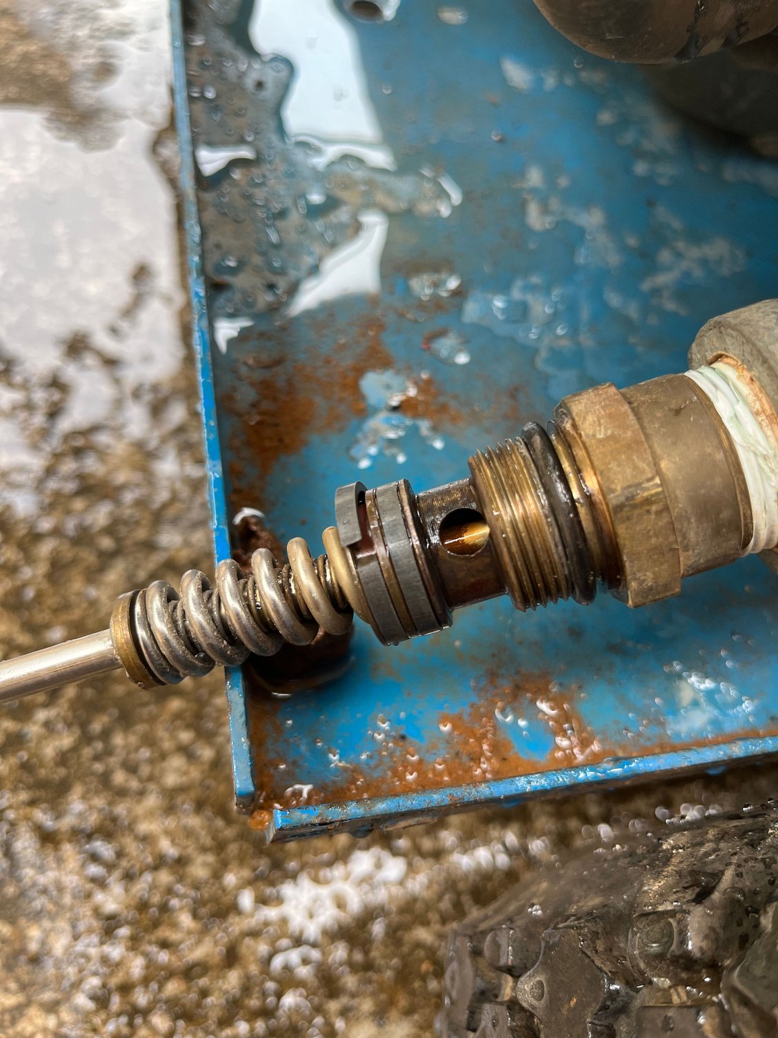

Ended up spending 4 hrs working on pressure washers. Hot water unit needs unloader valve. Old reliable ended up getting the job done with cold water and purple power.
after all that i said f it and had a beer.
Filthy under where engine cover was.
Noticed oil in icp sensor, yay.
I tried my best with shade tree tricks, but it just needs replaced.
Better, but still dirty

Why can I not tell what that rod is? LOL...I have not worked on mine enough this last year with everything else going on and the hectic schedule to remember what is what. I DID replace batts with new AGMs and all new 3/0 cables. I highly recommend those cable here as well. These they have seen better days. Solid work though, as always. I am jealous of this rig. It's tough!

That's the guts of the unloader valve in my electric hot water washer after I put them back together before they went in the housing. not a truck part .

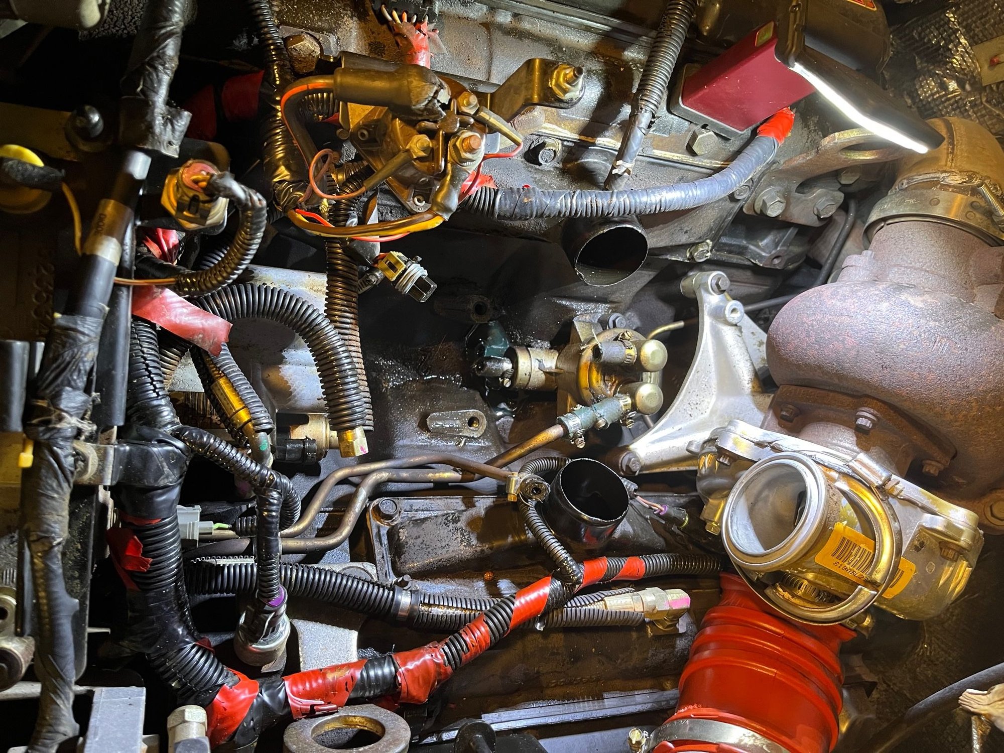

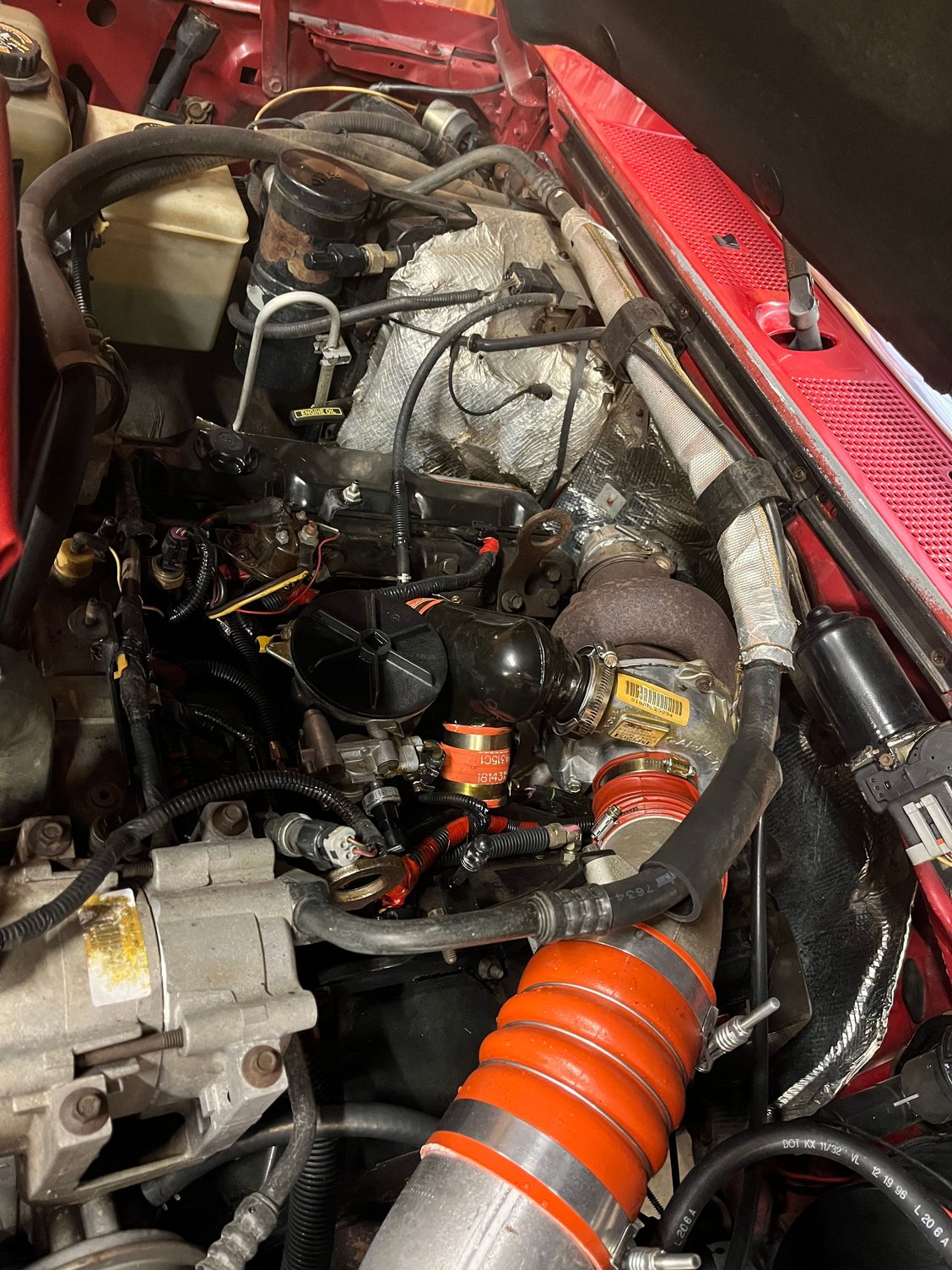

Finally got around to working on here for about 4 hrs today.
I wrote down some notes/directions from Mark Fugazzotto 's YouTube video on his e-fuel.
May break down and buy some riffraff boots, if they are in stock yet?

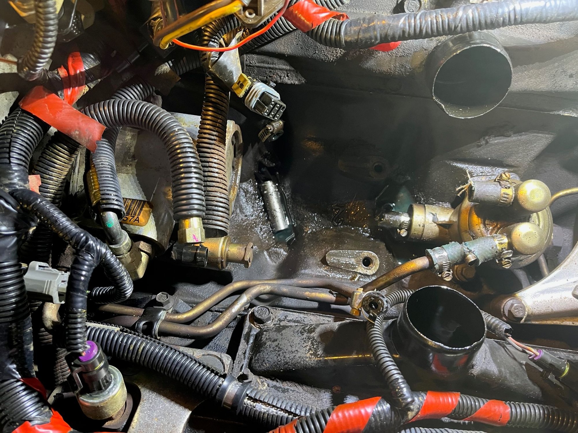

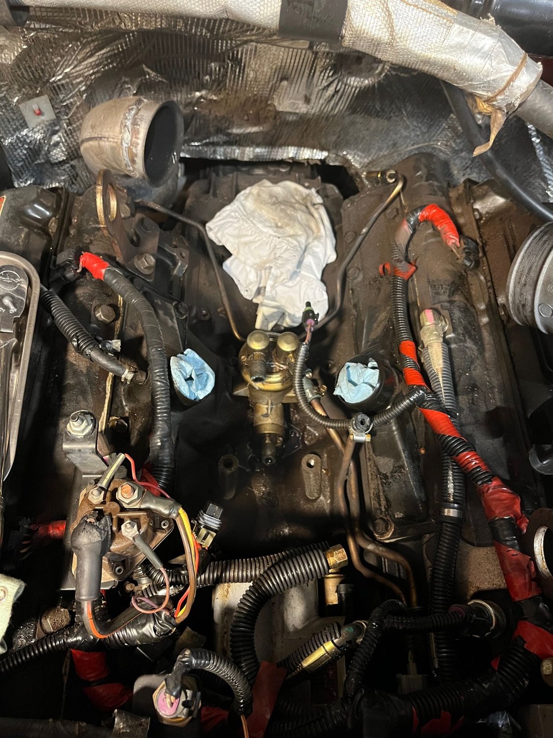

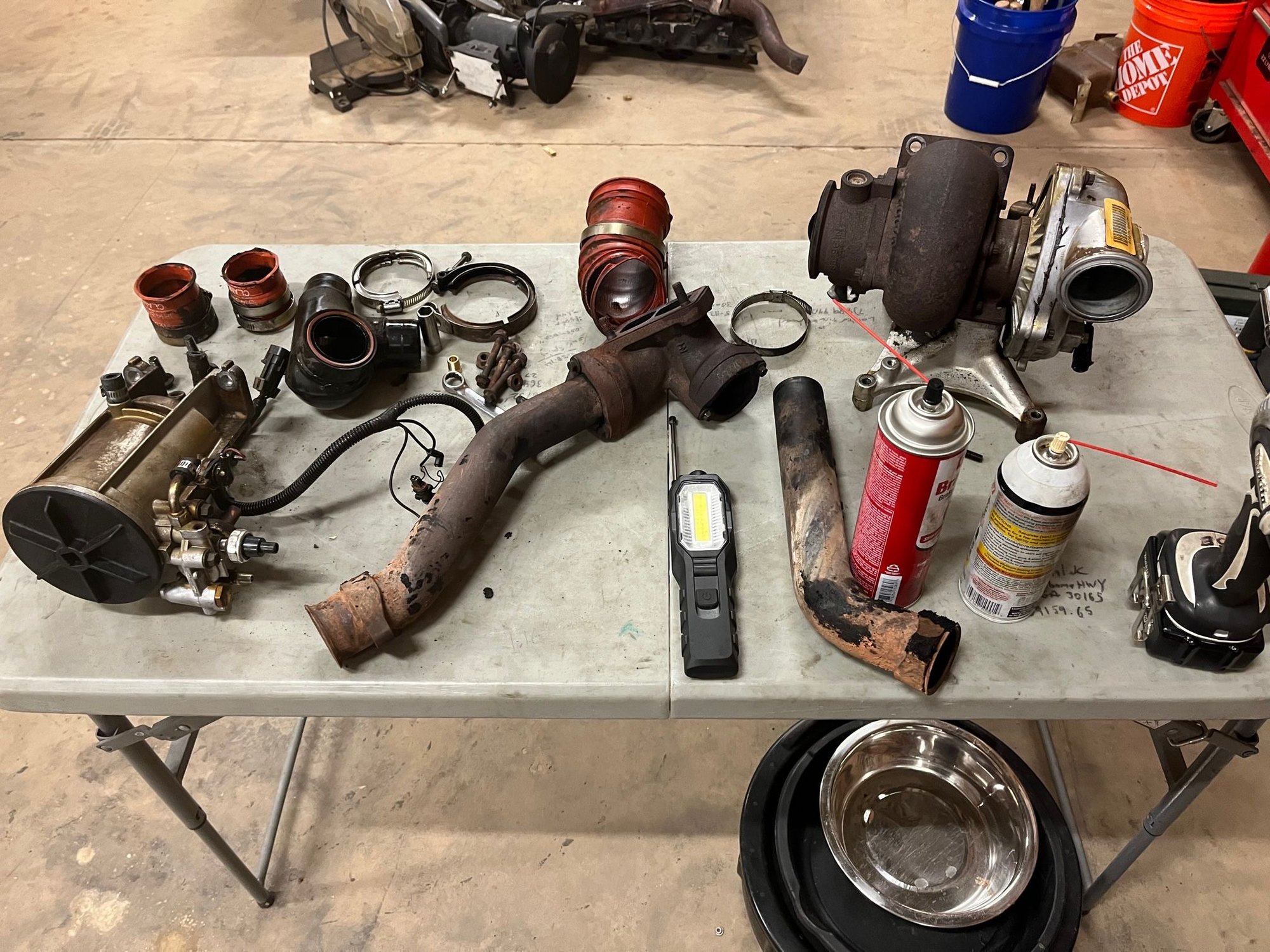

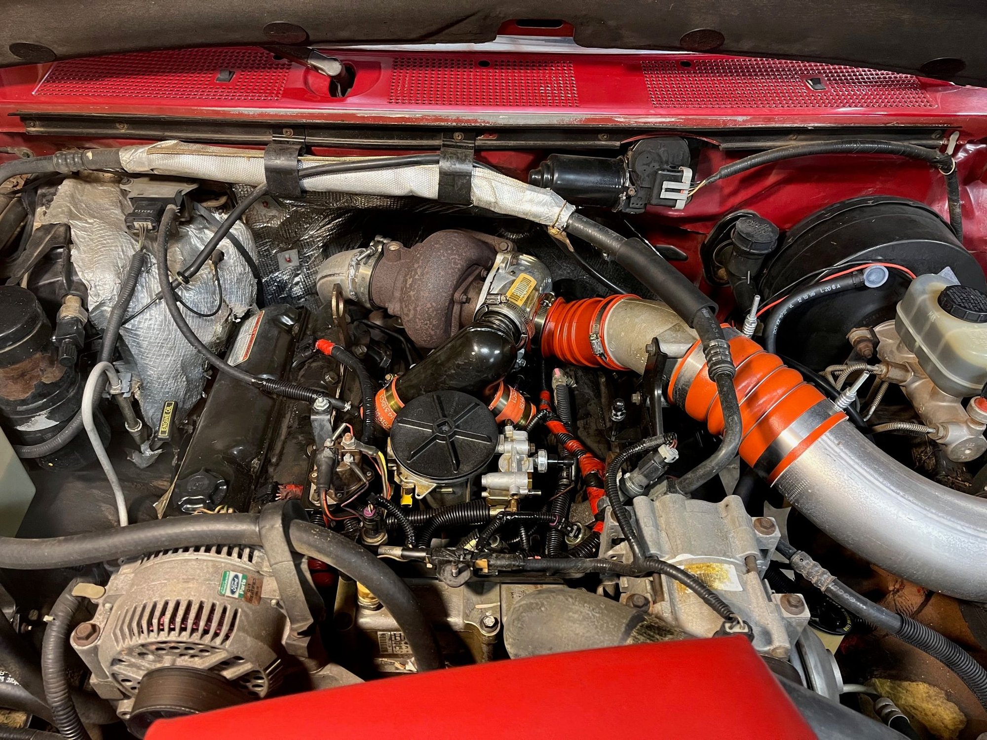

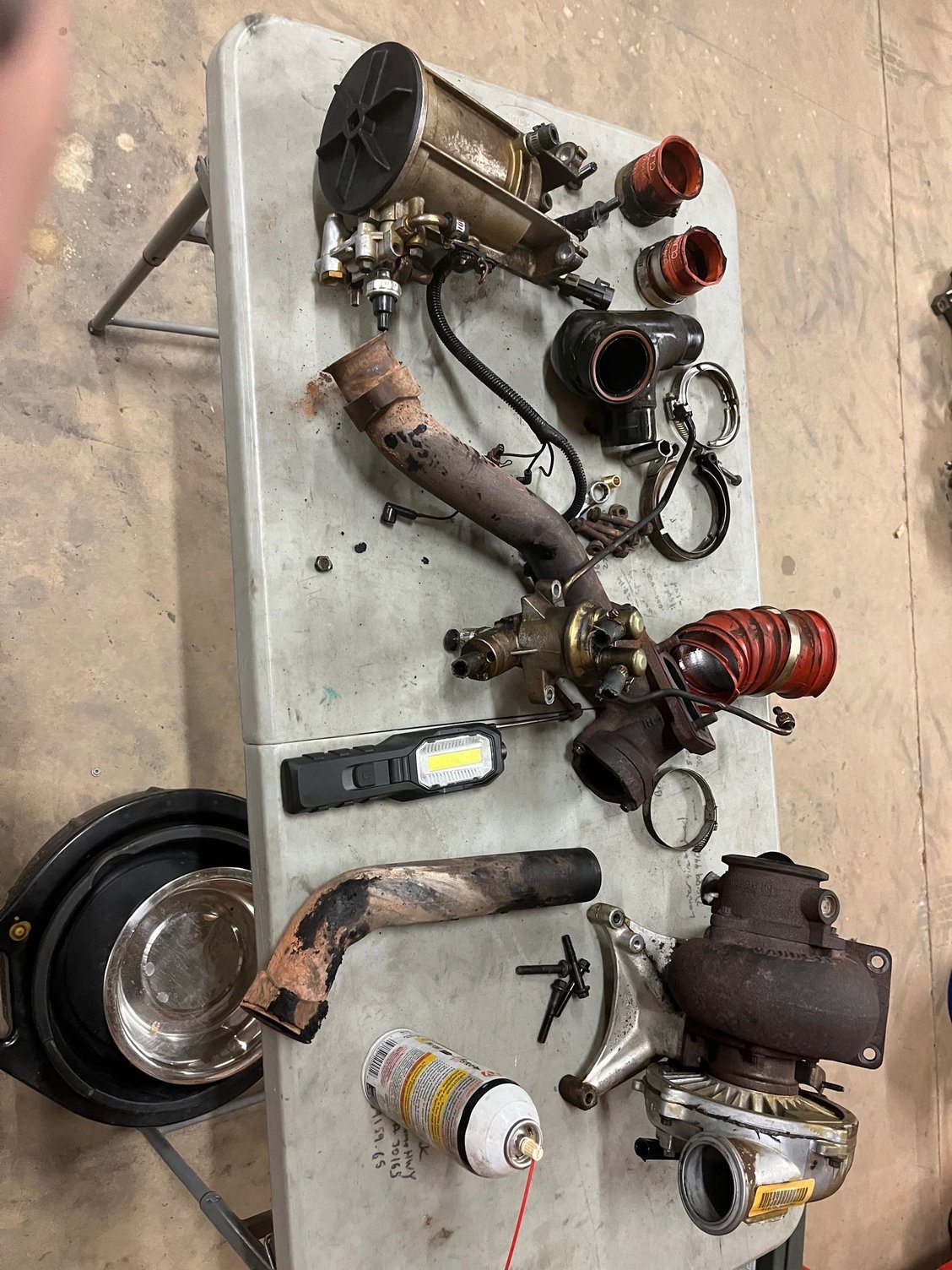

Cheapest snap on tool I own, free. Someone left me a 13mm 3/8 drive. Ipr nut was tight, but solenoid seems cracked at the plastic.
Bowl came out easy.
Pile-o-parts. Missing my long wood workbench. In due time..

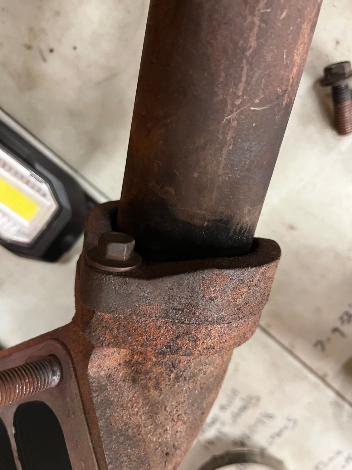

Both up-pipes were leaking good, the other you cant tell cause my greasy hands all over the top. Pass side slipped right out.
Fuel pump came out pretty easy, Lightly popped it on the top with hammer and just wiggled and pulled and eventually came out.
Half assed cleaned valley, I'm not interested in getting it spotless. Slapped in freeze plug that comes with kit, pulled off hose ends and covered turbo oil passages and called it a night after cleaning the wife's vacuum with shop air.
Will be digging in to turbo next for sxe wheel, comp wheel and rebuild with DIY ebpv delete
