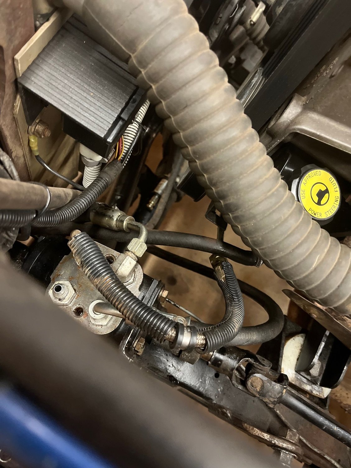

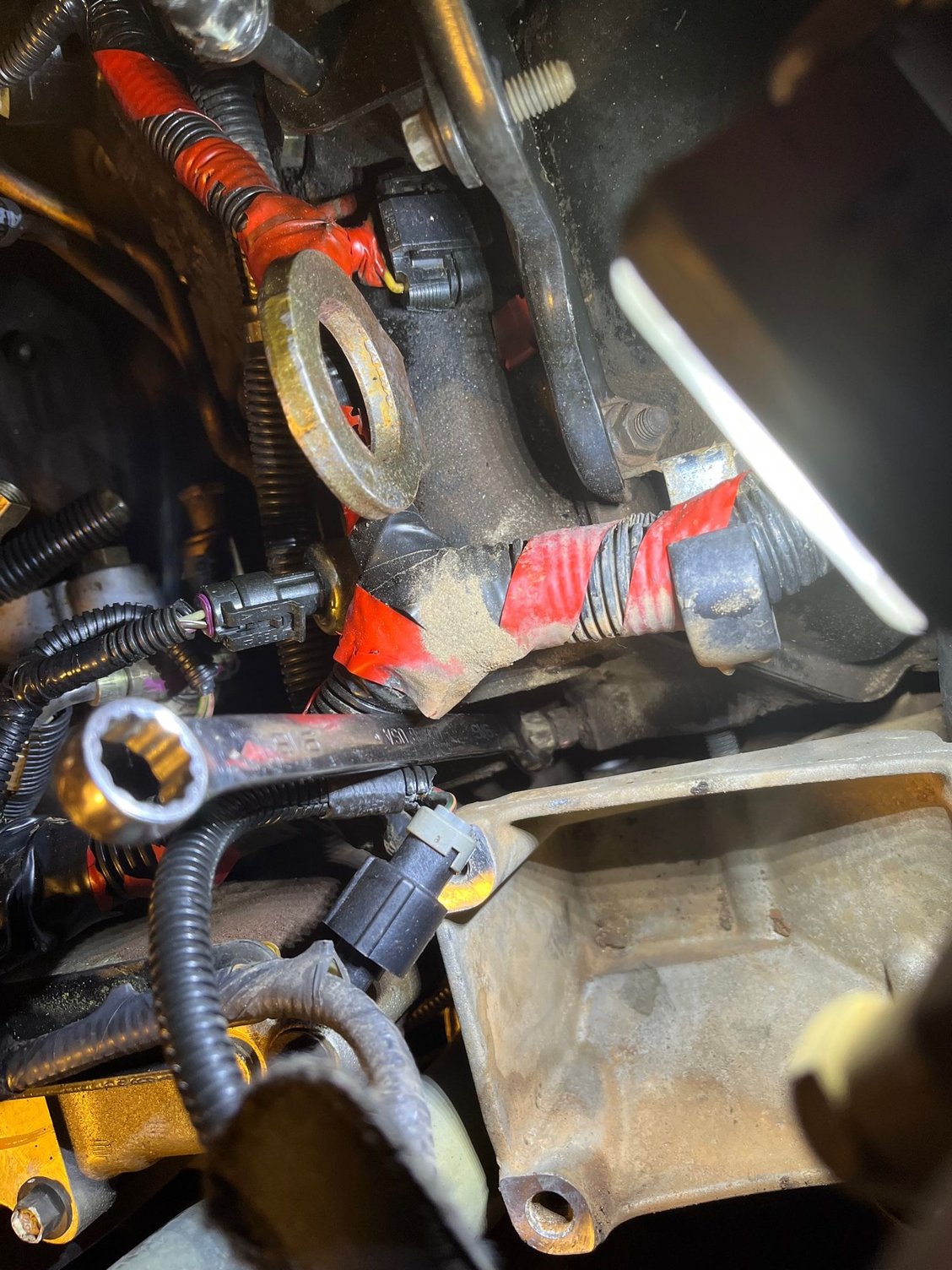

My gut was saying to do that, but my hands said NO. Do I have to pull ps pump/ac bracket to get driver side connection at head loose? I think I need to do IPR pigtail too
I spent about 20 mins trying to get driver side line loose at the front of the head. With the wrenches I have at my disposal, its not happening so I will be employing the method above.

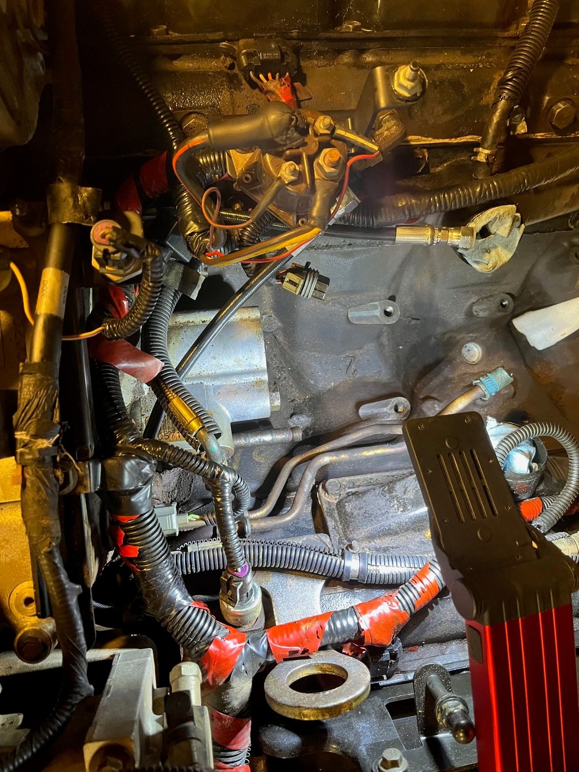

If you are bored, you can remove all that OE wiring for the mechanical fuel system all the way back to that square connector for the engine harness. This really cleans up the front section and leaves you down to simply the IPR and GPR stuff up front. Truck is going to be nice and simple with the basic upgrades you are performing on the thing.
Out here in southern LA, truck stops are $5.25 area for No 2 and RUG shows about $3.25. Sounds like we are averaging about a $2/gal differential in cost for the fuels across the lower 48.
Thank you for the tip, do you pull the pins out of the connector? I like simple. The Fugazzotto system says to use the fuel heater wire to trigger the relay, so I was planning on that route as I'm not much of an electrical guy.
I do not have the EVTM handy, but I bet you could figure out which wire from the square connector runs to the fuel heater and use that. I have my kit wired to switched 12V from my fuse box with a Maxifuse. Pretty tidy now, there should be pics in my build thread. If not sufficient, I can grab you more pics when home probably in 2-3 weeks.

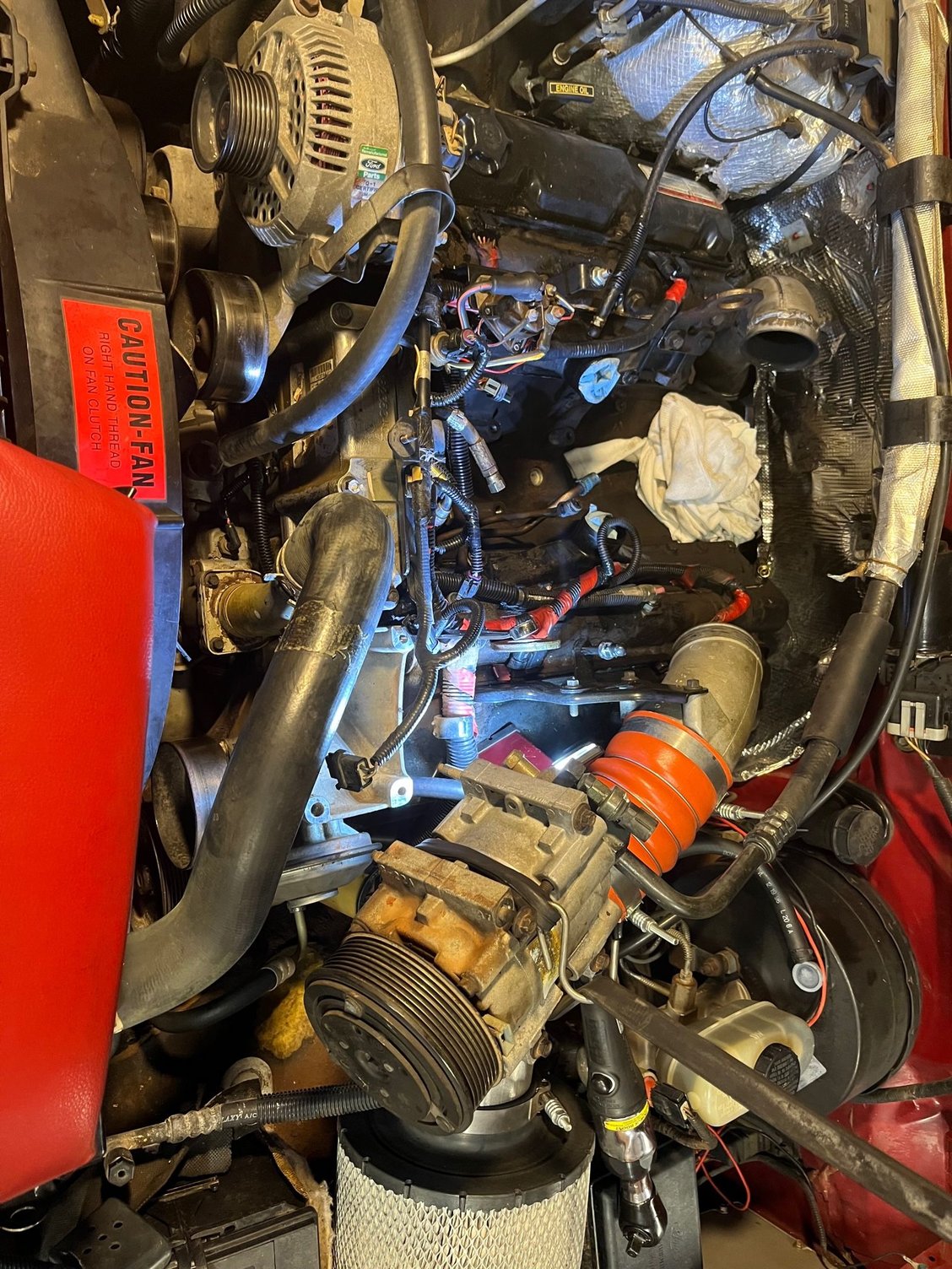

Finally found a little time to work on the truck a few hours.

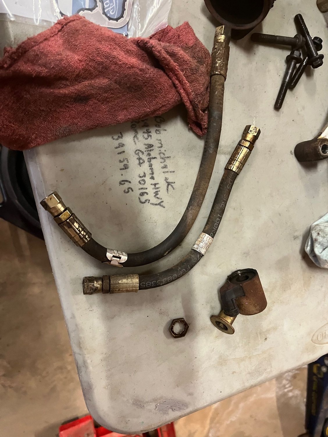

Started with unbolting ac compressor, then the 4 bolts for the ac/ps/vac bracket and pulled it forward. Swapped the return hoses out for riff raff replacements.
Noticed in the process the bottom power steering pump bolt was about a hair from backing out into the pulley. Got it threaded back in and snugged up, that was time consuming.

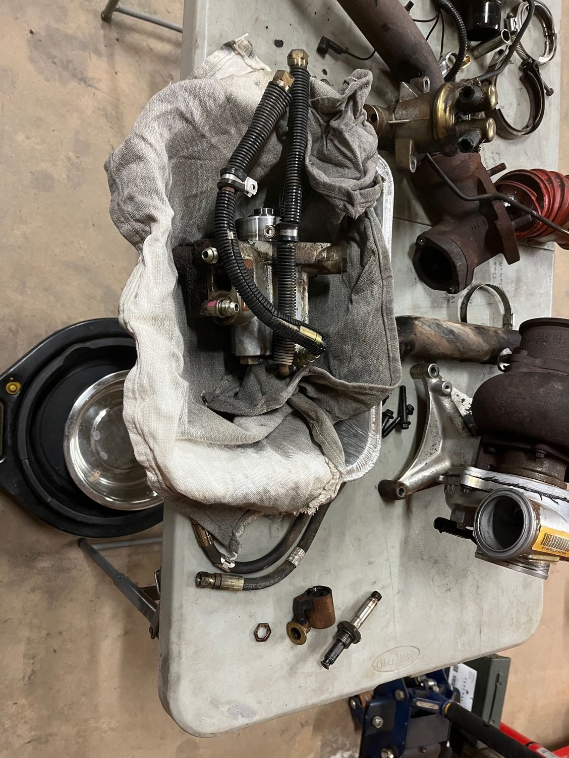

Next I pulled the hpop hoses and the old ipr then sucked the oil out with mightyvac handpump.
Gear bolt on the hpop was an absolute booger. I had to put breaker bar on alternator bolt to keep engine from turning and cheater pipe on ratchet and finally got the bolt loose and removed.
Yanked the pump and cleaned things up a bit then called it a night. You can see route of new return hose old stuff, cracked plastic on solenoid. Free barely run reman ford 17* hpop ready to go in. I don't think there is anything wrong with the original but I have had this laying around awhile so why not. Likely this truck will be getting 160's at some point.

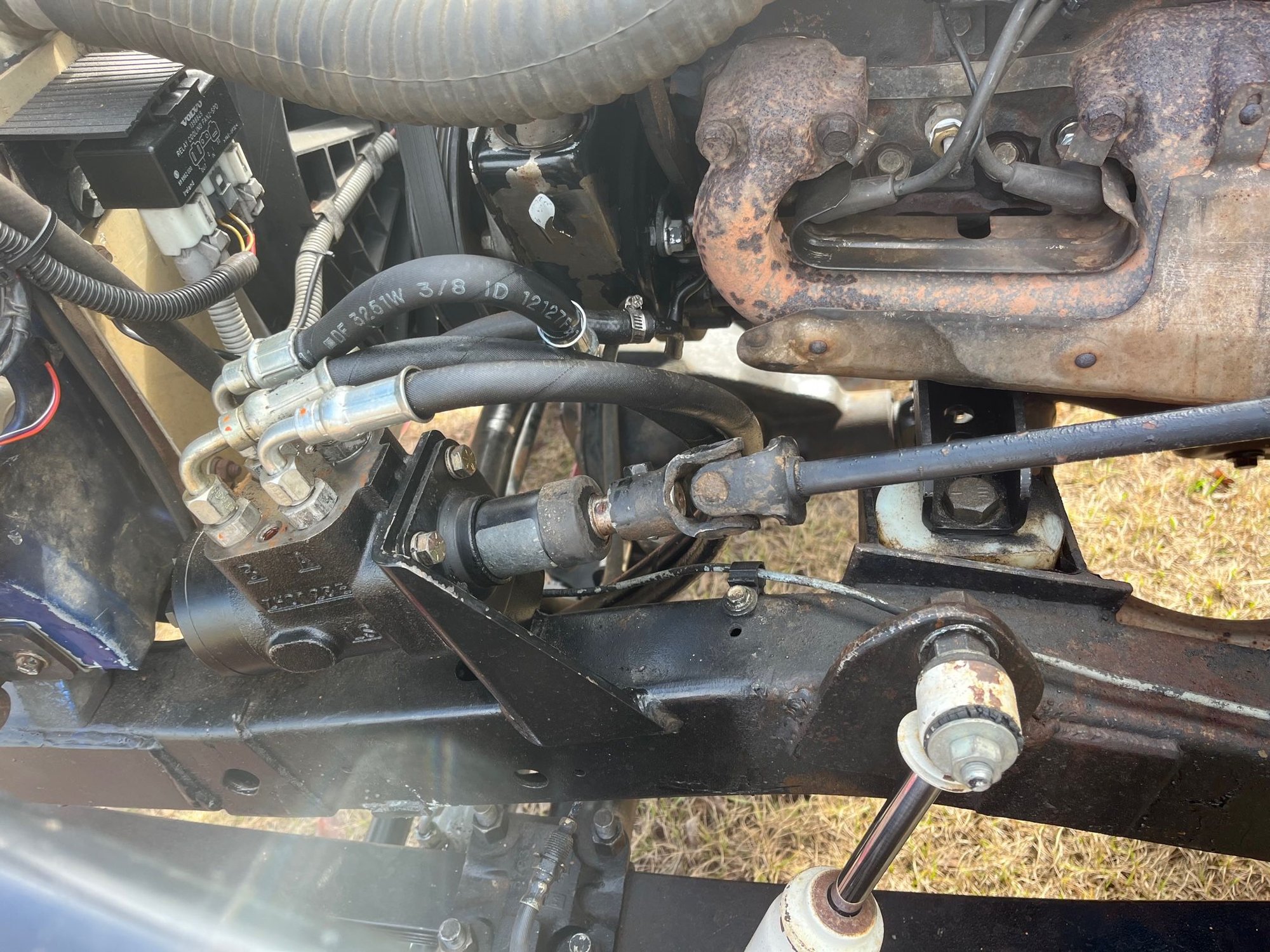

I had a hose fail from the pump to orbital on my 92' YJ Saturday on a ride. I think i found a use for the old hpop hoses, one will act as a trail spare. I just need what I believe to be a 6anmale to #6 orb adapter.
