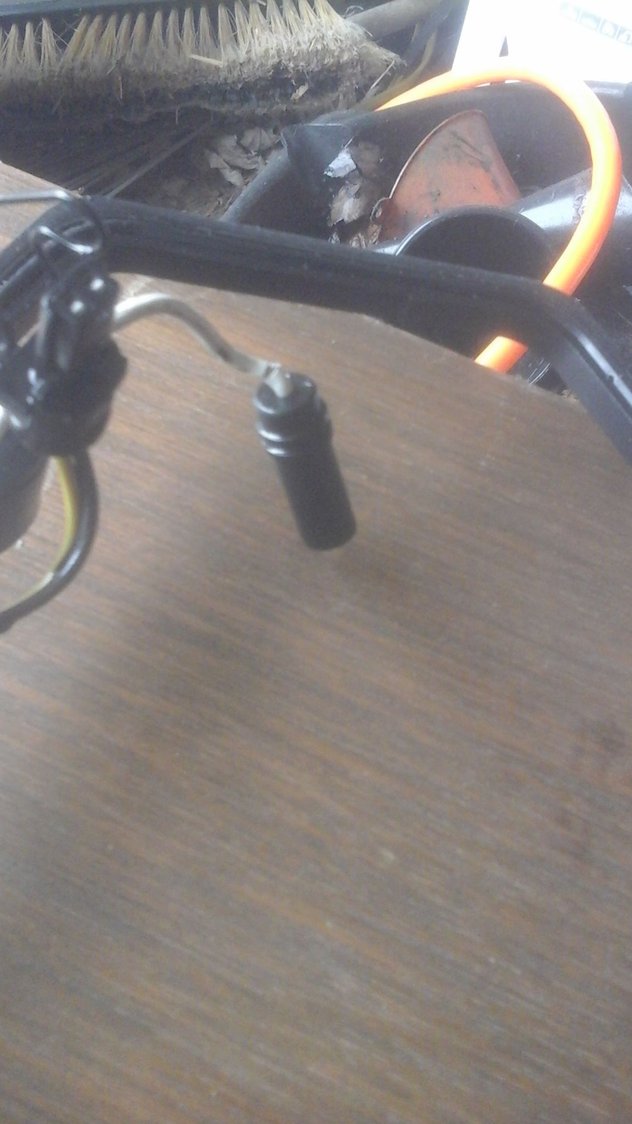

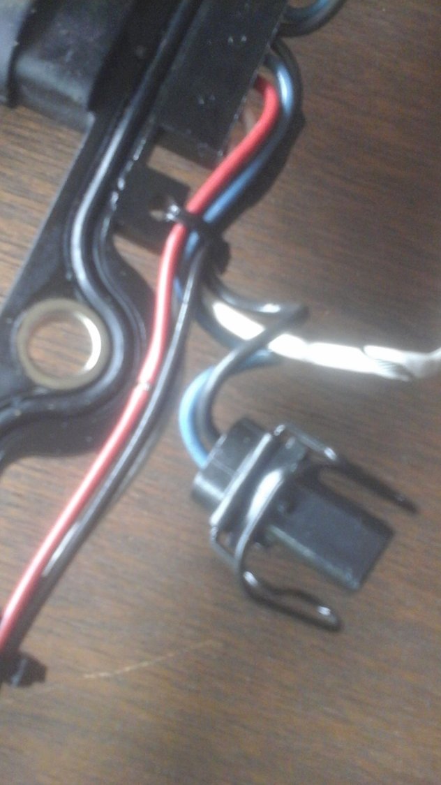

No more dorman for me. These dorman harnesses were installed by a shop 1000 miles away from home on a trip to CO. These pics are of a harness less than 2 years, and under 5000 miles. The insulation is cracked/split.
