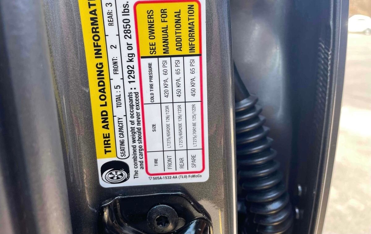

I am leaving my F150 for a larger truck because of payload capacity. The truck I currently have on order is an 2022 F250 CCSB Lariat Ultimate 7.3 3.55, and I suppose I am a little concerned that it’s payload capacity may not be as high as I hope.
Does anyone have any actual payload figures for a similar truck that can either put me at ease or force me to change my order?
F150 payload is 1689lbs and I was hoping for north of 2500lbs and closer to 3000 lbs in a F250.
I too am leaving a F150 that has 1575 lbs of payload. The new truck just arrived, so the verdict is in. Like the OP, I was hoping for north of 2500 lbs, so I’m pleased. It’s more than enough for my needs. Loaded F250 Lariat CCSB w/ 7.3 Godzilla. Full truck details in signature. To the OP, did you change your order or stay the course?
I did change my order from an F-250 Lariat to a F-350 King Ranch with the 7.3. All said and done the change cost me $1,100, which is surprising low.

My 2018 F-150 XL CCSB (w/ STX Package), 5.0L, 2wd has a payload sticker showing 2026 lbs.
* currently waiting on a '22 F250 Lariat CCSB 7.3L FX4. Expecting a payload ~ 2800 lbs.

Originally Posted by d7velo1
Wow.
Ford really should publish a database that could calculate the payload with specific options selected.
Totally agree on a payload chart/calculator. I don’t know all the options on your truck, but you should be on the plus side of 2800. Mine is a ‘22 F250 Lariat CCSB w/ 7.3 and I have 2850 lbs. I don’t have FX4 though.
