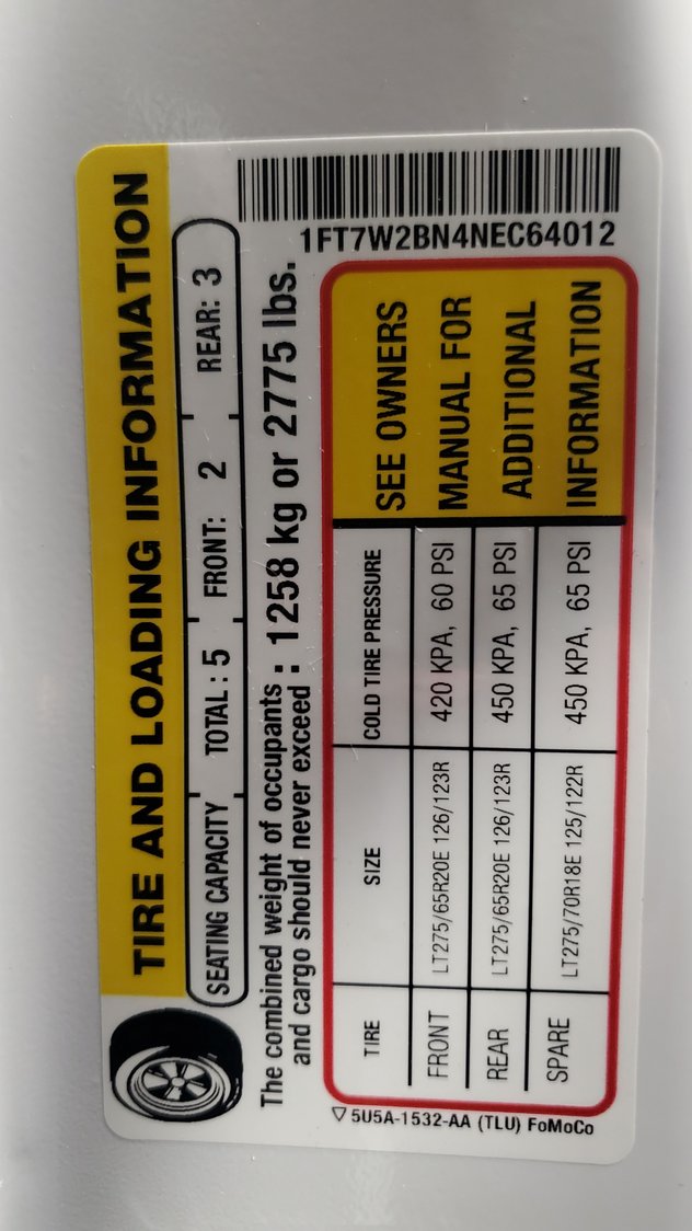

2022 f250 sbcc Lariat Value with black appearance package. 9900lb GVWR. At scale, came in at 7700lb. So 2200lb left. That is with full tank of fuel. 2 people 4 sandbags (winter weight), tonneau cover and odds and ends. Here is my door sticker.
