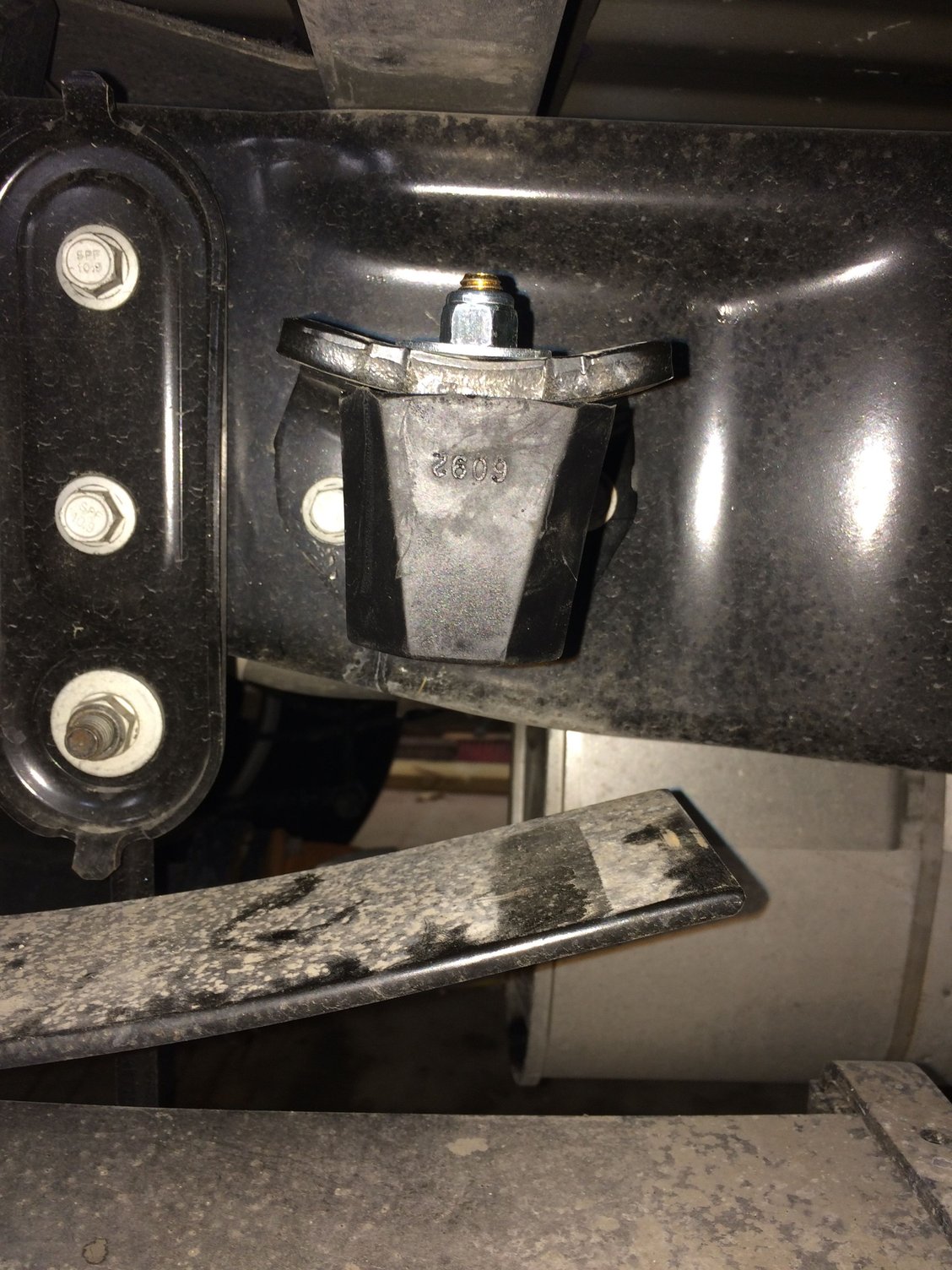

Originally Posted by Hickeyjones
The suspension just doesn't handle it as well from what I've seen so far. 5k in the dump trailer squats the back of this F-350 quite a bit, and the overloads are a couple inches away from the contact pads still.
This bothers me too, I added these, verdict is still out.
My F350SRW sits far too level from factory as well, wish Ford would have kept the taller rear axle blocks in place.
I've considered something like that. I've seen one company selling something similar for about $350. Where did you get those? I image that affects your empty ride some.
$69 from Amazon, price includes all 8, plus tax, plus the fender washers and nylon lock nuts I used. Energy suspension 9.9136G. When riding no load in bed they do not appear to touch the springs, unless I fly over an elevated rail road track for some dumb reason. When I hook up a 8000-1000# trailer they are compressed on the spring. Verdict is still out, not sure if I am getting rebound from them, or just the natural loading/unloading of the spring pack. They do keep truck more level when a heavy tongue weight is applied.
Edit, you cannot tell from pic, but I used 2 per hanger, 4 per side, 8 total.
Thank you very much for that.
