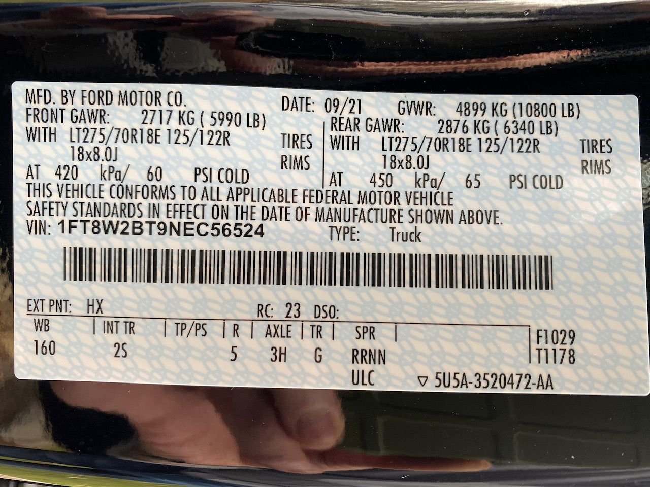

Also, IIRC, the camper package isn't an option with 20" wheels. This was another reason I wanted 18" wheels. I actually added the snow plow/camper package to my 250. I wanted the extra suspension upgrades, which is the same suspension on a 350. I ended up with 5990 front springs. Here's my door sticker. (My 250 with 6.7 also has a 3016 lb payload!)

If you are wondering if your truck will come with a 2.5" or 3" hitch, it will be a 2.5". The only 250's that come with a 3" hitch is the 6.7 with the HCTT package. (Note that this package cannot be added with a gas engine.) Gas trucks don't get the 3" hitch until 350 DRW. The Ultimate Trailer Tow package only includes the 360 camera's, PTBA **** and lane keeping. It doesn't actually do anything to help the truck tow more/better... it just gives you extra camera's and gives you that PTBA **** if you decide you don't want to use the steering wheel to back a trailer up... lol.

Originally Posted by Deano_1
Do you have the camper package? Dully?
No DRW, it's a SRW, 2022, F250, Antimatter Blue, XLT Value, CCSB, 6.7L PSD, 4x4, 3.31EL w/HCTT & snow plow/camper package (as well as a number of other options, however, they are creature comforts and don't increase the towing capacity of the truck). This configuration does come with the 3" hitch receiver, and I have the Anderson WDH with the 3" shank hanging off the back of the truck!
