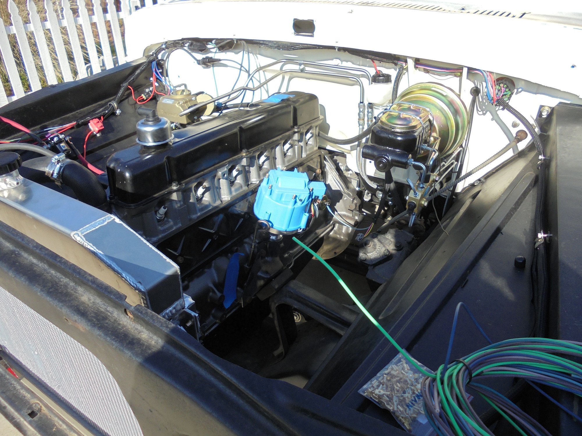

Most of the electrical stuff is done, and the Holley Sniper is all wired in.

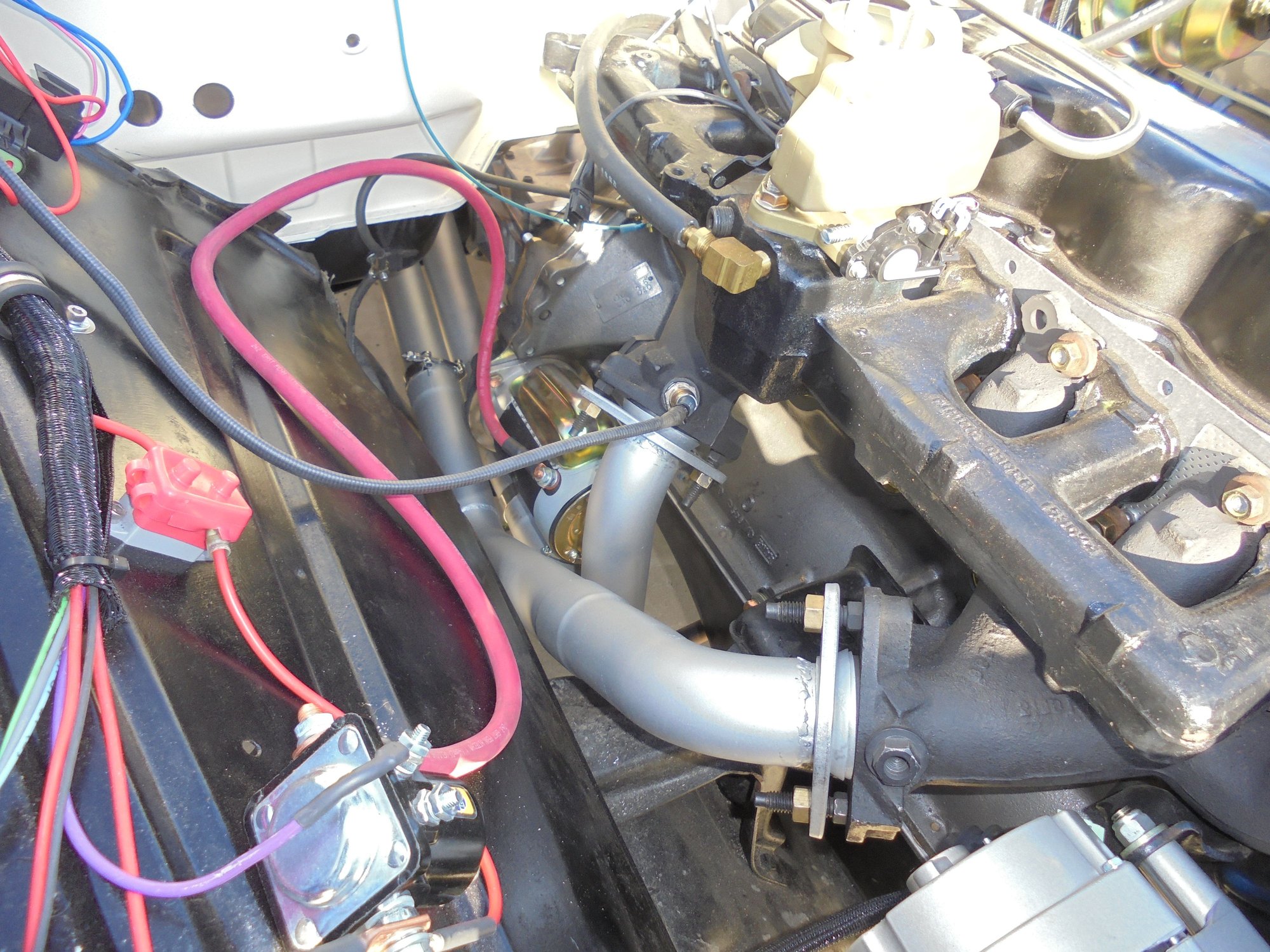

Exhaust is done to the mufflers. I used a DIY kit with various bends and straight pieces, along with a pair of Thrush Turbo mufflers.
The motor has been filled with oil and coolant, and I have spun the motor over with the starter (no spark plugs or valvetrain) to build oil pressure. Then the pushrods and rocker have been put back on and adjusted.

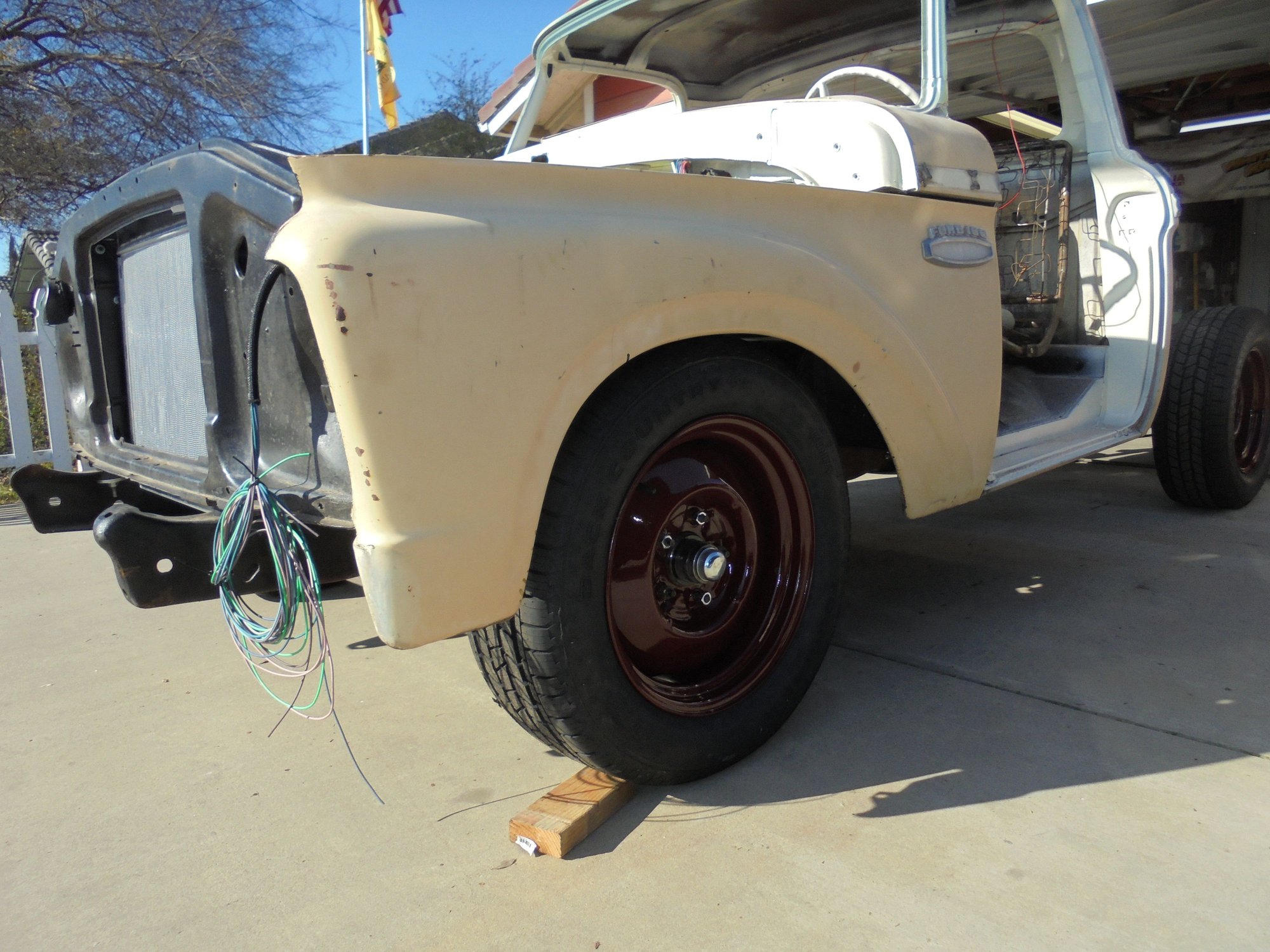

While I wait for that, I've started reattaching some of the body work, getting tires mounted and setting 'er back on the ground. With the dropped beams, the top of the front tire is about 1/2" up into the top of the fender arch. Once the rest of the bodywork is back on, it might drop another 1/2" or so. While I would have liked a bit more drop, it'll work quite nicely.

It's been a few minutes since updating this thread, and much has been accomplished.
Exhaust system....DONE!
Front body work on...DONE!

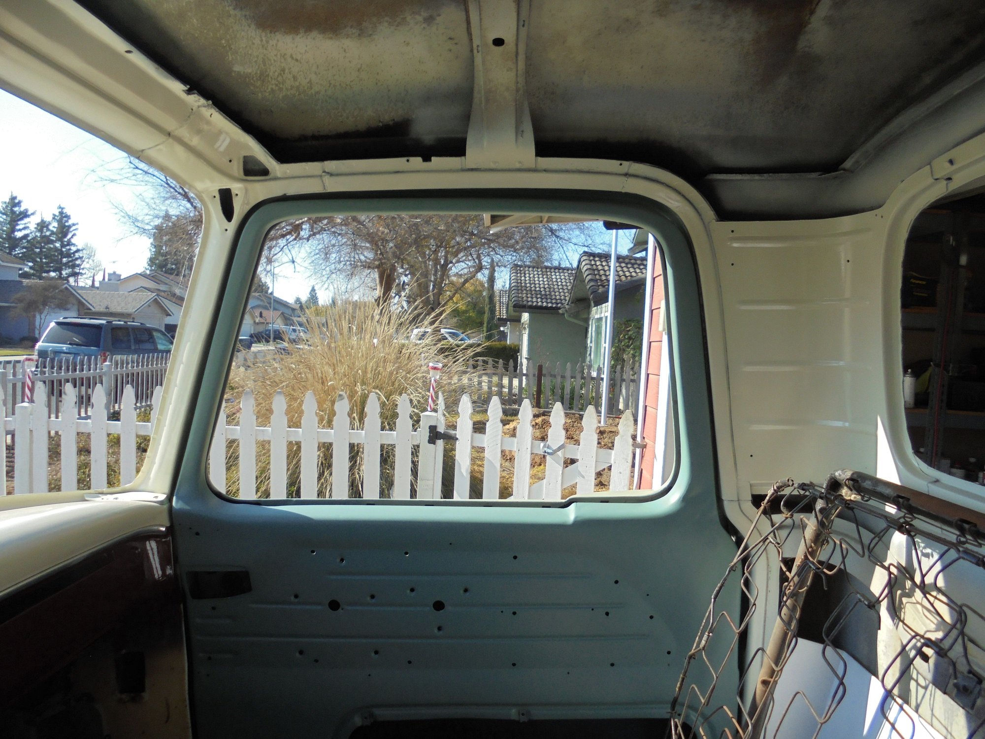

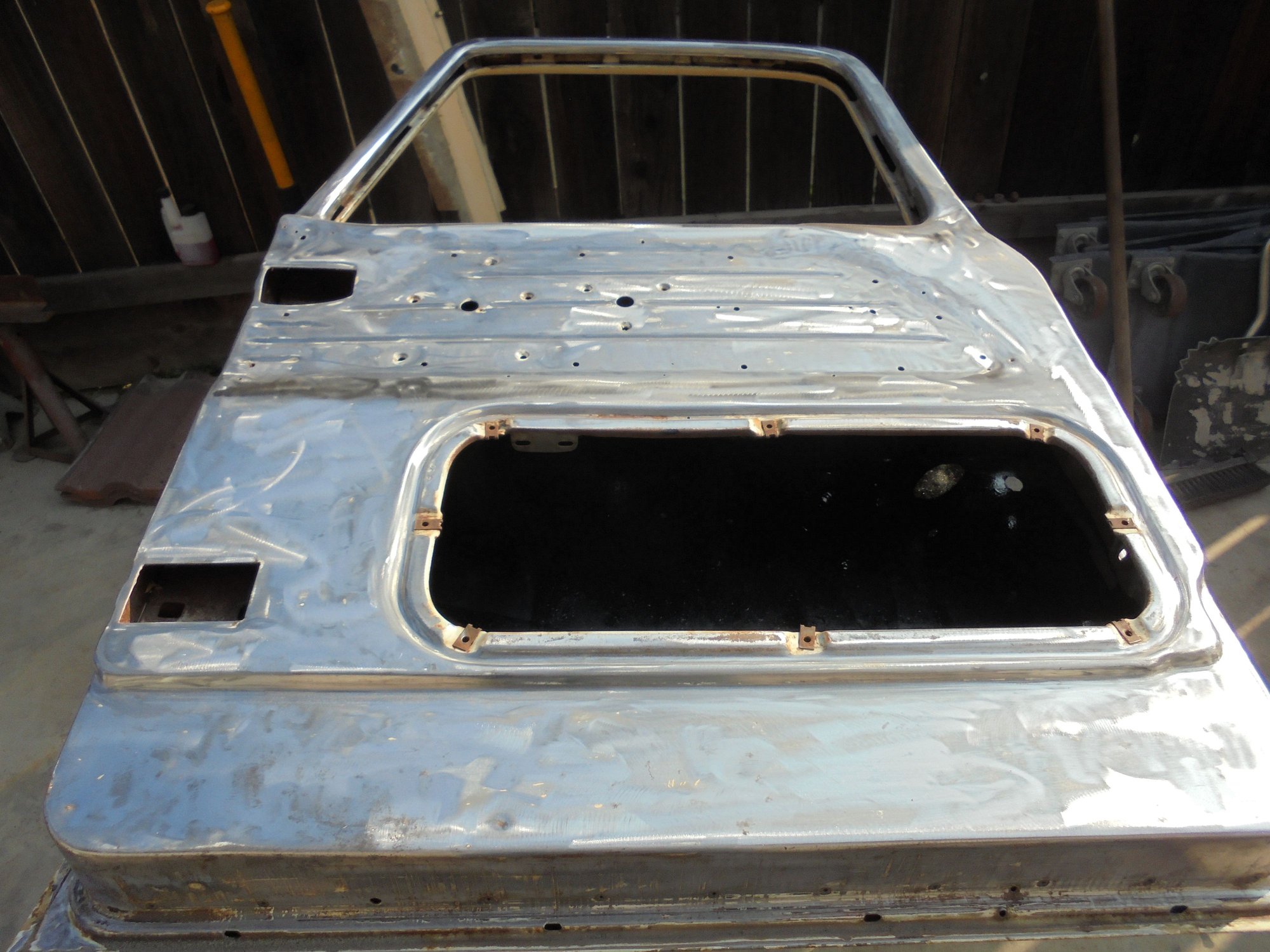

Doors inside paint stripped, mechanisms removed, etching primer on the inside and door shells installed back on truck and adjusted....DONE.

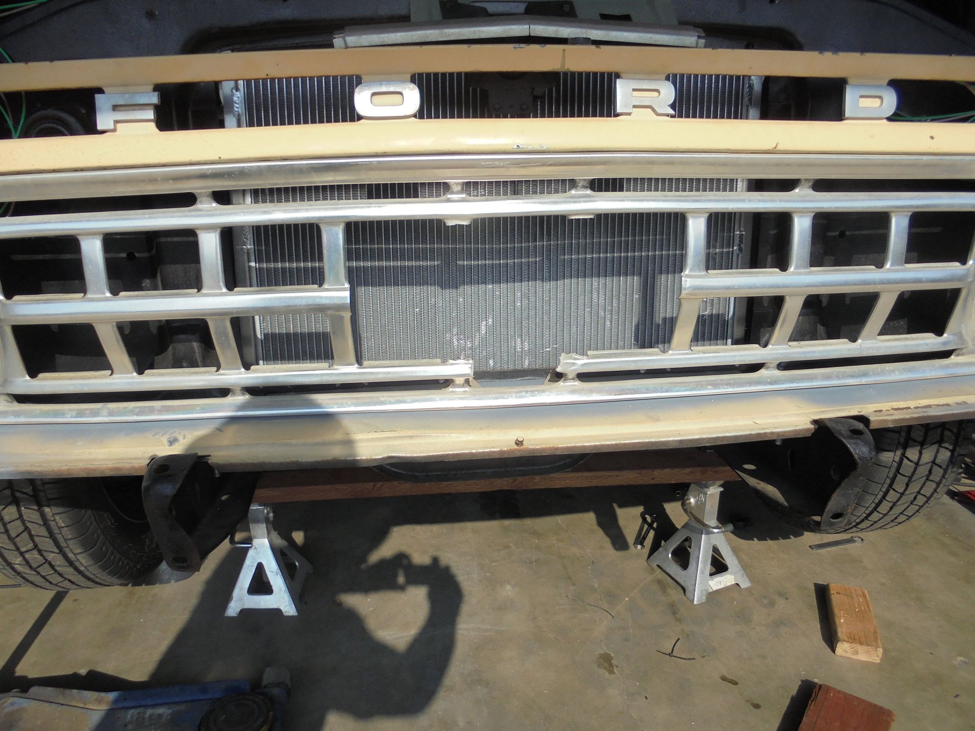

Center of stock grill repaired....DONE

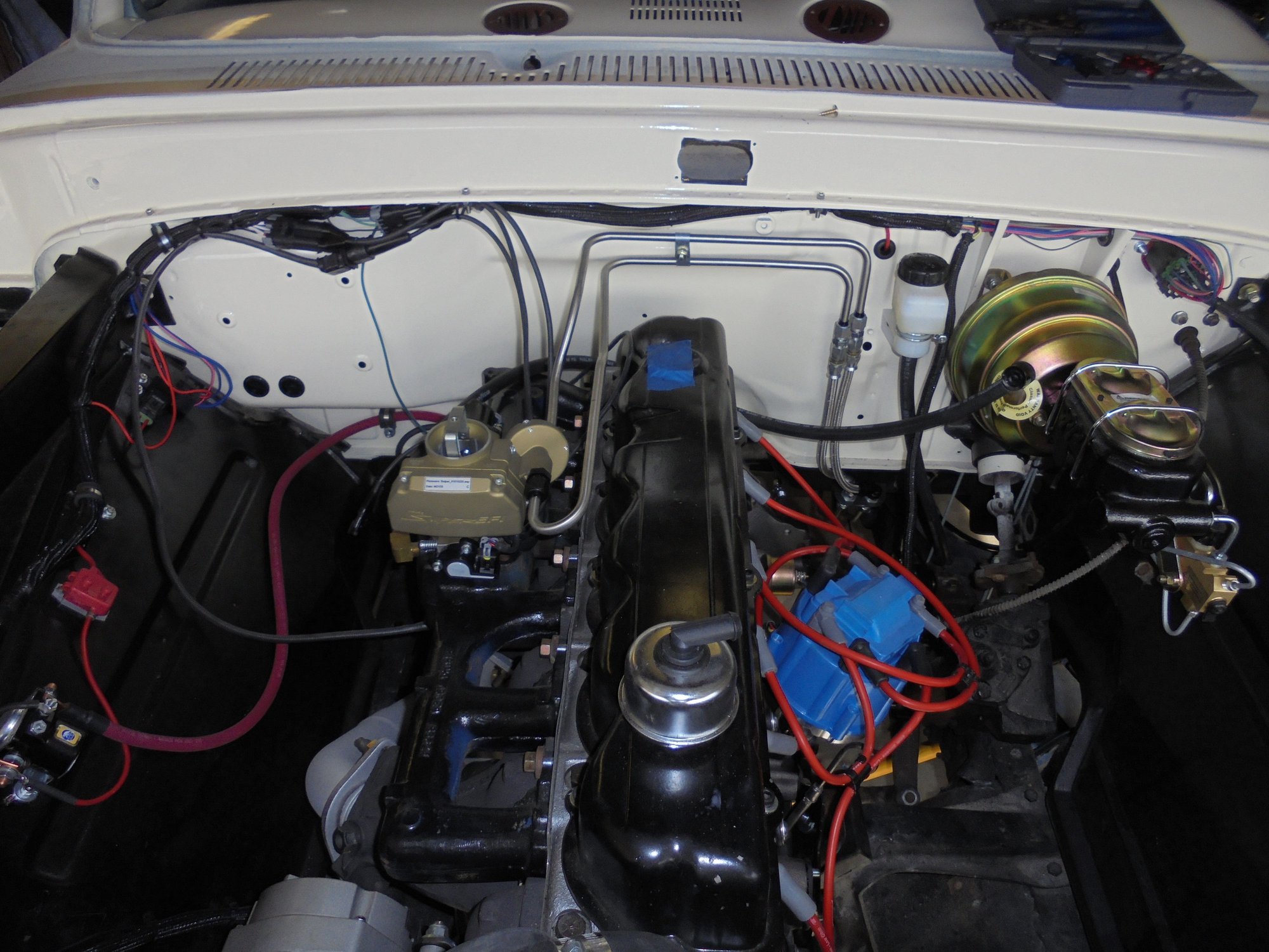

Engine bay wiring including Holley Sniper and plug wires...DONE

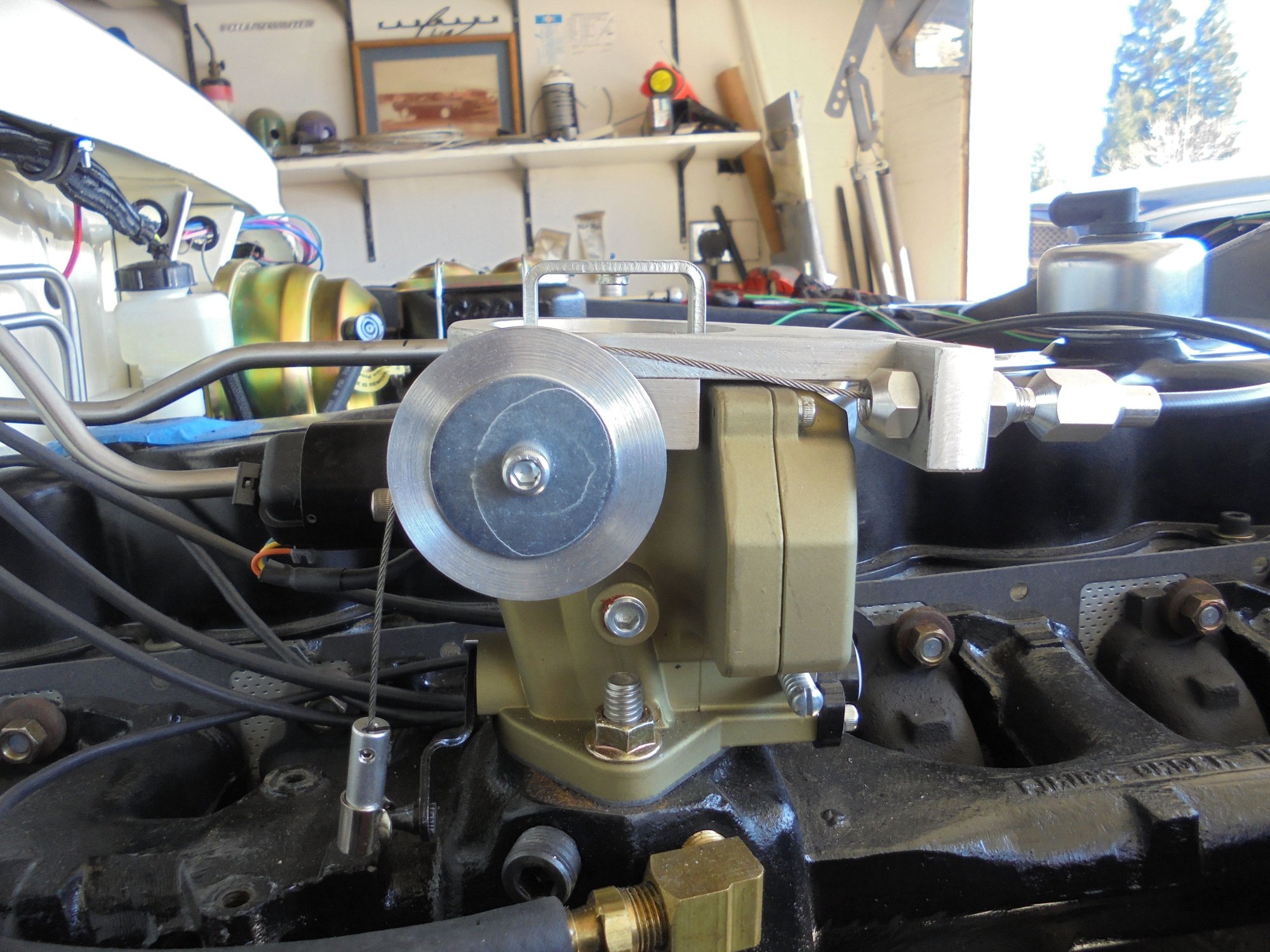

Building a roller throttle cable linkage from aluminum I had in stock...DONE
A spot of rust repair on the cowl at the base of the windshield...DONE
Driveline made...DONE
And the biggie.....RUNS and DRIVES and STOPS!
In my quest to find door window parts, I've come up short at every turn. So a change to the Master Plan was made. The regulators were absolute trash. Could not be saved. Replacements were not available, and even if they were, the prices were really high. For an extra hundred bucks, I found a power window kit from Nu Relics IN STOCK! So I bought it.
Forum member ibuzzard had given me a lead on the vertical division bar on ebay. The seller claimed to have 'em in stock. As it turns out, they did not. So, I'm in a holding pattern on window stuff.
So far, all the electrical stuff has functioned following the complete re-wire using the universal kit from EZWire. All the gauges work, alternator charges, the oil pressure is really good, and the lights that are hooked up are working.

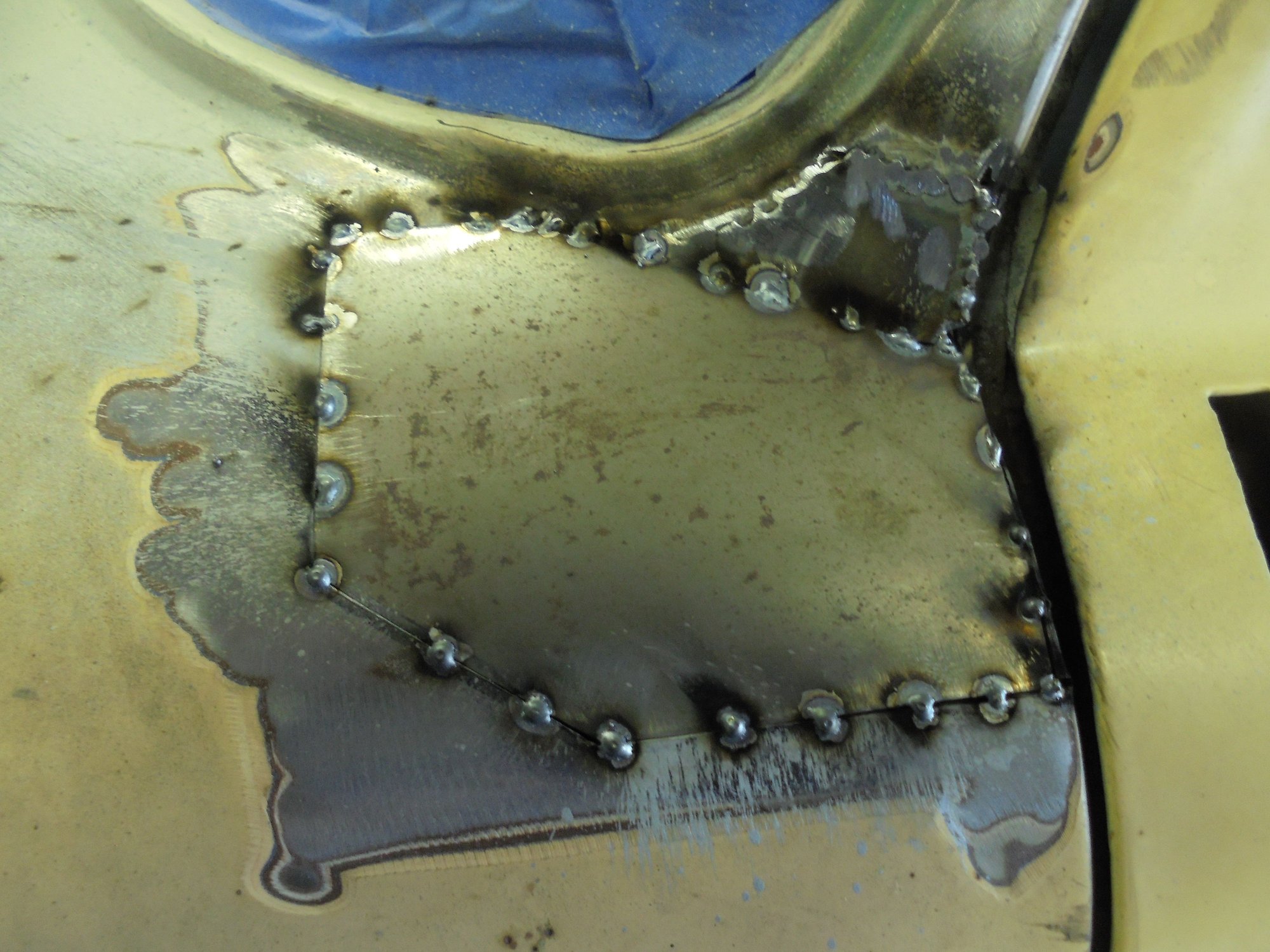

I reckon that brings it up to current. The NextBigThing is getting the floor of the bed cut out, and re-installing the bed onto the truck to get the wood plank floor figured out. Once that's done, and the front windshield in re-installed, I reckon I can get it registered and insured!

Thanks! I think at sometime in its life, it got into a bar fight and got its front teeth knocked out. Who knows?
So, i made "false teeth" from some aluminum sheet I had on hand.
Not perfect by any means. But no money was spent. I could not justify $800 for a new one. Not for as homely an old girl such as this!
