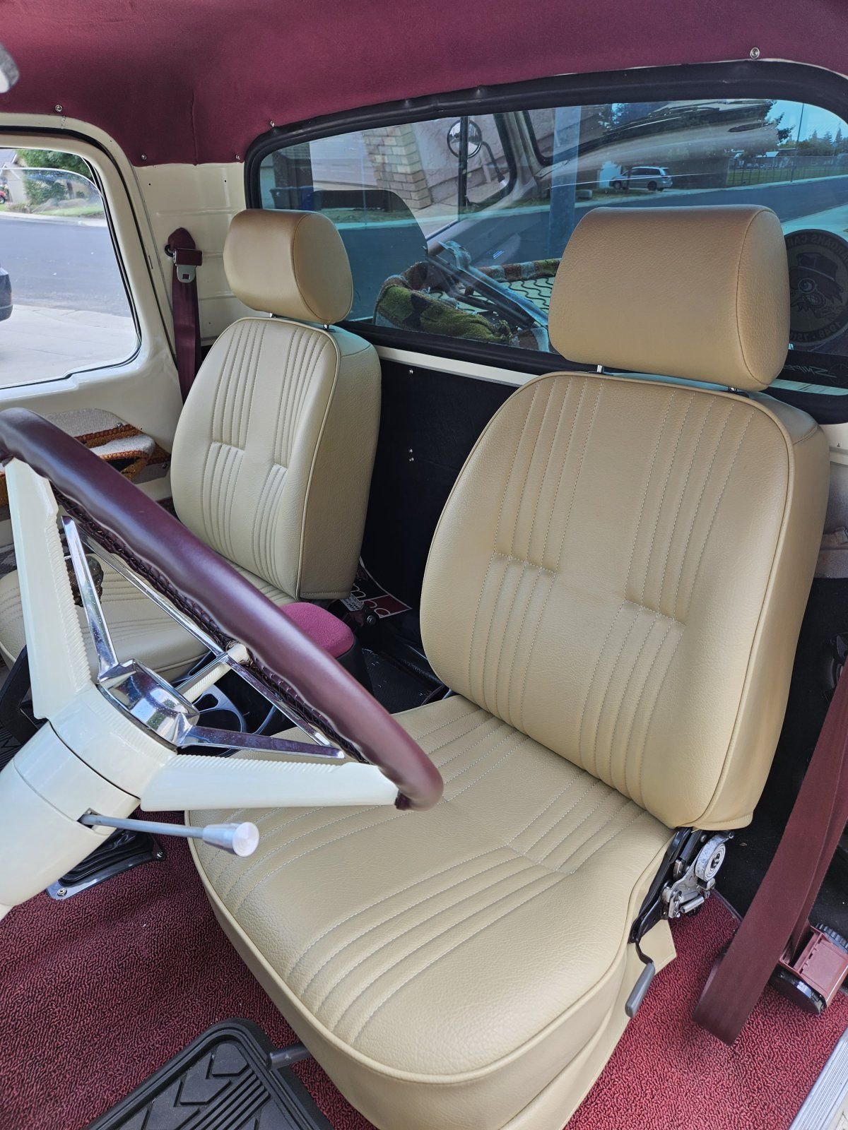

That also showed that although the mexican blanket bench seat was OK for short trips, but on longer trips, it just wasn't cuttin' it. So I installed Scat ProCar buckets. I had to make my own seat adapter bracket. Big improvement in comfort and far less expensive than the TMI custom bench, or even having my bench professionally rebuilt. I also made a center console to go between the seats that can fold up to act as a center seat for young uns.

Looking very nice. The seats seem to fit very well. What type of carpet?

Its an ACC kit that I bought on Amazon. Surprisingly for less money than going direct, and free shipping to boot!

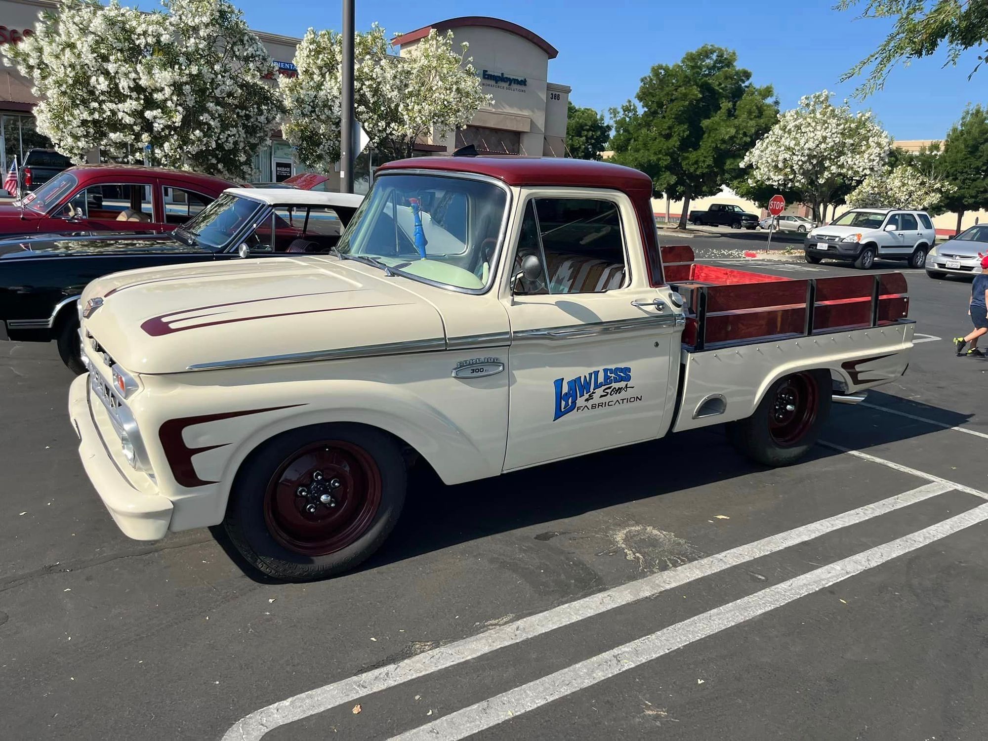

Here's Ol' Furd on the return trip at Casa de Frutta

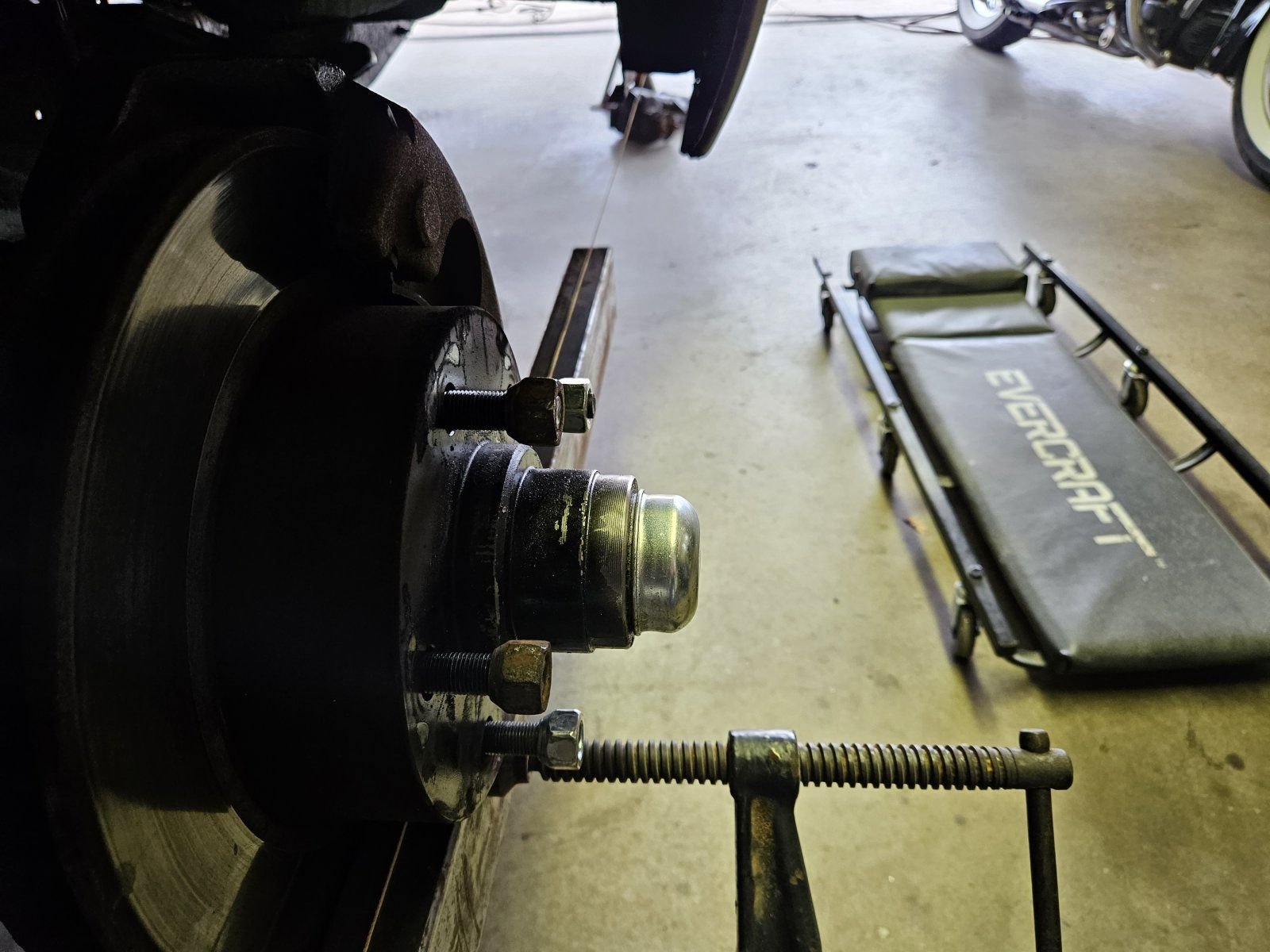

Everything underneath is buttoned up and I used a couple pieces of box tubing clamped to the brake rotors to set the toe. I also ran a string line back to front to center the steering
