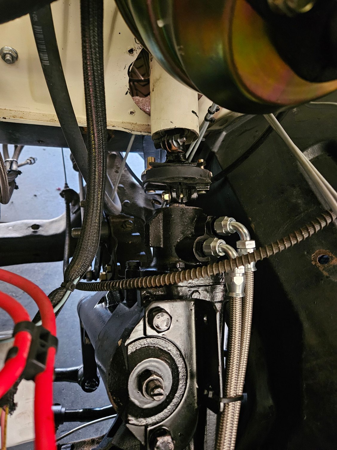

Well, I got the Ol' Furd's power steering conversion finished....I think.
I can't say I'm pleased with the result. I used all new components A to Z. Saginaw box, Saginaw type 2 pump.
Maybe it just needs to get all the air worked out....I don't know. It has some tight spots, particularly from the neutral or "straight" position.
I've cycled it lock to lock a dozen times with the wheels off the ground. It doesn't make noise, it doesn't leak, nor does it puke fluid out.
A lot of stuff I've read says it takes a bit of time, some stuff says vacuum bleeding is necessary, and one post said that the guy changed boxes 5 times and finally found that bleeding it required having the box unmounted and tipped on end. But the was a 78-79 unit with fluid fittings under the unit rather on top.
So, anyone who has done the conversion, what was your experience?

Looking at your pictures that looks like a Ford box and not a Saginaw but no matter it sounds like the sector adjustment is a little too tight. Did you check the over center torque before you installed it? I have rebuilt both Ford and Saginaw boxes and never had a problem bleeding them. But I always filled the housing with fluid before I put the sector shaft cover on. If the mesh load is too tight on the sector it can totally lock up when it gets hot. When you bleed it, you never turn it lock to lock. If you don't have a chassis manual that covers that box let me know and I will scan a page from one of mine. Any 70's manual car or truck covers both those boxes since the difference in them is just the length of the sector shaft.

Thanks. No, I didn't check the over center torque. I pretty much just followed installation instructions from the supplier. Most of it had to do with making sure the system was clean.
Then turning the motor over to get fluid pumped through, refilling the reservoir until it stay full, followed by turning the steering wheel lock to lock with no weight on the wheels.
I have no manual.

I will get a manual and scan the part on checking the over center mesh load. You are going to need a beam type torque wrench that will read accurately in the 5-50 inch pound range. May take a minute or two.

Checking sector mesh load
Here is a page from the 72-car manual the procedure is exactly the same for cars and trucks. Reason I picked the car manual is it is only 3/4 inch thick, and the truck manual is 2-1/2 inches thick probably because they didn't put 10 speed Fullers and tandem axles in cars.
If it happens that the mesh load is too tight you will need to back off the adjuster screw then go under the truck and bump the sector shaft up with a rubber hammer. Reason is the teeth on the sector shaft are tapered and the father down they are pushed by the adjusting screw the tighter they engage the piston, and the sector may or may not move up when you loosen the screw without giving it a little bump.
