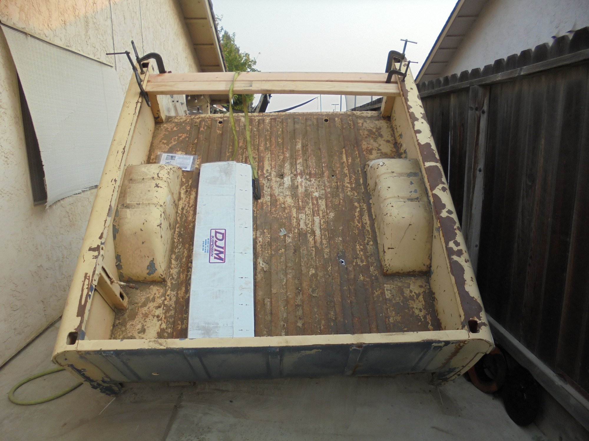

The hole saw worked perfectly! Had the rear bed bolts out in seconds after doing that.
So now, the bed is ready to lift off. I just had to do some rigging so it can be lifted with my cherry picker. So, by Saturday morning....the bed will be off, and the rear frame section can begin the cleaning process. Yay.

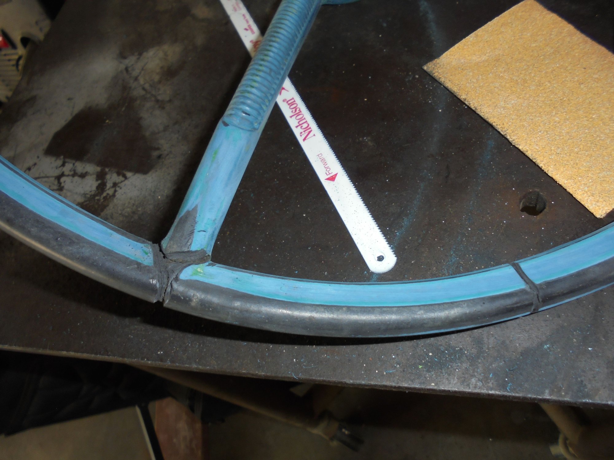

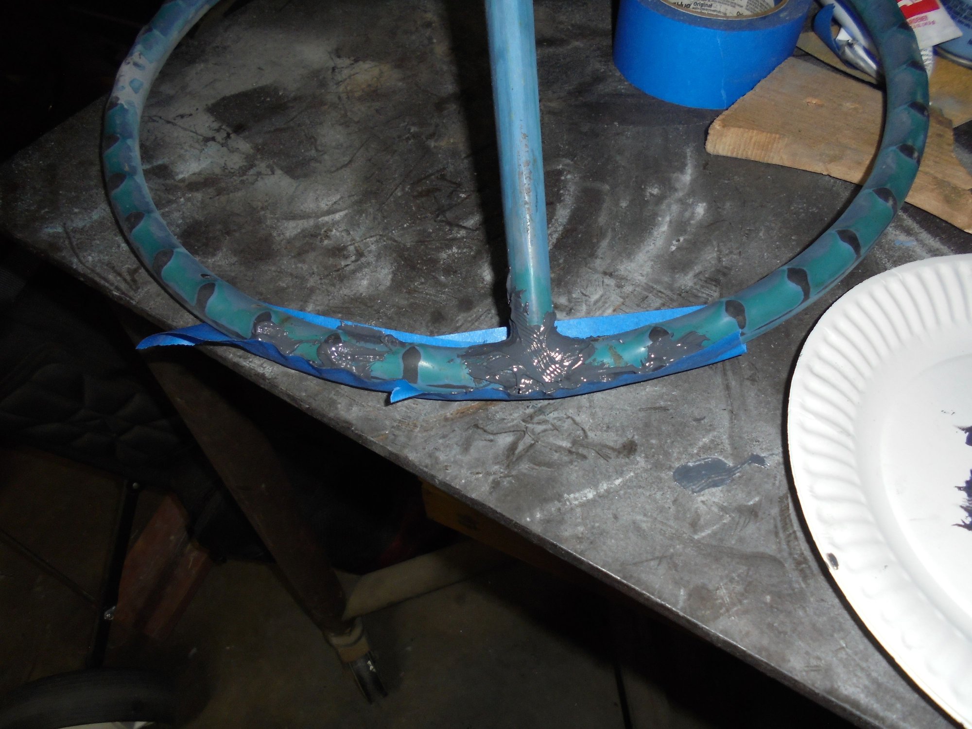

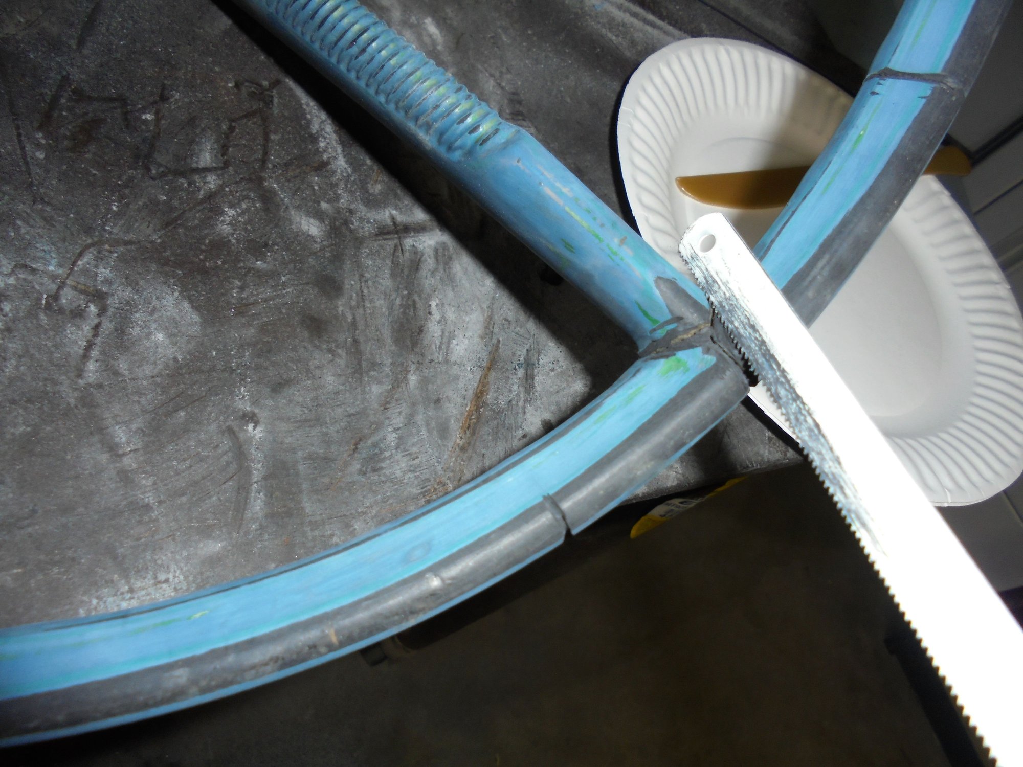

Lots of good progress the last few days. I had to wait for the weekend before lifting the bed off, so I started on my steering wheel. Original wheel had several coats of paint. It looked to be originally blue. Over that was a metallic green, and then black. Of course there were cracks. I used a hacksaw blade to cut open the cracks and get to clean material. Then filled that with epoxy. I found that a flat, half round and round file worked the best to get the filler epoxy cut to shape. The column has already been stripped and primed.
Soooo....I just need to decide which way to go color-wise. Wimbledon white wheel and column with dark red interior metal, or the other way around. Decisions, decisions!

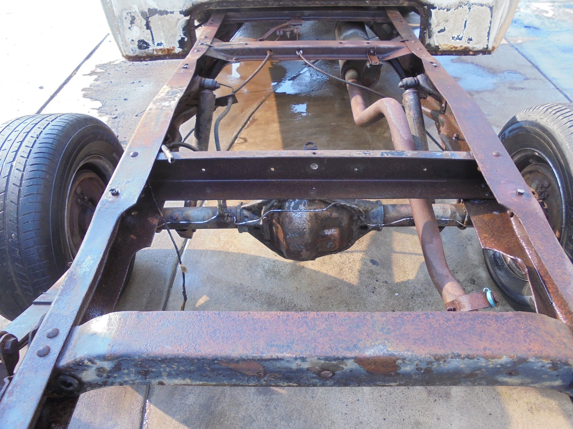

Saturday morning, the bed finally came off. Just me all by myself. An old coot with a cherry picker. Without much room behind in the area where the truck is, I just lifted it high enough to roll the truck out from under it.

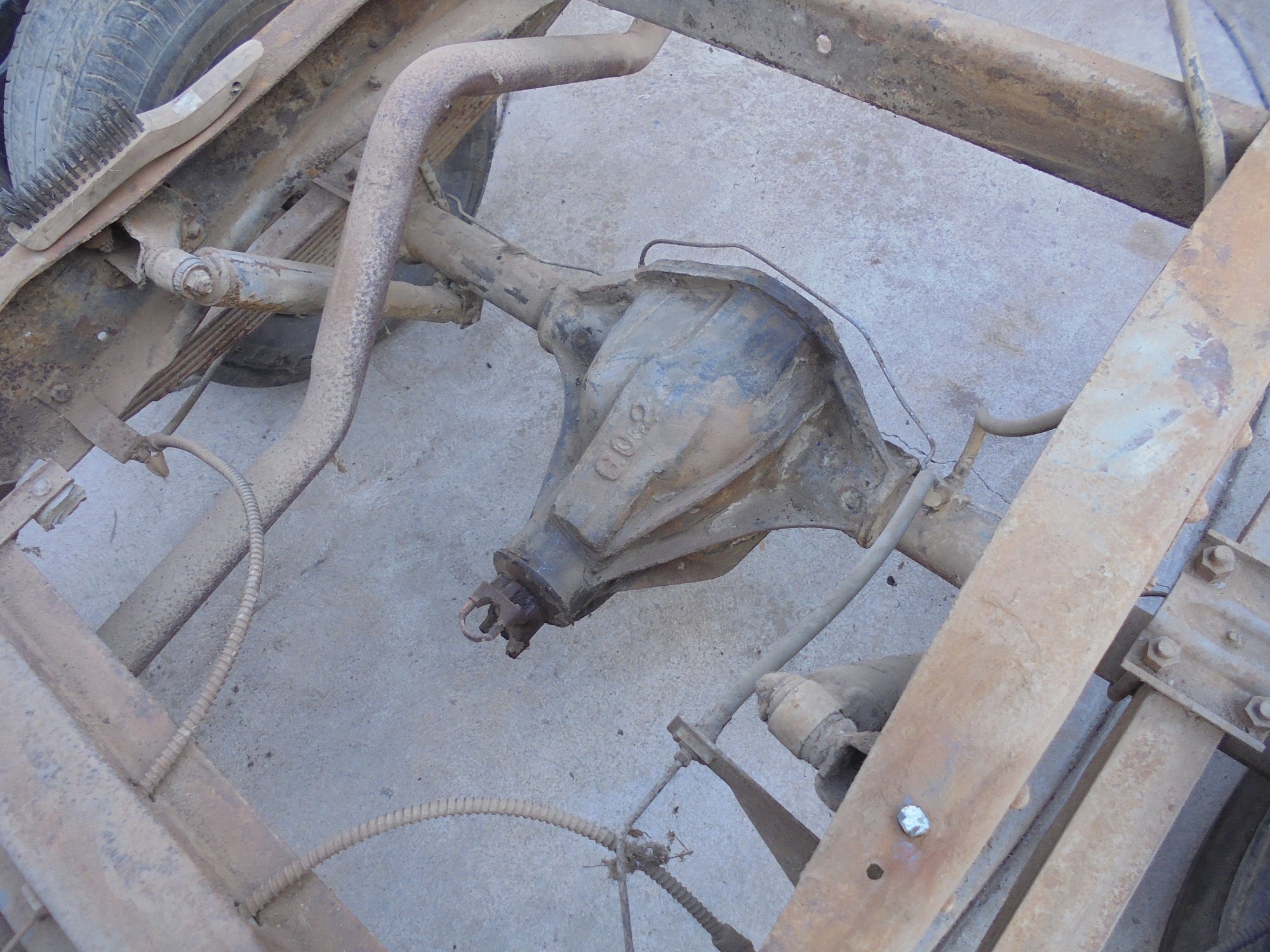

Now that the bed is off, I commenced to scrapin' dirt. Lots of dirt. Twenty -two pounds of dirt. Yep. I weighed it.
After getting the thick stuff scraped off, I fired up the pressure washer and got after it.
After it was all hosed off, I was very pleasantly surprised! Light surface rust on the frame, and what I though was thick chunky rust on the rear -end housing and springs, was just caked on dirt! So the rear end housing doesn't need to be sand blasted after all. But I still have to take the leaf springs in the get the bushings replaced. I'll drain the rear end still, replace seals and axle bearings anyway.
Cutting out the crack
Taped to keep the epoxy in place
Dirt pile

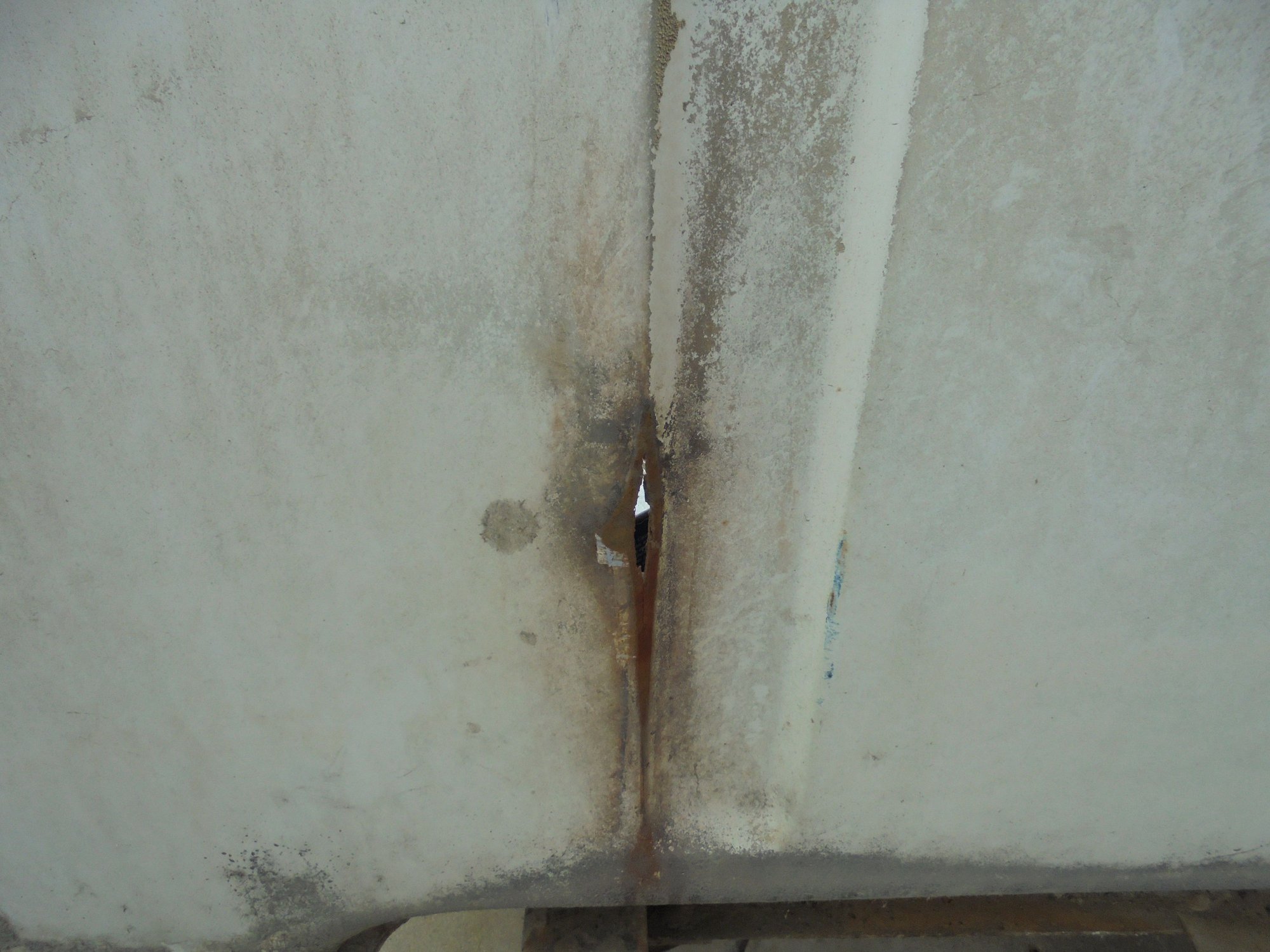

The front of the bed actually rubbed a hole in the back of the cab.
Dirty
Clean!

Looking good, that frame seems to be missing some steel behind the diff right side especially. Maybe that is factory?
Old Sep 26, 2021 | 07:35 AM
MikeyLawless's Avatar
MikeyLawless
Joined: Jul 2021
Posts: 486
Likes: 174
It's cut out a bit on both sides, and on the right, it's been bent up. As if it rolled over a big rock or something. I'm gonna check the back end of the rails for level to see if it needs to be straightened. Depending on how I'm gonna mount the gas tank.

Finished crack repair on the steering wheel, and got a coat of filler primer on it. A few minor blemishes to work out, as can be seen in the close-up of the spoke-to-rim joint, then the wheel and column can be painted.

Nice work. What did you use for epoxy?
Old Oct 3, 2021 | 05:13 PM
MikeyLawless
Joined: Jul 2021
Posts: 486
Likes: 174
JB weld.
I know JB weld gets bad reviews. But I've used it for a lot of different things over the years, and it's some of the toughest epoxies out there. Like most things, it's all about the prep.
Anyway, a few rounds of high build primer and sanding, and it'll be ready to paint. Column is ready to paint, so I can do 'em both at the same time.

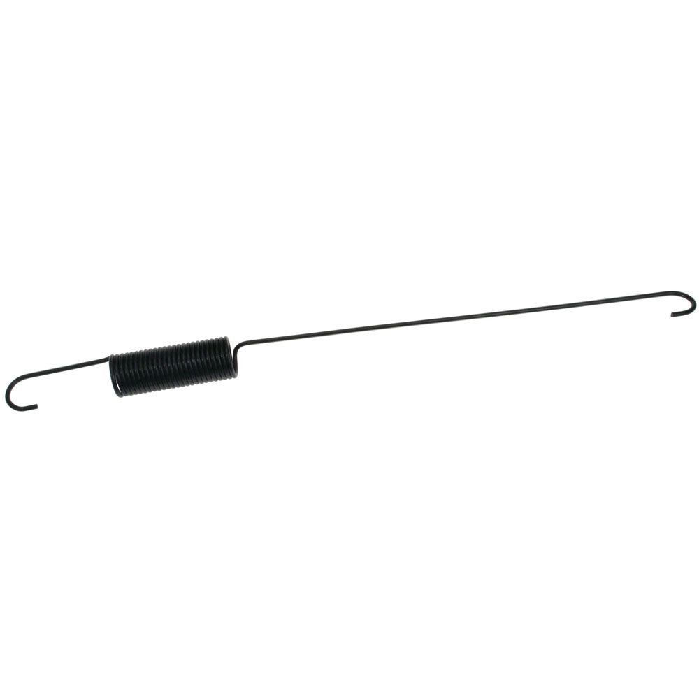

Great work Mike I am impressed. I wanted to ask where the E-Brake return spring hooked to and how long was the spring. Mine was missing and I tried a couple, but I am still not sure.
Thanks Steve

Mine is missing too Steve. I wasn't even aware it needed one till I was looking at catalog pictures. It looks like it connect to the end of the arm, and then to the crossmember. I'll have to look to see what the length is supposed to be. It looks like the photo with one long leg, but I'd bet cash money any garden variety hardware store spring would work!
