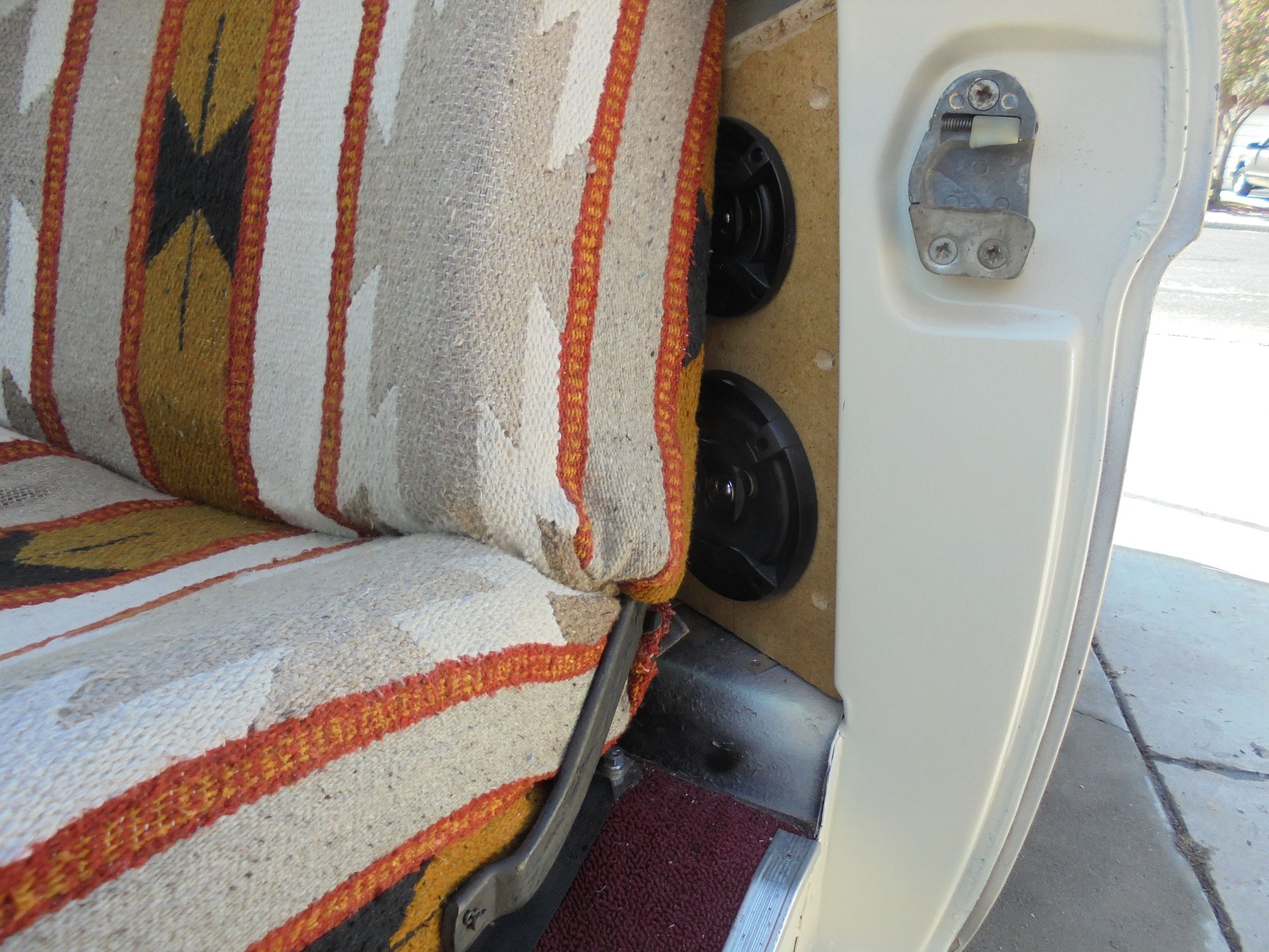

Radio install nearly complete. It's up and running. This is in no way a high end system. **** Chung radio with Kung Pao speakers (actually Pioneer....same difference). At least the radio has bluetooth, so I can either listen to radio stations or music from my phone. I also put the dome light in it. The overhead console is made from MDF particle board panels, screwed and glued together, shaped, primed and painted.
This truck never had a radio put in the dash. I was looking at putting in one of retro radios that look period, but have all the modern gizmatronics....until I saw the price. Nearly ten times what I paid for this Amazon special head unit.
The rear speaker enclosures were also made from MDF. Tucked nicely into the corners. The enclosures and the rear of the cab will be covered in that fiber speaker carpet material.
Next up will be finishing the framework for the headliner shell which will be laid up in fiberglass and covered with either late model style headliner fabric, or the same type of fiber carpet material I'm using for the speaker boxes.

As far as being able to adjust, the big **** is volume. Easy to find without looking. Answering a phone call is something that will need some practice as to where the button is. But, there's also a little remote that does quite a bit. But I'm not all that particular about ultimate sound quality in a vehicle with as much ambient noise as O'l Furd! Once I get treble, bass and balance adjusted, I doubt I'll touch anything but volume.
Also, my drag race car has the main switch console overhead like this. So it's kinda second nature now
