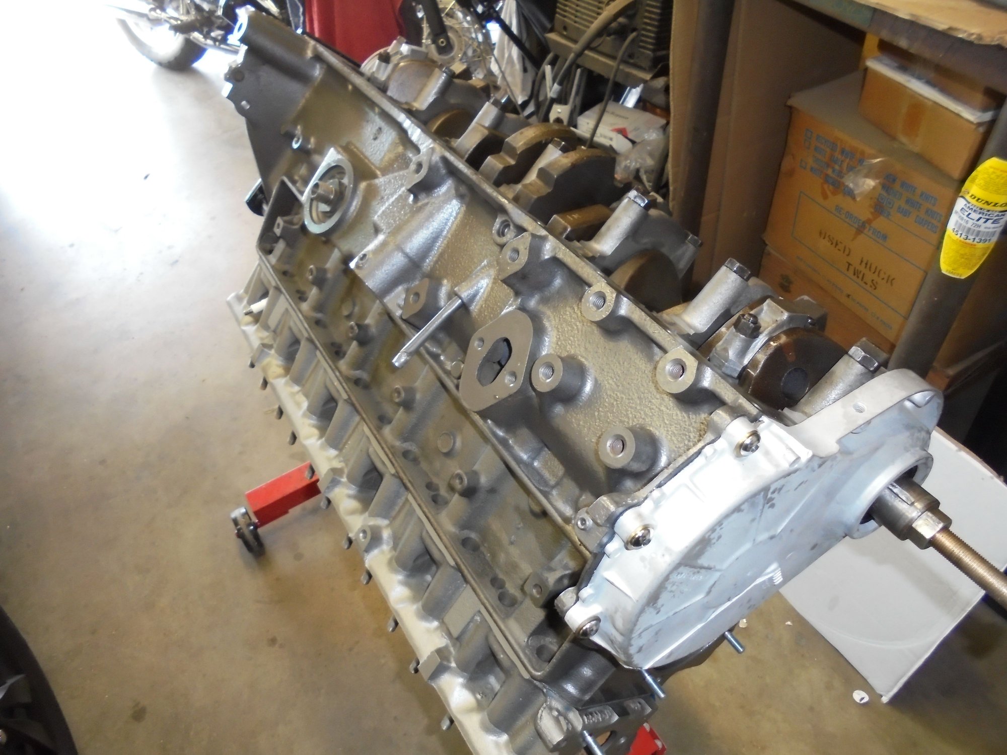

Suspension and brakes are nearly done on the ol' F100. At least enough to put wheels on it so it can be rolled out for easier access. Cleaned and scrubbed the firewall in preparation to put some paint on it before the motor goes back in.
Also cut a section out where the original wiring pass-thru was for a modern wiring plug. You can see the rectangular hole just to the right (left) of the master cylinder mounting area. I'll weld in a patch panel and cut a single round hole for that
Kinda surprising to see how thin the paint was on the firewall. It's no woonder rust was such an issue. Scrubbing it with degreaser and coarse scotchbrite went thru the paint straight to metal....no primer.
Just about done with the motor. I should have checked the oil pump pick up earlier. I had it soaking in cleaner, and after I rinsed it out, there was still a bunch of crud stuck way inside. So sense in risking new bearings on a $20 part, even though it takes a few days to get. So, I'll have to wait a bit to close 'er up.

I'm at a stopping point on getting the motor completely buttoned up because nobody locally had a oil pump pick-up for a 300 inline 6. Unimaginable!

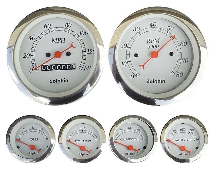

These are what I'm planning on using. I found 'em at EZwiring, where I bought my wiring harness. Look like good no nonsense gauges.
There'll be three indicator lights, L & R turn, and hi beam. Switches under the panel will be minimal too. Other than the key switch on the left, there'll be the light switch, wipers, and a USB port. The other holes will be filled.
The Vintage Air unit for heat and air look to have the controls on the under dash unit, so no need for a heater switch on the dash.

I am running the Dolphin gauges too, 5" quad, tach and gps speedo. I have issues with the quad and speedo gauges as they do not light up. May have to improvise as the seller does not care to help. Purchased on Fleabay.

Hmm. That's odd. Do they have a standard light socket in the back?
The six gauge set looks like it does

A customer of mine has the Dolphin gauges installed in his Skylark and said he is pleased with them for what it's worth. Nice work on the dash Mikey, and I'm jealous of your garage, even if you have to share it with the laundry.

On the gauges, I was second guessing my choice for a while. I really wanted the Stewart Warner Green Line gauges. But they are out of stock with a vague delivery date, much like a lot of stuff. The $6-700 price tag was an eye opener as well. The Dolphins, at less than $250 I think are worth the gamble.
