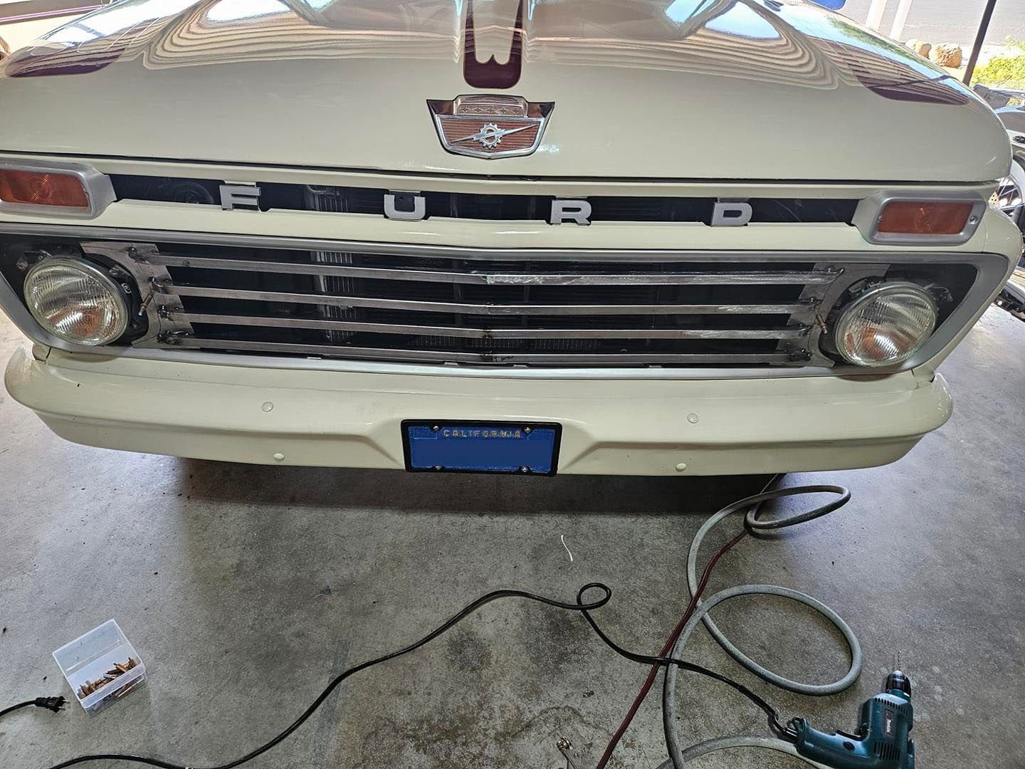

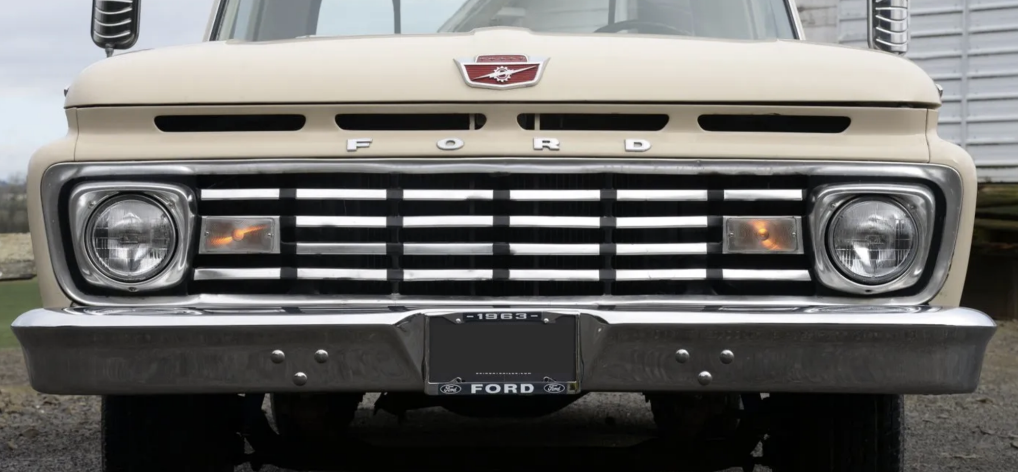

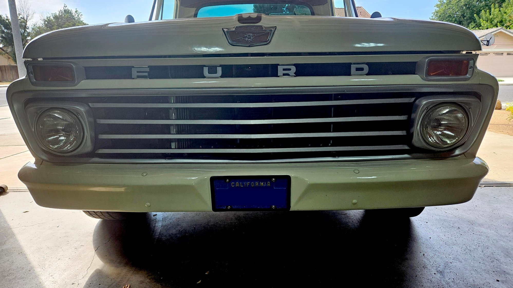

On to the next refinement. Strictly aesthetic. But, it's been buggin' me since I got Ol' Furd on the road. In a photo below, you would see the section of grill that a previous owner had cut out. Cam swap? I dunno. I kinda scabbed it back together with pieces of aluminum, pop rivets and epoxy, then painted it. For a driver it was fine. But, it's been on my mind ever since. Yes, repop grills are available. 1966 model style. Which is fine, but at well over 800 buck plus oversize shipping...too rich for me. Used ones pop up occasionally. But I haven't seen one local for less that $300, and even those need work.
So, for $50 in materials, and about 15 hours of my own labor, I have something I think is nice. I used a 1963 year as a reference.
I used the existing perimeter, and built an inset from 16ga (.065" wall) steel tubing, then painted it to match.
Behold the result...
Photo Captions.....Before and the 1963 reference. Note turn signal in the grill. I didn't change the signal location to match the '63 grill. Nor the black lines breaking up the horizontal bars.
This is the way the grill was when I got the truck.
(above) This is the way the grill was when I got the truck.
This is the model I used to plan the new grill
(above) This is the model I used to plan the new grill
(Above) The new grill as delivered!
(Above) The grill roughed out
(Above) No turning back now!
(Above) First fit up
(Above) The completed project
