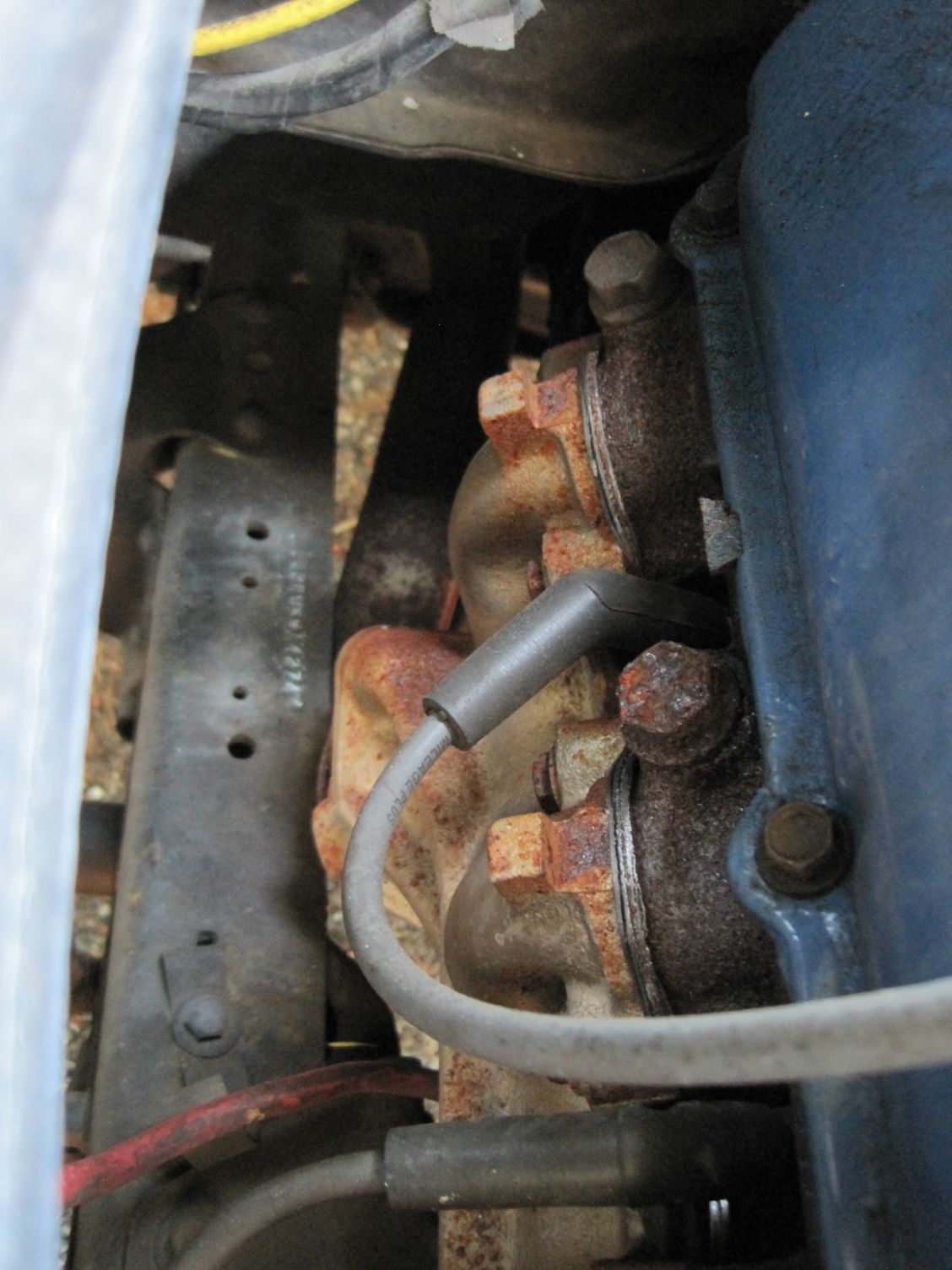

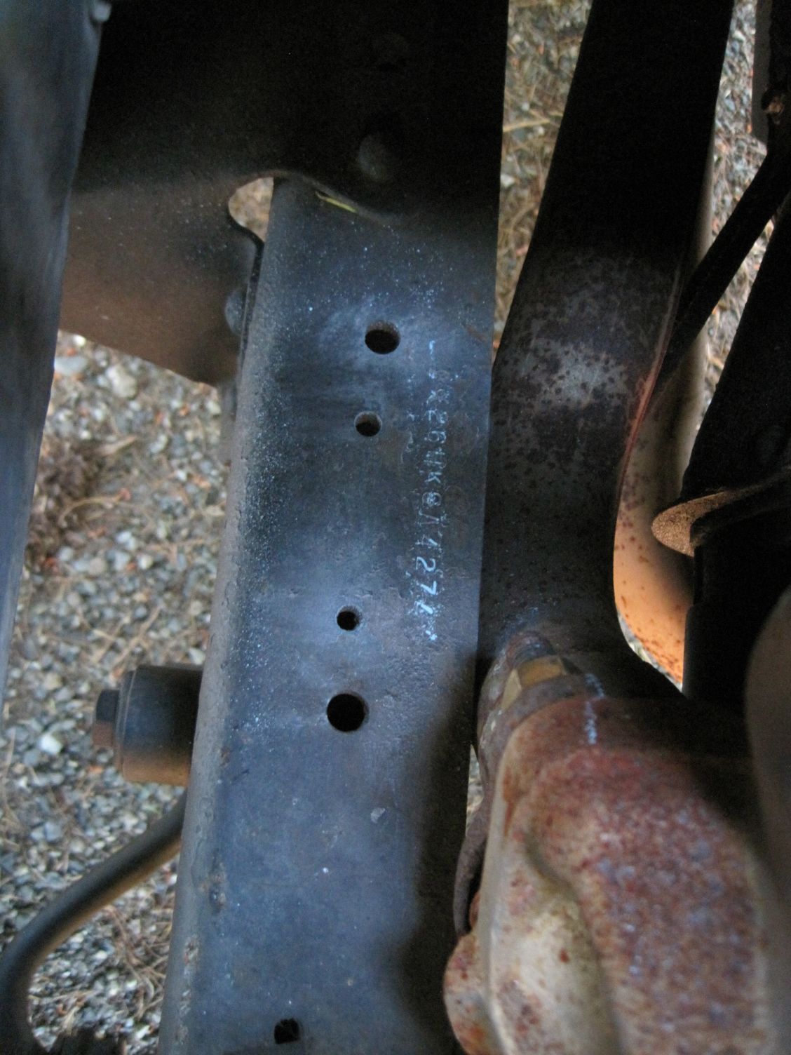

I have a '76 F-100 LWB RWD whose frame-based VIN is difficult/impossible to read in its entirety. I can read four of the eleven characters. I believe that there is also supposed to be a star character before and after the VIN. I'm referencing the one that is easiest to find and see, the one that is on the frame just below where a V8 alternator would be. There is another one on the top rail of the frame underneath the cab but that is inaccessible to me right now. These are both on the passenger side.
The problem here is that to get a Florida title, I will need to get a Florida law enforcement officer to eyeball the VIN on the frame and fill out a form attesting to the VIN. Removing the cab is no guarantee that the VIN under it is any more legible. The truck was previously registered in Georgia which doesn't issue titles on vehicles produced prior to 1985.
One solution that has been suggested to me is to get a die stamp set and use it to better bring out the VIN. Re-stamping the letters and numbers. This sounded rather dicey to me since I'd need to match the size and font of the numbers and letters of the VIN. I could make it worse.
Has anyone here faced that problem and come up with a reliable solution? If so, how did that work out for you?

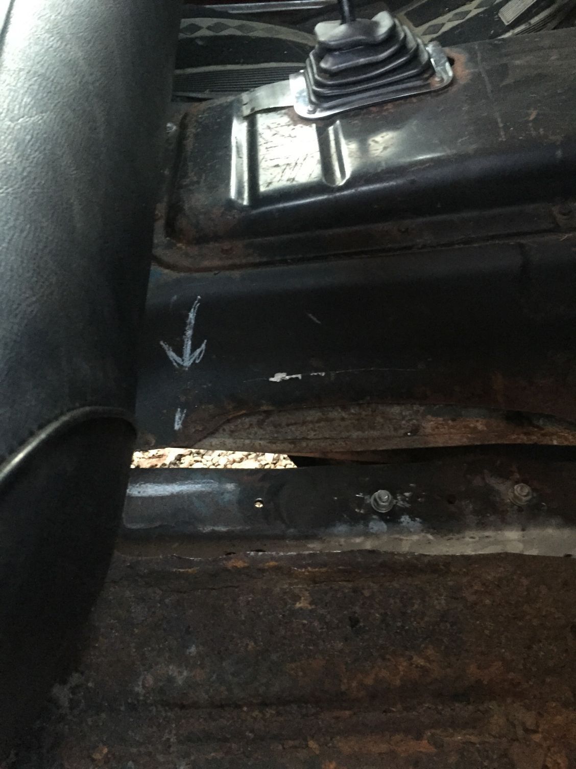

I know this sounds crazy, but it you are going to be replacing/ pulling the cab someday...you can cut the floor to get the frame vin under the cab? I know crazy, but you would not have to cut out as much in the pic. The 2 nuts are the cross members bolts.
I know you know, but this is for the masses. Red box is 4wd vin location along with aft one.
4WD
I have a 76 F100 2wd parts truck, I am willing to cut into the cab to get you the exact spot it is located at.

I only get to touch this truck one week out of 4/8 weeks when I visit my old place in Georgia. After scrubbing it really well with a rotary wire brush and not being able to see all of the characters I sprayed some white enamel over the area. It should be dry by the next time I see it so I plan to go after it with a sanding block and 400 grit wet paper to see if that helps. The engine and trans are out of it so doing the mirror thing with the second VIN location might answer the question of whether removing the cab will do the trick. I would be loath to ask a uniformed LEO to crawl under a truck and reverse the images they see in a mirror. Maybe there is a remote camera solution for this?

Ever try raising a stamped number using a piece of white paper and pencil laid over on it's side. ... after cleaning the surface well.

The paint and sand trick works pretty good as long as the stamp impression are clean before the paint goes in. Wrap the sand paper around a flat hard surface (sanding block). Or use a foam backed sanding block. That trick works on the harmonic balancer timing marks too.

What I did was to cover the number with a piece of rag and keep it soaked with evap-o-rust for about a week. It's still a bit pitted, but you can read the numbers.

I had the same issue on my wife's 65. You can see all the digits and the stars on hers, but the last 5 digits are VERY faint. If I was trying to read it outright instead of match it to the known number on the title, I don't think I could have. My solution when I went to the DMV is I offered to read the numbers while she verified it from the title. She took a look at a very old, dirty truck and opted to stay clean for the rest of the day. I didn't tell her I had memorized the number... and it worked.
To prevent future issues, I got one of the super fine engraver pens and used it to carefully enhance the numbers. I was not trying to make them as deep as new, just make them a bit more obvious. It came out nicely without looking like a forgery. Once I repaint the frame it will be impossible to tell that what was done, but it is kind of obvious unpainted, due to the nice shiny metal. I don't recommend trying this technique unless you paint the area a dark color then rub a white crayon over it. I hope they would accept that you are trying to make it easier to read and not squawk about painting it.

Plain white vinegar does the same, then wash off the residue and hit it with a wire brush or wire wheel on a grinder. Now not to heavy with elec powered grinder wire wheel.
