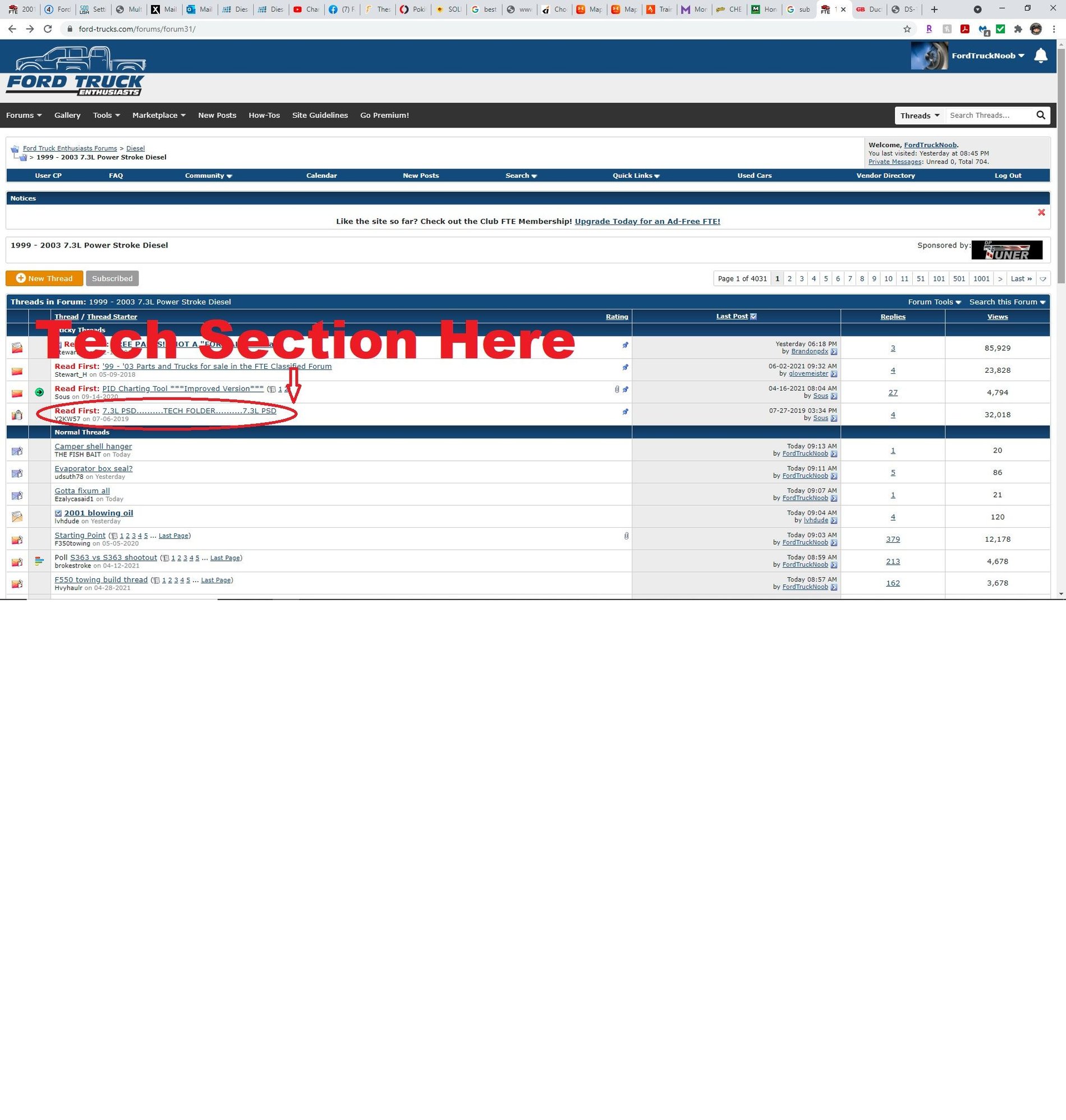

OK, so I didn't see a "tech" section, I'm sure I'm not looking in the right place. I have no idea what a dongle is, or what I need to monitor an "app".
Is this something a parts place like Auto Zone could check from the OBDII port?
Old Jun 15, 2021 | 09:18 AM
FordTruckNoob's Avatar
FordTruckNoob
Joined: Jan 2005
Posts: 13,111
Likes: 4,716
From: Henderson, NV
Click here to go to Tech Folder.
