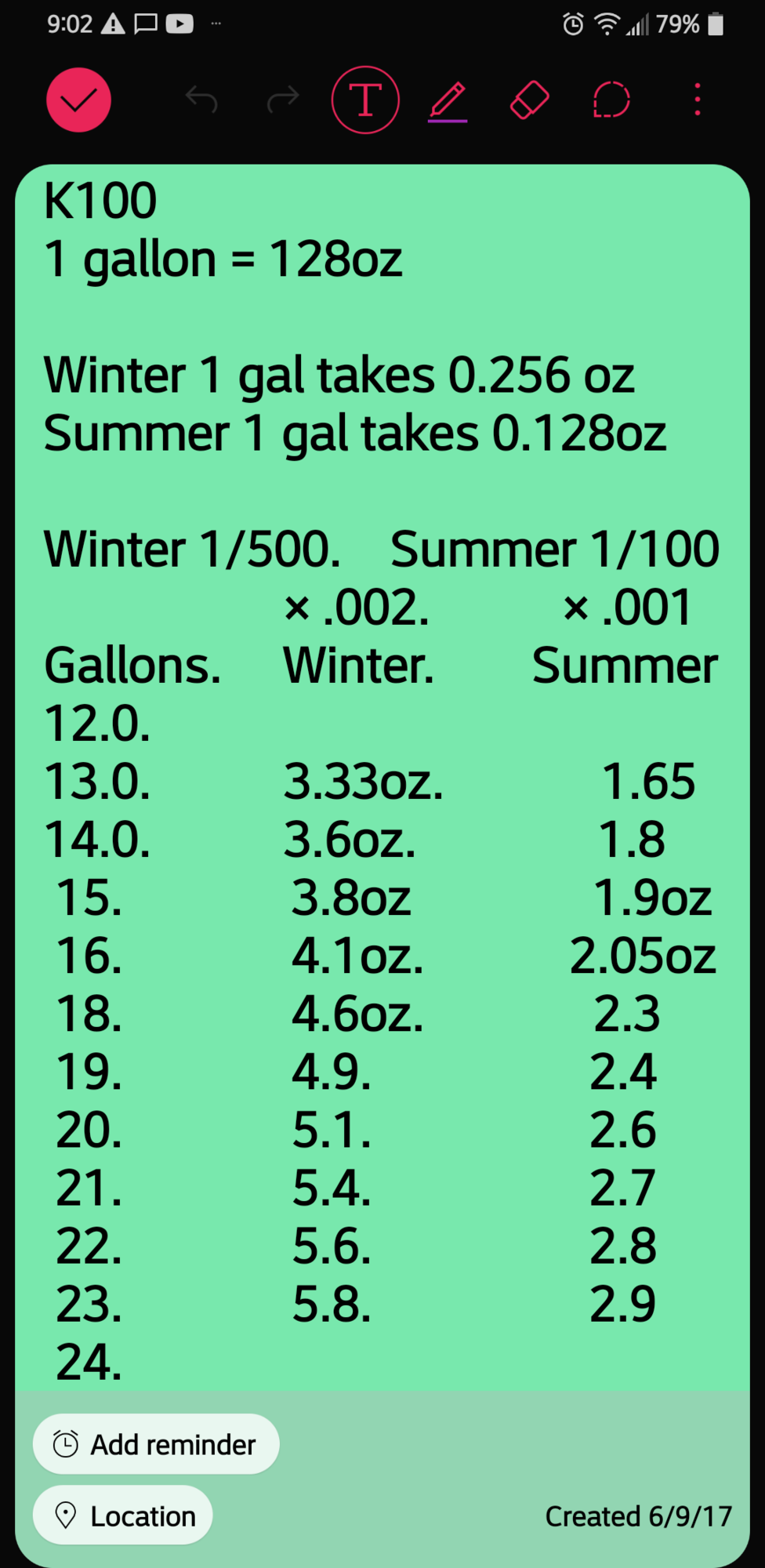

Thanks for posting. I remember seeing an older document with the same name on it but I don't think it was that. I'll try to see if I can find it and post here.
I use an old Stabil bottle for dosing. Without having no where else to store it, I keep it in a plastic ziplock bag but open to prevent a little getting on my Carhardt cover. Believe it or not, it doesn't stink up the cab... At all. The bottle seals great.
Here's the chart I keep on my phone. For amounts less than what's listed, I just guesstimate the amount. You cannot overdose this stuff.
