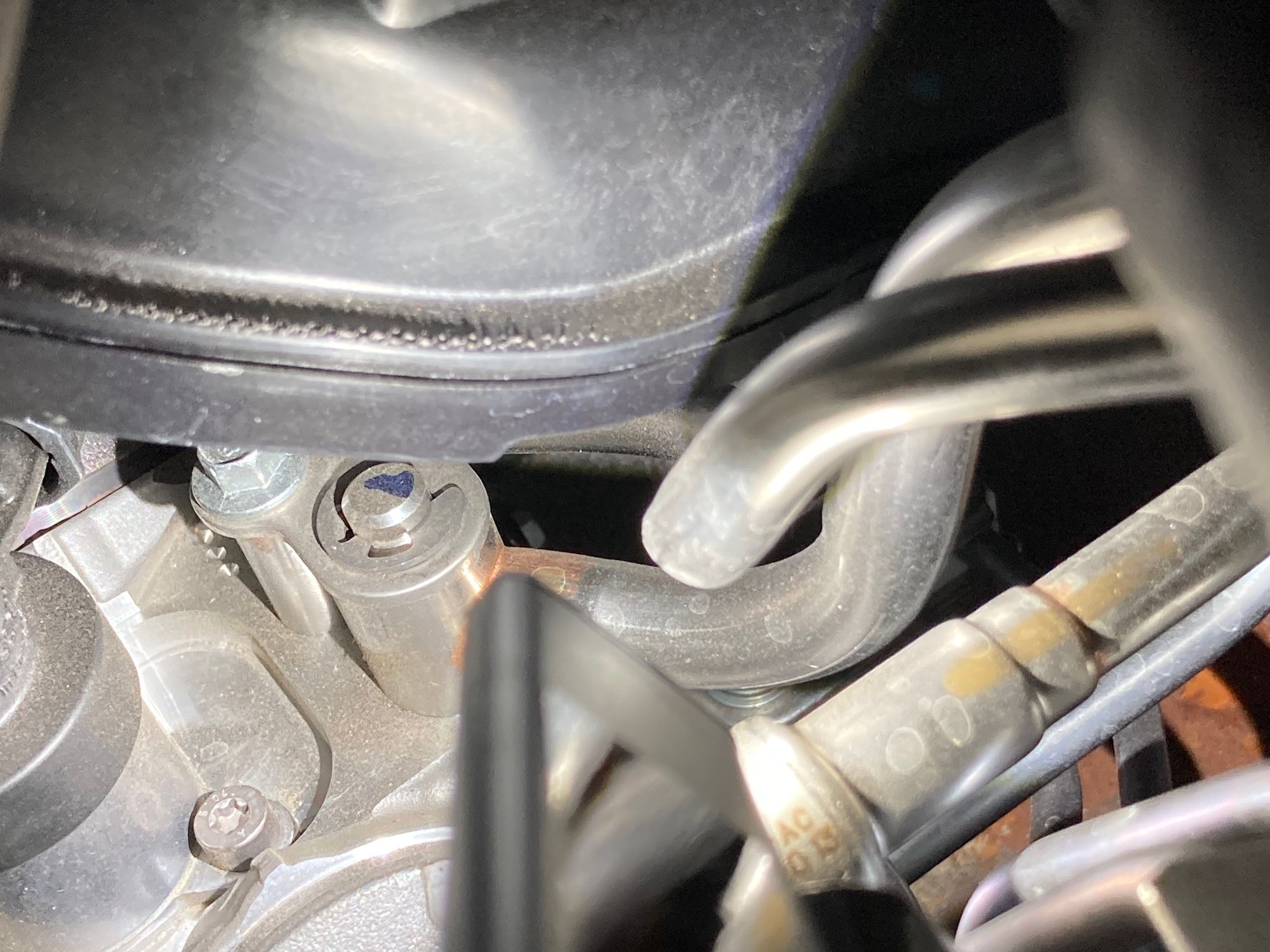

Here’s the best pic I could get of my 2020 CP4. There are 4 small dots.

I tried to look at mine and could not figure out where the dots would be. based upon the above pic I will try again.
