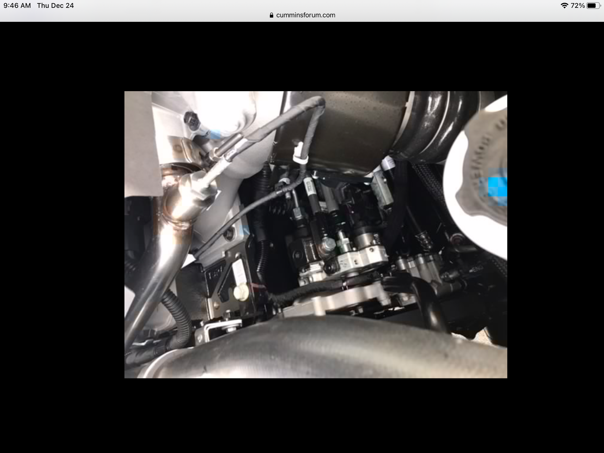

I think it has actually gone beyond rumor.
Over on the Cummins forum, a guy drove this 2021 home yesterday and took a pic
It is a little different than the one in my ‘18; but it is definitely NOT a CP4.
