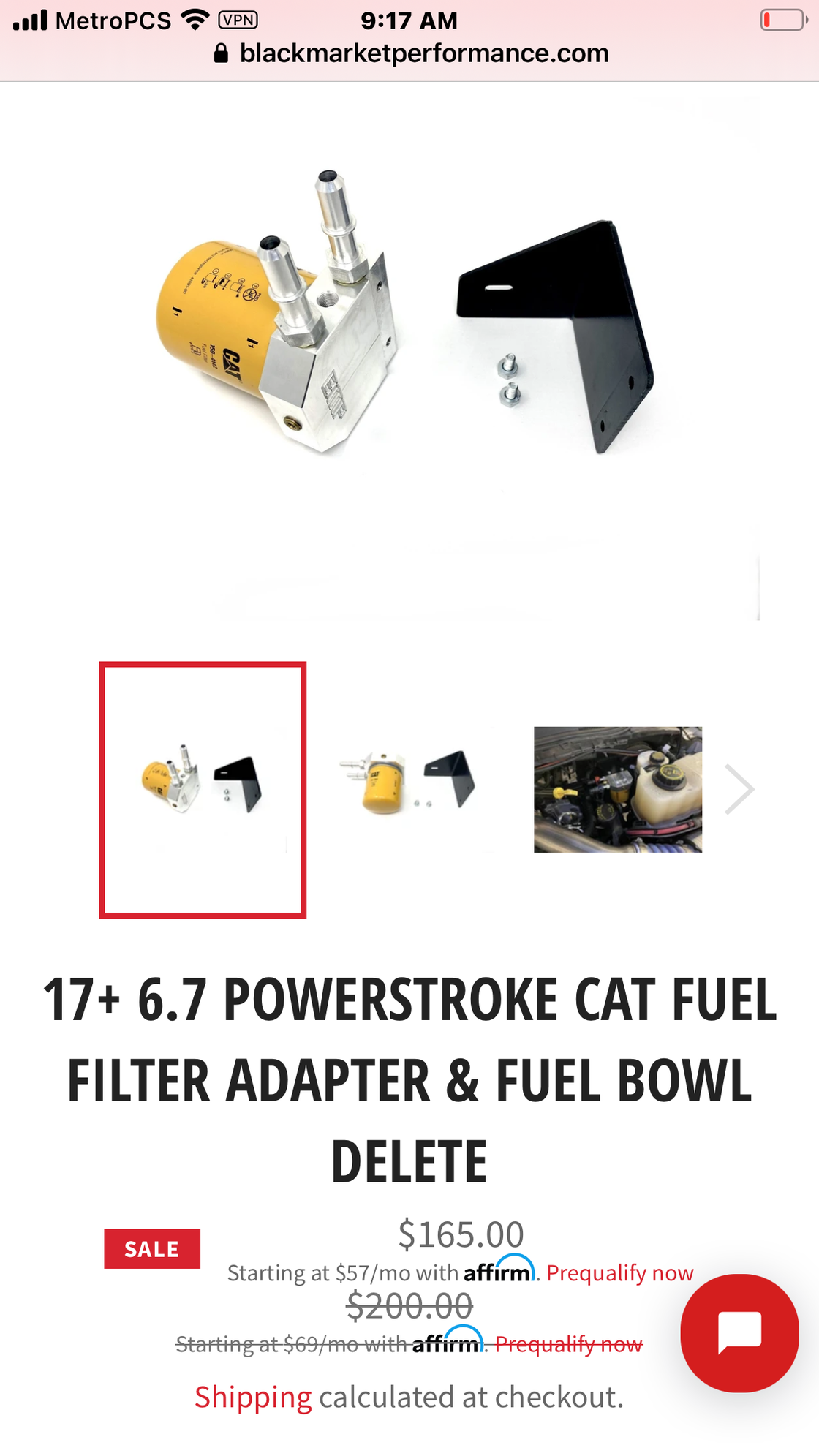

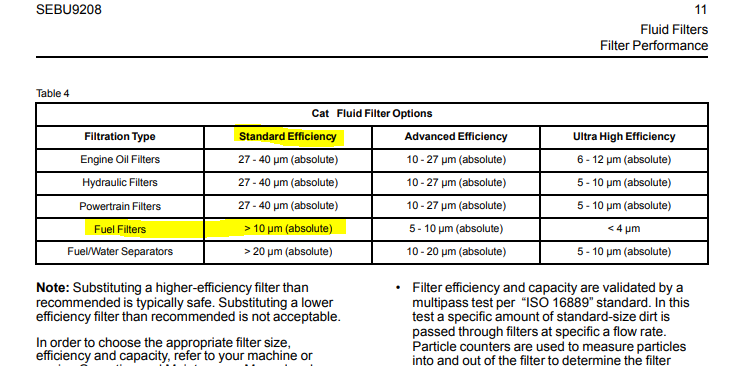

Ok, I got a reply back after I stated the spec for the Cat filter was 2 micron. This is what I got back.
"I'm not sure where everyone keeps getting the 2 micron spec for that particular filter. I have researched the 150-4142 filter extensively, including speaking directly with the CAT, and everything shows it at >10 microns (see my attachments). The correct CAT rating would be a "high efficiency" or "ultra high" rating. The 150-4142 is only "standard" and not intended for common-rail injection pumps or injectors. The factory spec for that filter is 4-5 microns and the Baldwin is a 4 micron filter. "
Here's the pics that were sent:

So the website has false advertisement?
If you want my opinion and the way it looks, probably. But I'm not the expert here. According to those pics, it does look like the 150-4142 filter is not a 2 micron rated filter.
From blackmarketperformance.com filter #150-4142
MAYBE SOMEONE WITH MORE KNOWLEDGE ON THIS WILL CHIME IN IF THIS IS WRONG.

Only thing i have to say is the nominal vs absolute rating.
For example that Baldwin
4 micron nominal means 50% of the time it catches particles of that size or larger
15 micron absolute means 97-100% of the time it will catch particles 15 microns or larger
It's hard to find definite specs on the 6.7 factory filters, hence why I tend to air on the side of caution and only run Motorcraft in my truck with stock fuel system.
