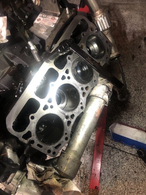

Odd....Here they are! Just pics of me cleaning up the head and block.
Ill throw in the mess I have started too.

I also need to plug the port in the head (I am using 2 pass side heads) Im told they are the same, minus that port for the coolant.
The heads are the same. Fuel ports are 1/8” NPT and coolant are 1/2” NPT. Just swap plugs from the other head(s) you aren’t using.

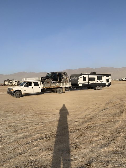

I never bumped this thread. I finished the truck and all in weight was 28k lbs. I had 28k lbs for about 350 miles and 20k lbs (no trailer) for 1900 miles. It towed beautifully. I was on the 14 freeway (so cal) and was able to maintain 65-70 going up the 14 grades.
I stayed in the heavy tow tune. I hit a sustained 30-35 lbs of boost. I will do a longer report soon
