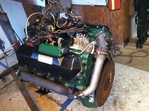

Old Dec 16, 2020 | 01:04 PM
  #89
Hvyhaulr's Avatar
Hvyhaulr
Joined: Oct 2020
Posts: 546
Likes: 261
Got the engine pulled.
Now it is time to start swapping **** over. I think the oil pans are different, the accessories obviously need to be changed over. Wiring harness, HPOP and injectors will be swapped over. I will leave the injector cups alone. I will get a new o ring for the oil pick up and I was told there is actually a special sealant International specs out of the oil pan sealant so I will grab that.
The donor truck started leaking diesel out of one of the tanks so it smelled up the garage and was bad enough to smell up the house. Wife wasnt too happy. I have never had a smell transfer into the house before and it was giving me a headache...So instead of parting it out slowly or letting it sit outside and taking up space I sold the truck for $500, I had so much interest, including one guy saying I was selling it for too cheap. I was shocked that a 97 F250 4x4 with no motor, bed or hood (keeping it for a friend) sparked that much interest for $500. I did keep the IDM as a spare, I have a cold air intake I can sell and some other parts off the donor motor.
So $500 back in my pocket and the truck is gone.
Now it's time to start swapping. I gotta get this thing moving, we cant swing a camper by KOH (end of January) so we are renting a 32ft camper for a week for KOH. Should be roughly 65ft all in with the truck and should be grossing around 25-26k.
I also dropped the trans off at Bowman Trans, he will be rebuilding it, doing a billet converter, swapping in the 4wd output shaft and he has a NP271 on the shelf I will buy from him. I will worry about swapping in my front axle after KOH.
