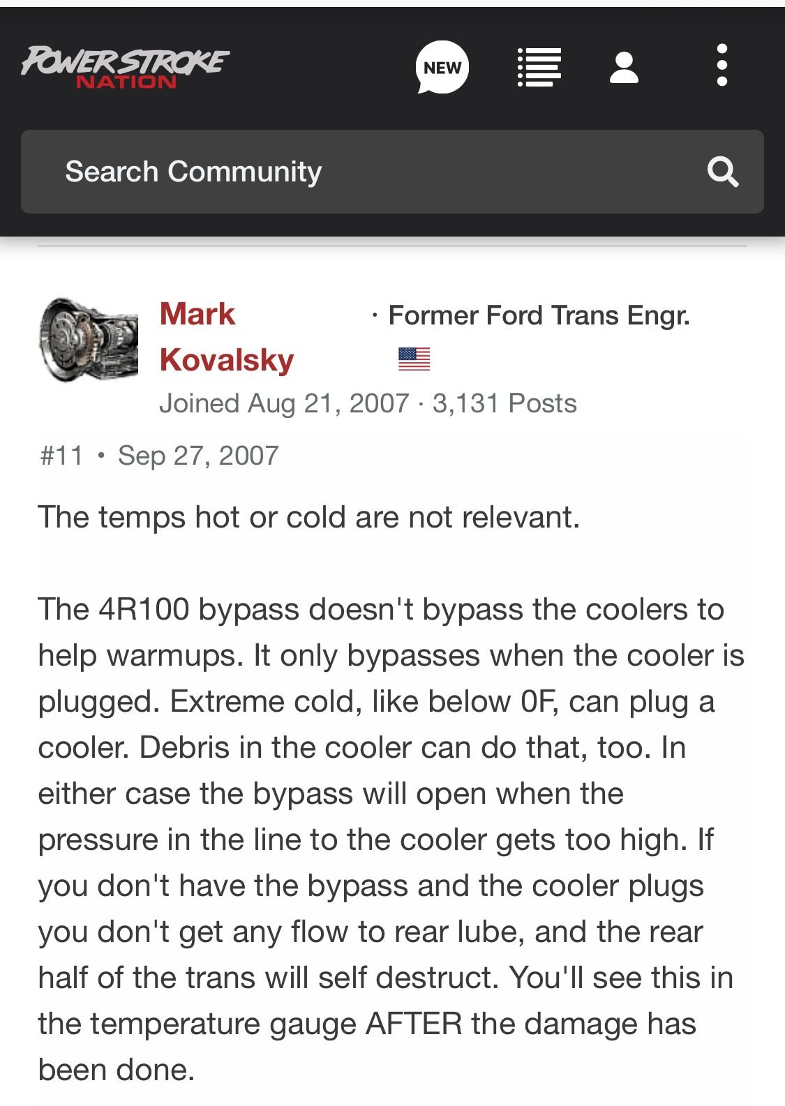

There is a post on this forum from @Mark Kovalsky that said something like "the design operating temperature of the transmission is 180⁰F". That's why a lot of us run one of these..
Running a little cooler doesn't hurt anything. It's just not as efficient as it could be.
Makes sense, Noob. I think I would not be inclined to add one, despite a possible gain in efficiency. I had a similar thought with regard to the Banks diff cover (cooling fluid to below std operating temps).

Makes me wonder about the place that allegedly deletes the bypass.
This “mod” makes me mad on so many levels. I have posted a snapshot of Mark’s statement on the bypass purpose and reasons to keep it so many times on the FB page. And usually no one wants to believe it. Typically I just give up and let them live in ignorant bliss.

The pour point of Mobil 1 synthetic is -60'F. It would seem that there would have to be a lot of other factors going on for ATF to plug the cooler at 0'F. Not doubting Mr. Kovalsky, and not saying the pour point at -60'F doesn't equal a relative viscosity equivalent to an obstruction, just seems 0'F is pretty warm for ATF to effectively present an obstruction.
Mobil 1 will not plug the cooler at 0°F. Conventional MERCON will.

A fluid's properties and performance in cold temps can change once the fluid is imbued with fine particles of clutch lining materials and other contaminants. Heat cycling and fluid shearing can also change its properties. When we are provided a pour point for any given fluid, it is new fluid in the bottle as formulated.
For comparison with the pour point of Mobil 1 previously provided above:
Mercon V Pour Point -54°F (Motorcraft brand, likely produced by ConocoPhillips)
Mercon Pour Point -38°F (Chevron brand, legacy material specification dated 2001)
