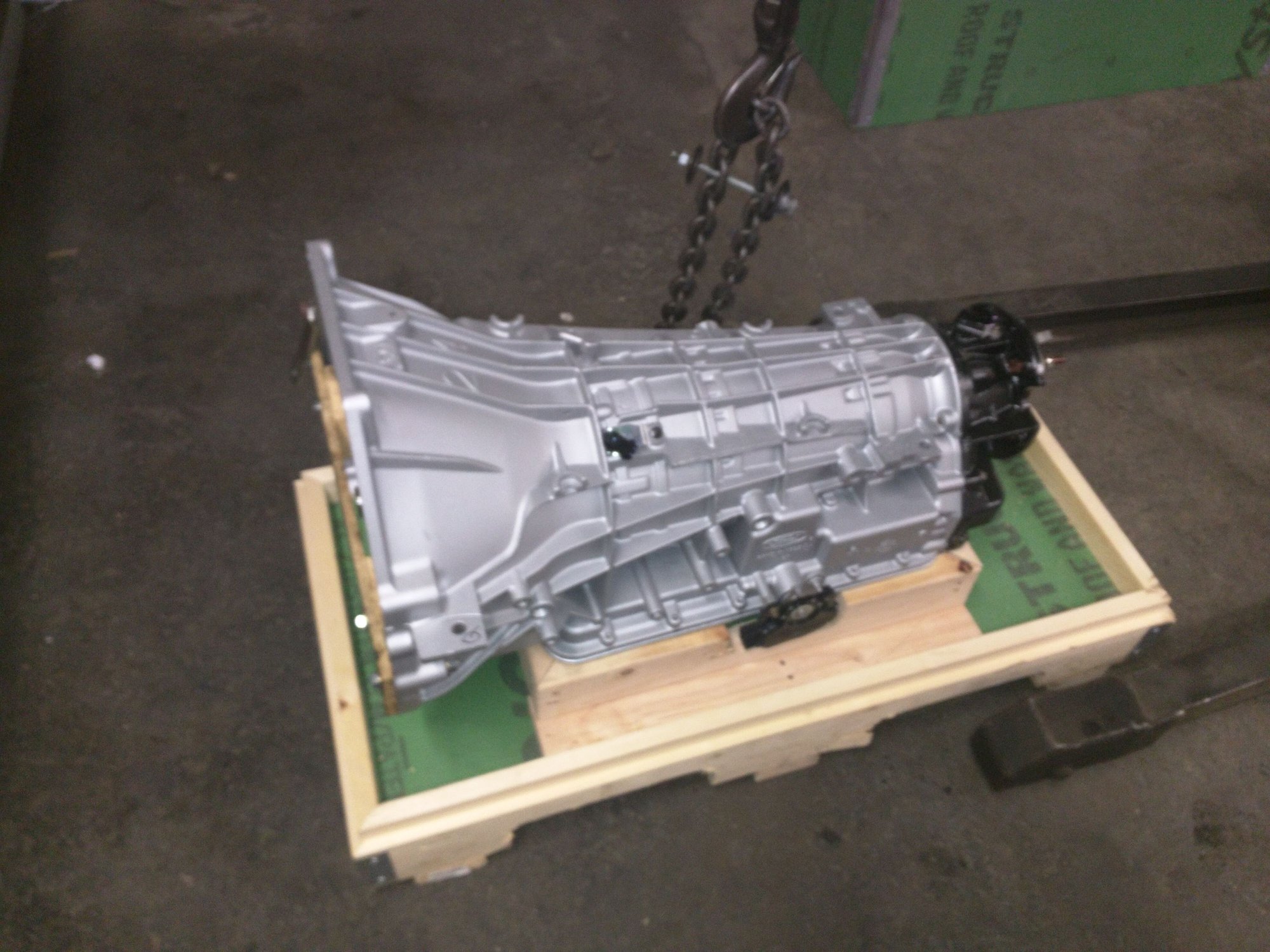

Hey guys, just put in a BTS trans and thought I'd give first impressions. You have to do a phone call with Brian before he sends you a trans. Took me about 5 weeks to get the call, then we talked about my driving, mods and how I use the truck. Got the trans 1 week later and put her in yesterday. Pretty straightforward install. The trans comes with all new sensors installed, a very cool looking 14" (I think) torque converter, and it's pretty to look at. It's about what you'd expect for what they're going for. I paid just under $6K, shipped to my state, which was $800 or so, if I recall (includes core going back). Brian includes 3 pieces of paper with the trans, a baggie of 6 TC bolts and studs (the nuts are already threaded on to the studs) and a pretty awesome shipping container special built for the trans and core return. You have to use his TC bolts/studs. There is a big warning that if you don't, you'll damage the trans. You hand tighten all 6, then you torque them to 35 lb ft. Pretty easy. Fill her with 13 qts of your favorite fluid (Brian didn't have a recommendation, but said, "You can use synthetic if you want with this trans", so I used Mobil 1 synthetic). Once you have 13qts in, fire it up and "IMMEDIATELY" add another 5 qts (6 in my case with the Mishimoto cooler). My original trans was still in the truck, @ 220K on her, and worked...but was fading. I would sometimes feel her slipping around 2nd/3rd gears under load. I'd let off the throttle, and she'd get back in line...but it was time. I'm running 180/30 FF injectors, JeliBuilt 'Modified Stock' tunes, a KC300 turbo, Adrenaline pump and whatnot. She is healthy, but I drive like the old man that I am. I noticed immediately that when I put her in gear, say to back out of our driveway up a very slight slope to the road, she'll pull herself out of the driveway with zero throttle. My stock trans would hit that same driveway slope and slow to a stop. I'd give her some throttle and she'd pull on out of the driveway. At traffic lights, my stock trans would almost sit there waiting for me to give it throttle to move. This one, not so much... Once you put her in drive or reverse, she wants to move. Not fighting the brake pedal, but once you let off that pedal...she's moving. I love it. Brian said the shifts would feel like a 'fist closing', and that's about exactly how they feel. Firm, but not harsh at all. I took my wife out this AM for a drive and she didn't notice anything about the shifting until I told her. My buddy put in a Sam Wyse trans and it's pretty harsh. I am sure that with the right top, my wife would expose herself if she was riding in my friends truck from the violent shifts. I told Brian that I am old. My wife is old. What I'd have wanted when I was young in shifting and watching her bounce around in her shirt, is not what I'm looking for at my age... That time has passed. He gave me exactly what I wanted. You'd definitely know she's firmer than stock, but not so much that it's unpleasant. My wife didn't notice until I told her. Pretty impressive. I noticed that the truck is solidly in each gear, where with the old stock trans, the TC seemed to be unlocked all the time. Give it some throttle, and the RPM would jump up and the truck would start moving. The BTS trans is firmly in each gear. When I lay in to the throttle, she is locked in gear and moving. I haven't given her a lot of throttle yet, as this turbo comes on pretty hard in the last few hundred RPM. I'm going to let her break in a bit and change the oil at about 500-1K miles or so. I have no doubt that after that first fluid change, she'll handle every bit of what my old 7.3 can give her. Right now, I'm just enjoying how much more power seems to be getting to the ground. I'm pretty sure my MPG will go up as just letting off the brake pedal moves the truck. She didn't want to do that before. I don't have many miles on her (@ 100), but they have been awesome so far. If she stays this way, I couldn't be happier with her for a daily driver and occasional tow vehicle. Brian and his gals in the office are as friendly and helpful as you could want, and I went with them because of you guys here on FTE. I'll update a few thousand miles from now, but I don't anticipate any issues....it's a transmission. I am looking forward to giving her some throttle after the first oil change, and seeing better MPG. Pretty sure that'll happen. Thanks to the guys at FTE for recommending BTS and Brian for a trans. They're not cheap (who is), but I think you get what you pay for with BTS.

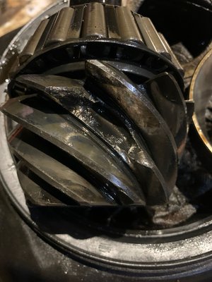

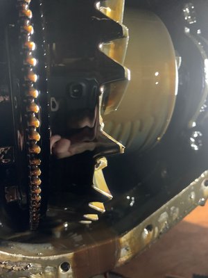

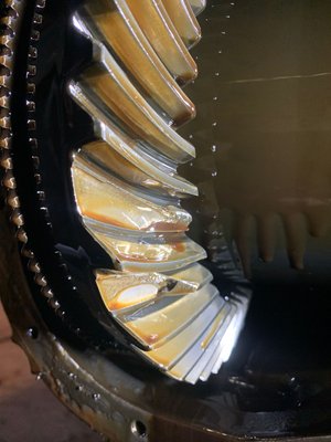

Let's just say this is what more power going through a BTS does to your ring and pinion gears.
