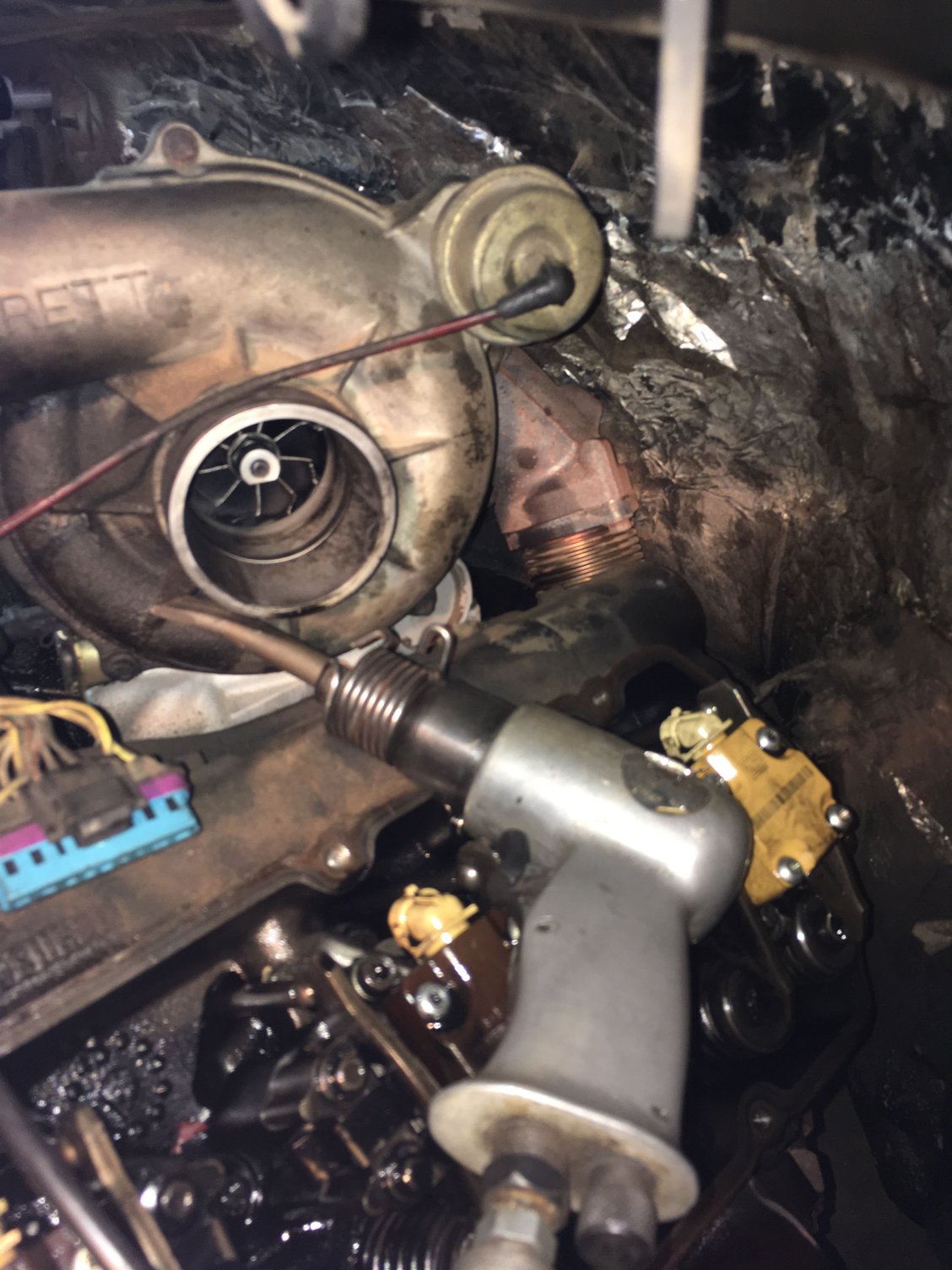

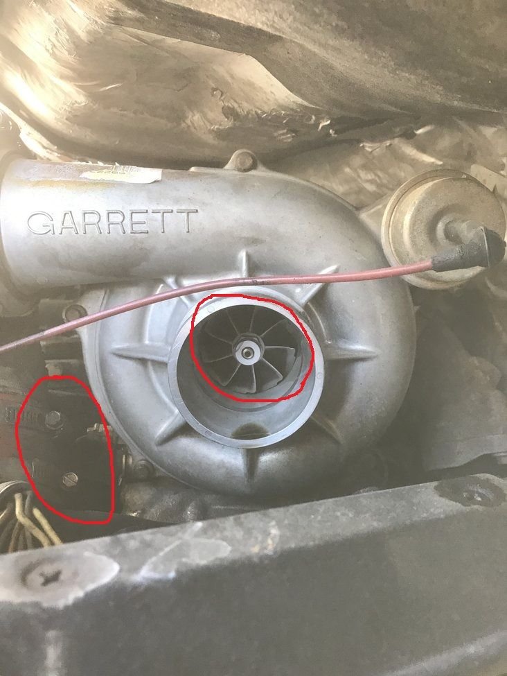

I am not sure if an E99 turbo is the same as the rest of them, but there is one in the classifieds section right now and he might be motivated to sell it...
https://www.ford-trucks.com/forums/market/1604571
If you decide to rebuild, I highly recommend the RR 4/4 wheel, it was a solid performer for me for many years. The RR boots and clamps are another great choice. You can loose a lot of power if your boots are not properly installed.
Oil in the intake is normal, as Mark has indicated. Not a big deal at all, as long as your air box/intake are sealed and no dirty air is getting in.
I know you said there is no shaft movement, but those notches concern me just from a quick visual inspection via the pictures you took. I cannot recall any other OEM wheel having those notches in them. Maybe there are though and I am wrong. If not, then there most certainly is shaft movement and contact.
Perhaps once the wheel is spinning at 20,000 RPM there is some movement, I don't know.

Originally Posted by Listor
Honestly Besides the oil this thing is burning, I am just trying to find out why and whats broken, that's why i am talking to you guys
wrong clamps on the plenum boot, damaged turbo blades
would suggest some rebuilding is needed
Those are the factory clamps, you can’t use t-bolt style clamps there unless you have the Plenum inserts.
How do you know the turbo burning oil? Is that picture of the turbo yours? How did the blades get damaged if there's no play?
Damage is likely from injesting dirt over a long period of time. Honestly, that damage isn’t bad...
That's what i am investigating, It was suggested that i look at the turbo, so i did and yes that is my turbo, No idea what they did to this truck before i got it LOL
I will pull the up pipes tonight to see if they are full of oil, if not then i will need to look elsewhere for the problem, BUT this will need to be dealt with as well
No reason to take up-pipes off....
You can remove downpipe and look for oil, coking, goey mess that would indicate turbo seal failure.

that dog-eared compressor wheel appears to have been making contact with the housing indicating the whole rotating assembly is probably shot. I’ve rebuilt turbos and there is practically zero shaft movement in any direction when they are fresh and the center cartridge is in good condition.

It is not possible for engine oil to get to the fuel filter in a stock truck.
‘Black filters’ are simply not from engine oil.
A failed injector o-ring between the oil and fuel ports WILL inject oil into the fuel side of the injector and BURN the oil. But there is not enough oil volume present to push oil upstream through the fuel to the filter.
More common is internal injector wear that allows the oil to mix with fuel.
I think if there is no evidence of raw oil post-turbo in the exhaust - we can rule out a turbo failure.
This compressor wheel took a beating. There was a k&n drop in filter and a broken air box.
No play in this turbo shaft (no smoke or other complaints). This truck was here for up-pipes and got turbo rebuild, RDP boots, RDP 4+4 compressor wheel, etc ‘while we were in there’.

wow that turbo looks like it ate a rock
