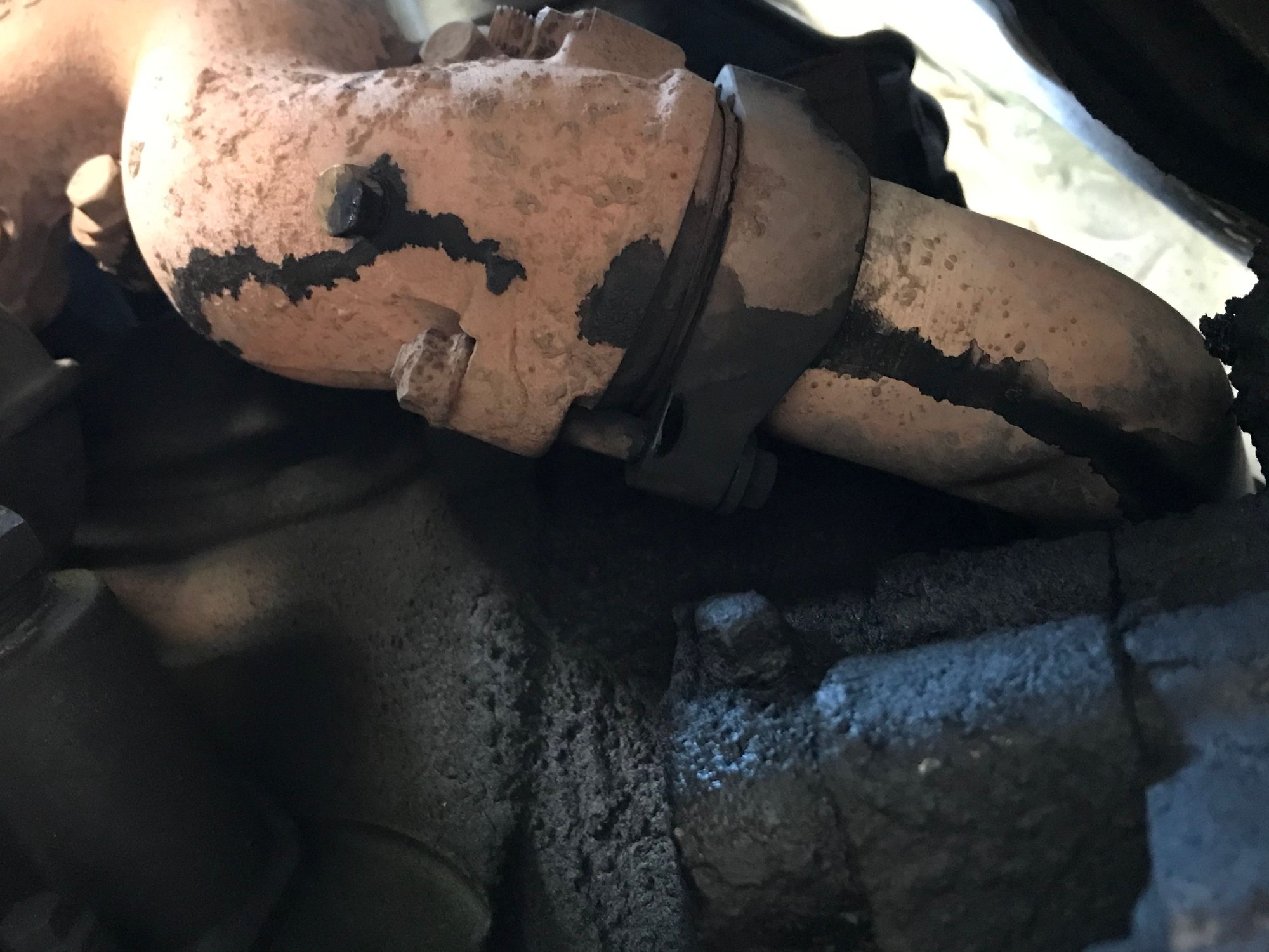

Originally Posted by Listor
I was going to take off the down pipe and this is what I see before I even get started
On the bright side of things, your manifold is pre-tapped for an EGT probe.
LMAO yes i know it has blown the plug several times already, scared the crap out of me the 1st time

It's ordered, done is done, I doubled checked for shaft play there defiantly is none, not going to be able to do the bellowed up pipes right now, something i will get to play with later, just need to get it back to working right
The lions share of the work to change up-pipes is removing the turbo...
Under $100 for up-pipes and (4) more bolts.
hmm, maybe, i'll look into it!

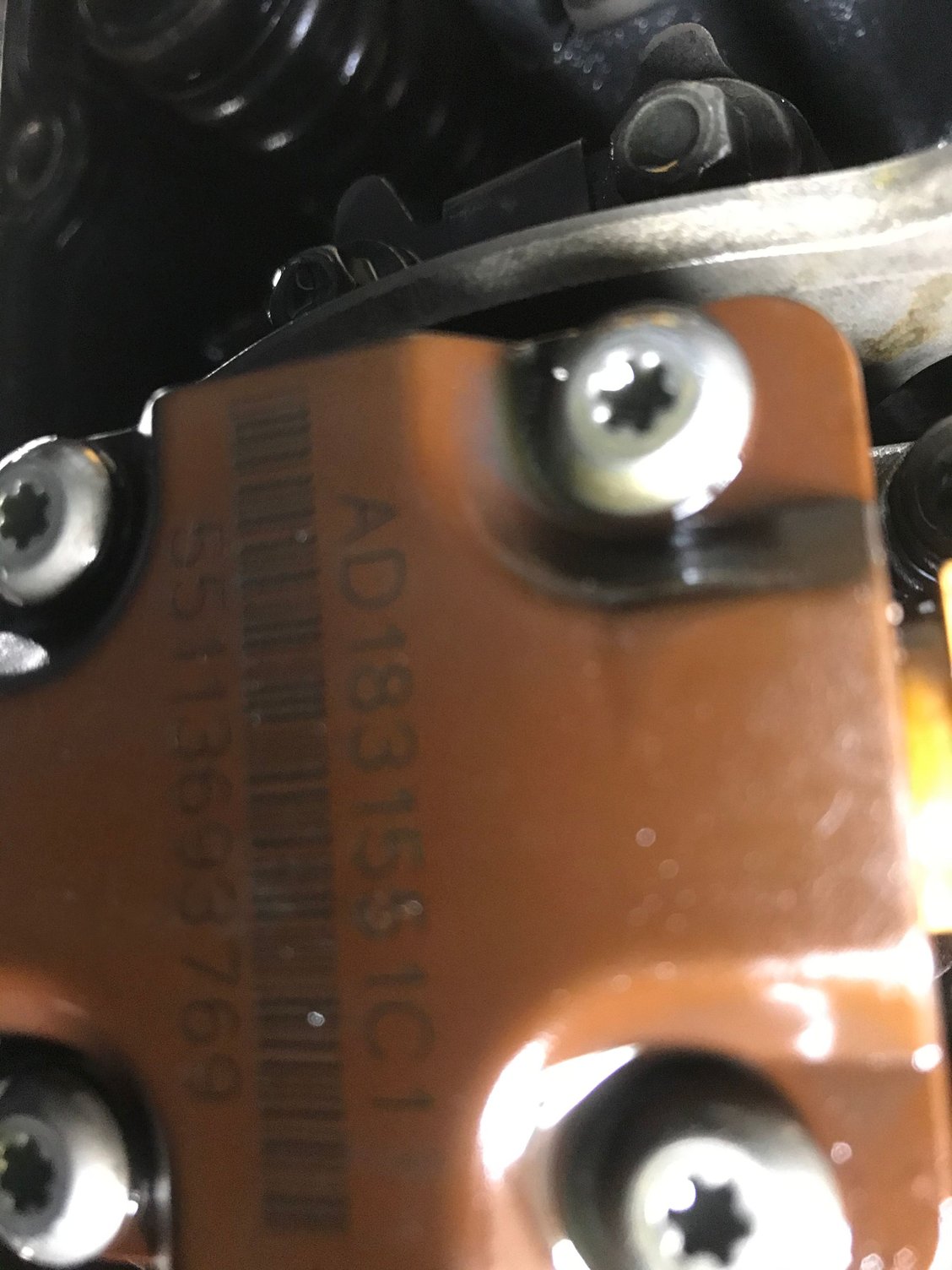

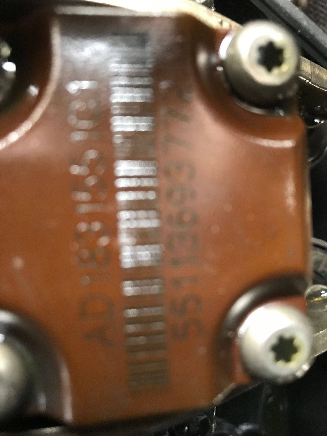

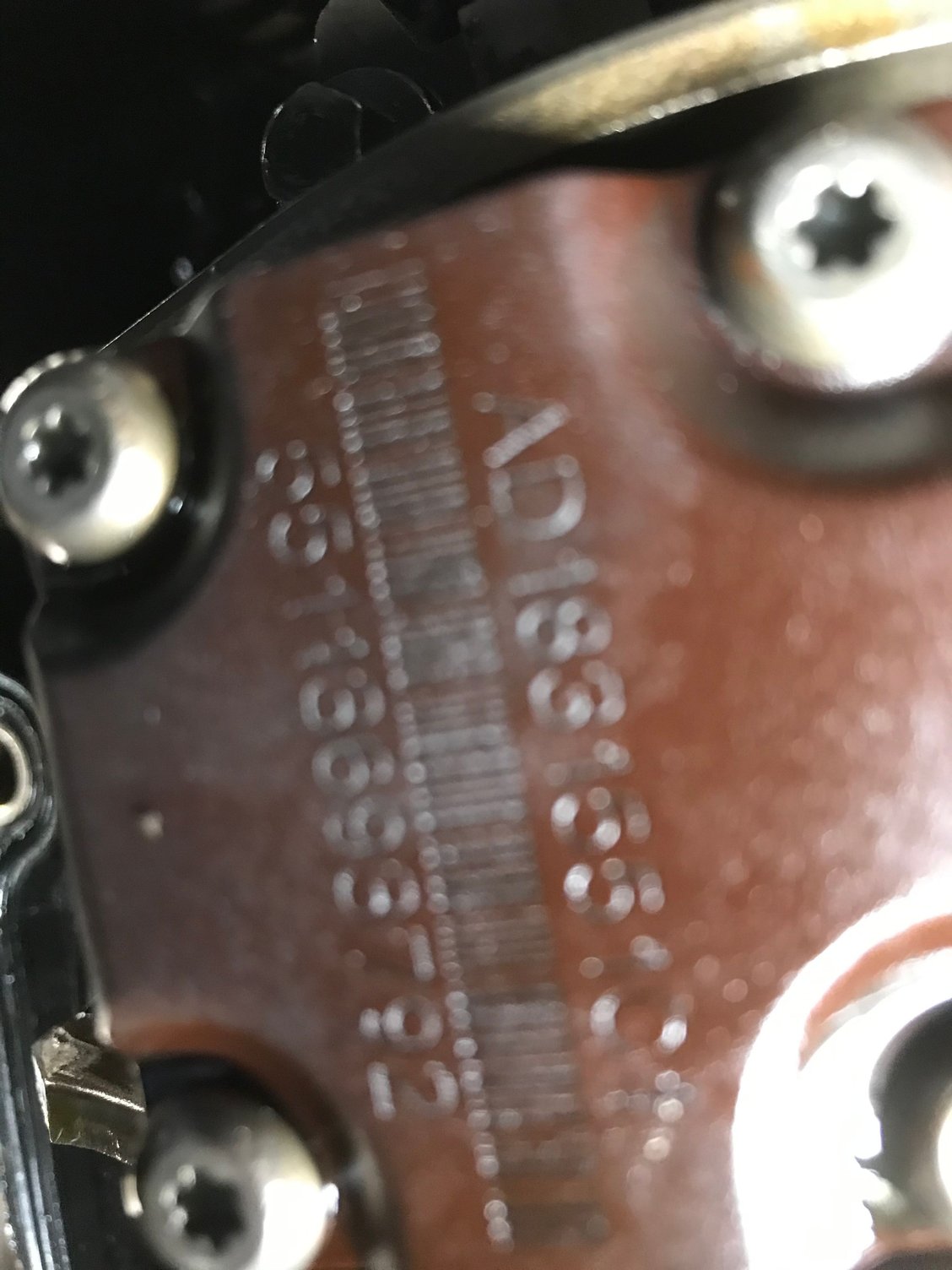

is that the right injector for #4 or does it matter

passenger side front to back, 1,3,5,7
Drivers side front to back 2,4,6,8
Front being where the radiator is. Hope that answers your question.

The injectors are not a matched set, if that's relevant but I'm going to guess that on that top one the AP stands for Alliant Power and the AD at the end would make it an AD injector but that's just my guess. Maybe someone else will know for sure.

i see it's just been replaced , thanks for everyones help once i get some parts in I will let you know if it worked LOL
