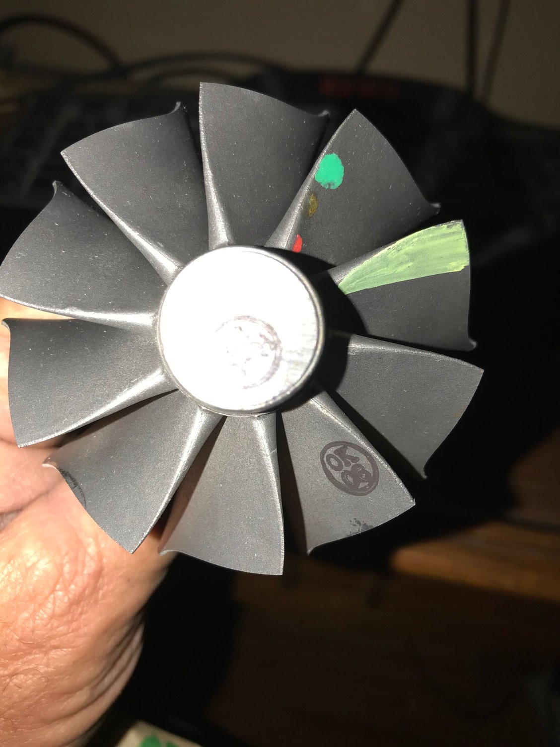

got my new turbo parts in, think mine was trashed in comparison

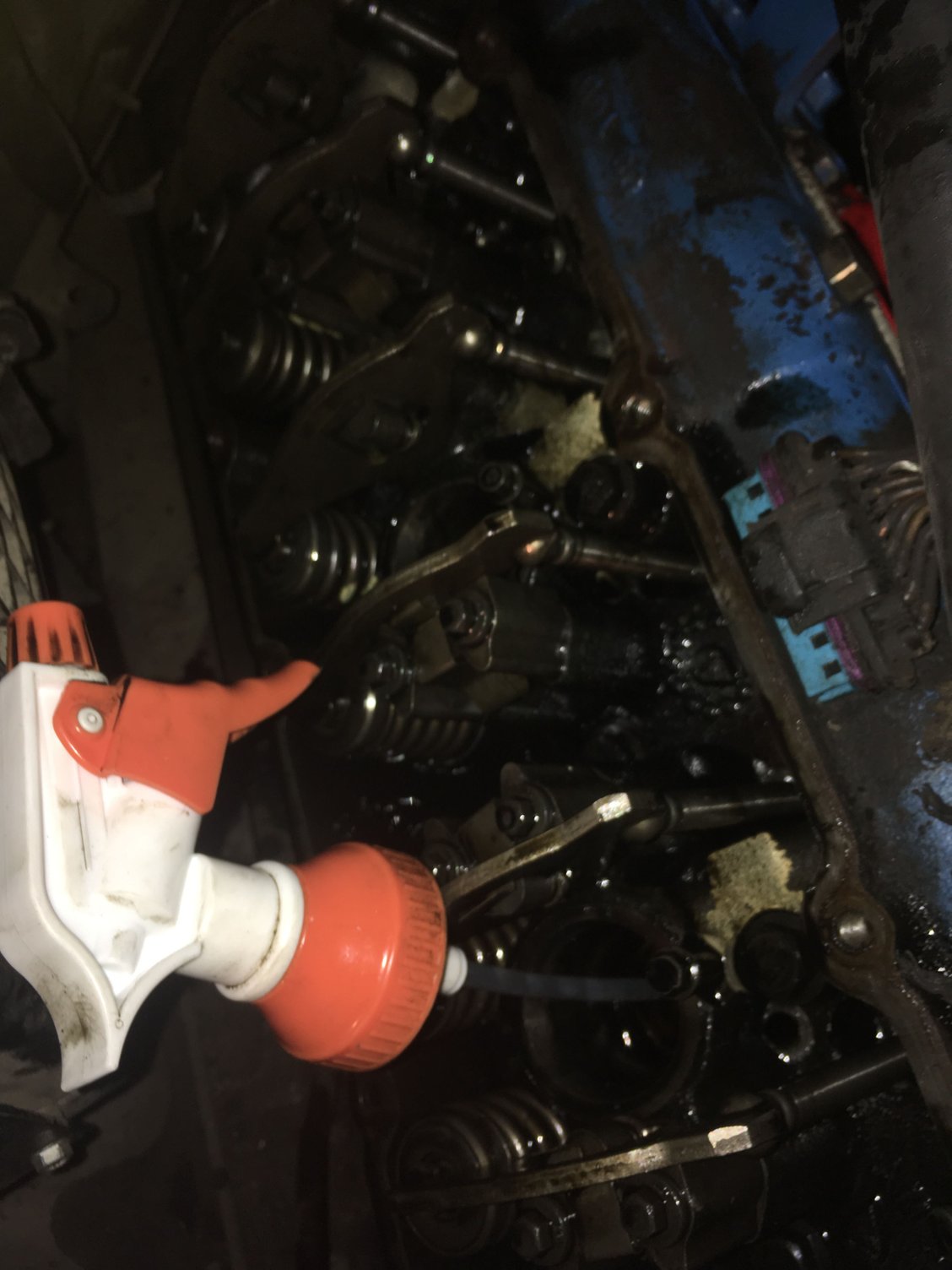

If you don’t find an obvious problem with turbo or external injector o-ring - you’re wasting time and money changing o-rings. The problem will be injector internals.
Hoping you find a compromised o-ring...
I would pull one bank of injectors at a time. Start at the back (7&8) so most of the fuel/oil runs into those cylinders.
Evacuate cylinders before installing each injector, then spin the engine over at least (2) revolutions by hand (with VC on!) before installing GP’s. Do not remove oil galley plugs like some directions suggest....
Holler if you’ve got questions!

I have a turkey baster with a piece of 1/4 " hose attached to pull the oil from the cylinder.

I don’t think 1/4” hose will fit through the hole. I stick a piece of brake tubing (1/8” maybe 3/16”??) in the hose on Mighty Vac to get in there.
My Mighty Vac broke awhile back and I did this. Hilariously and successfully !!
Aunt Cindy always said ‘Don’t compromise - improvise!!’

that's a good idea too , not sure if it's 1/4 ' been awhile since i rigged it up But it worked like a charm

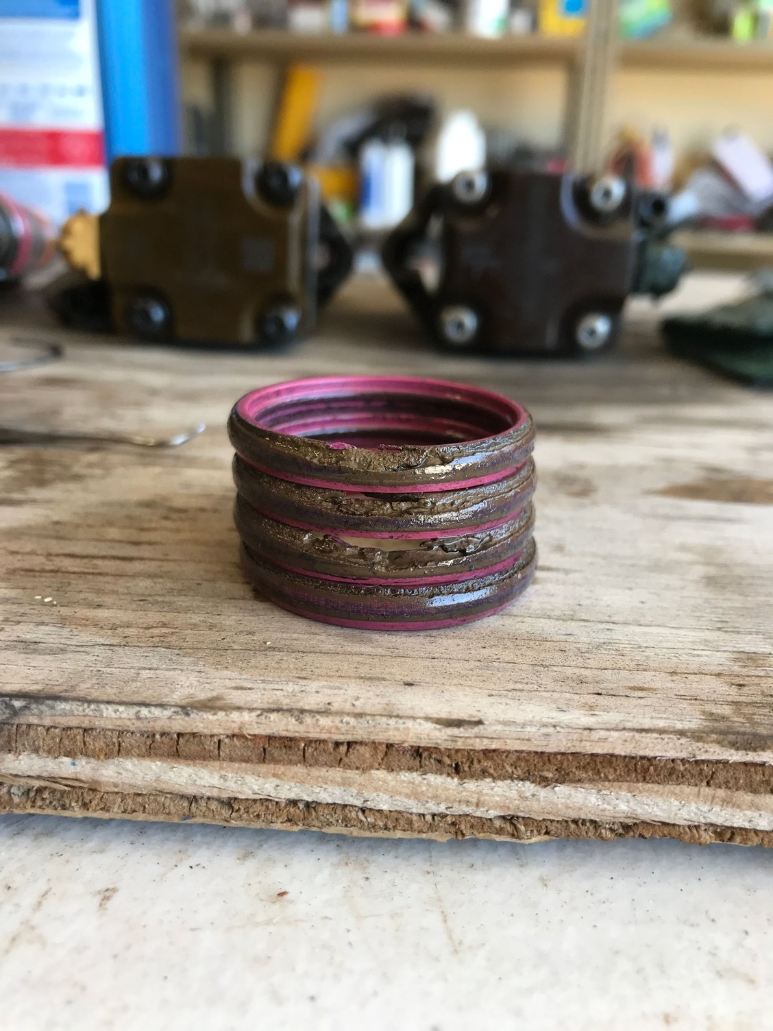

Damaged o rings from drivers side injectors

Got the drivers side done yesterday, going to do the passenger side today, hopefully it will go quicker cause i got things i need to do LOL
as i was pulling injectors i found 2 of my glowplugs were not even plugged in, replaced them all and tested the ones i pulled out, they are in perfect working order! (beru germany)
