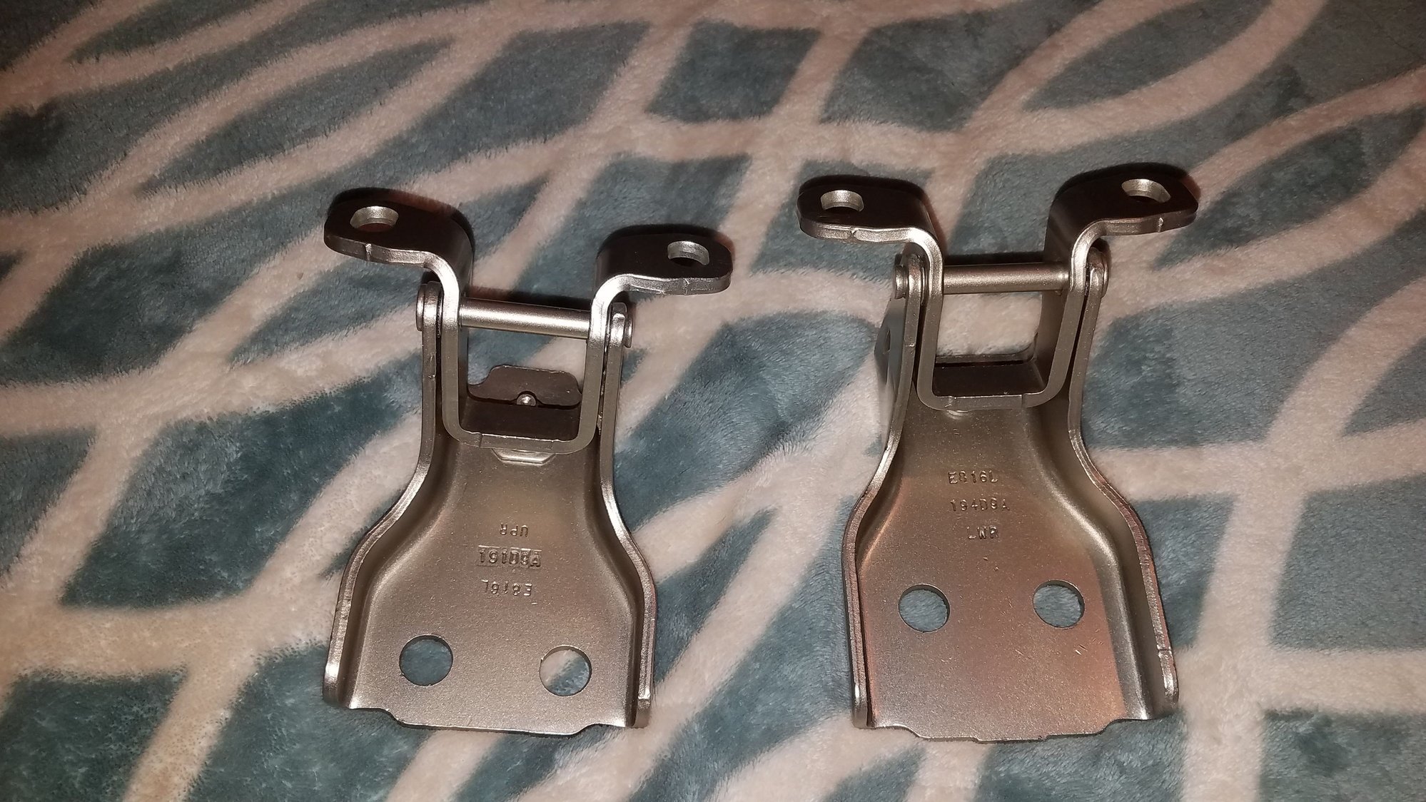

The paint came in two days early. Not sure when I can get these in, but man alive they are tight. No play in hinges whatsoever. But im getting everything prepped.

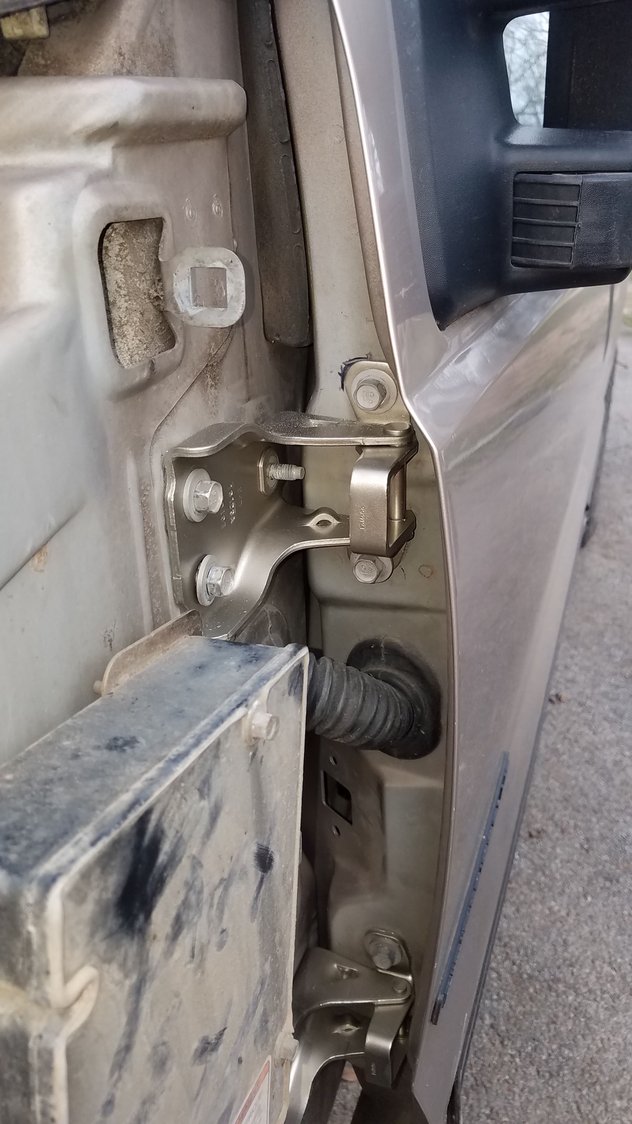

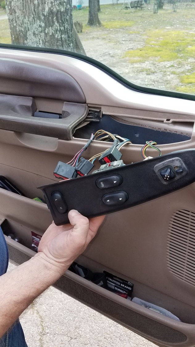

I am happy to report that the new OE Replacement door hinges are in on the driver side door. there is now NO dragor up and down play in the door whatsoever.

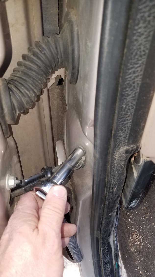

We started with the removal of the interior door panel. New door check going in, and we needed access behing driver door speaker.

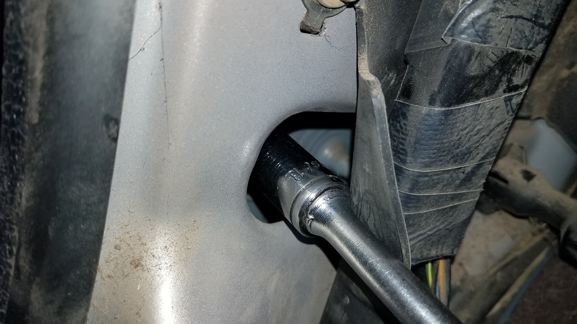

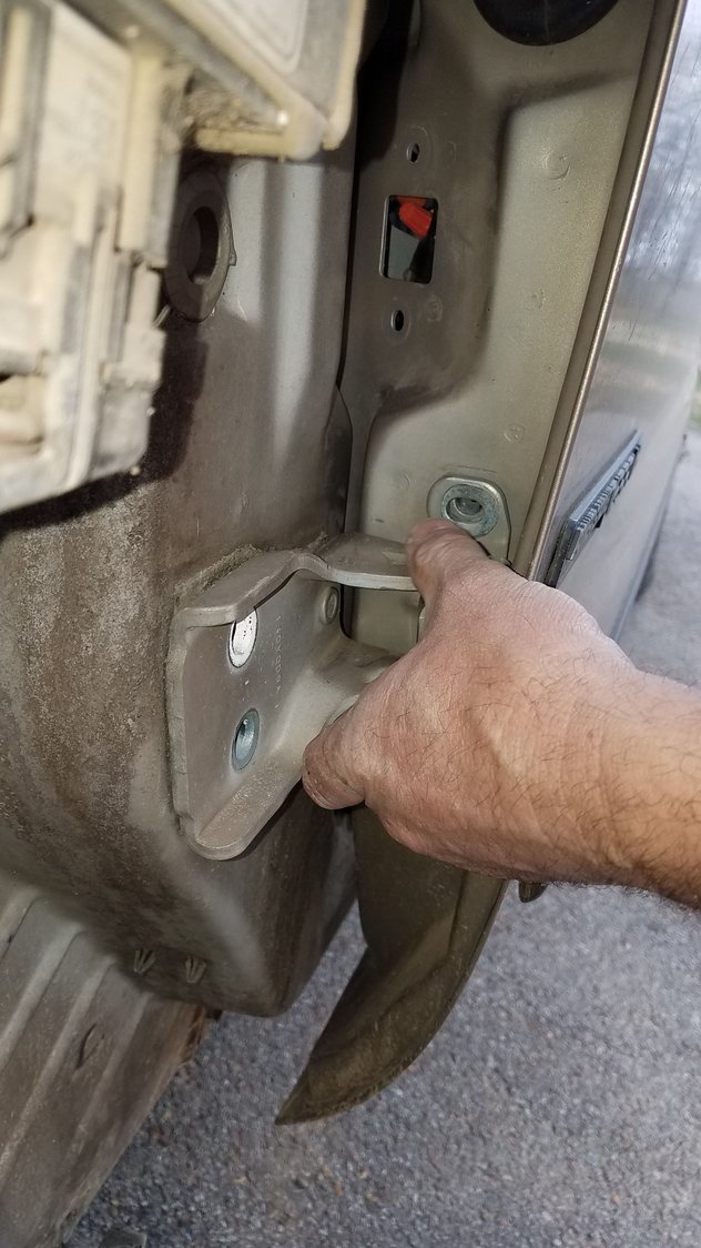

We also needed access behind the plastic cover of the hood latch panel. There is a nut with a 13mm head that holds the bottom door hinge. DO NOT DROP THIS NUT. If you do, do not waste your time getting angery. I got the nut loose and reach in with a bottom grabber to back it out the rest of the way.

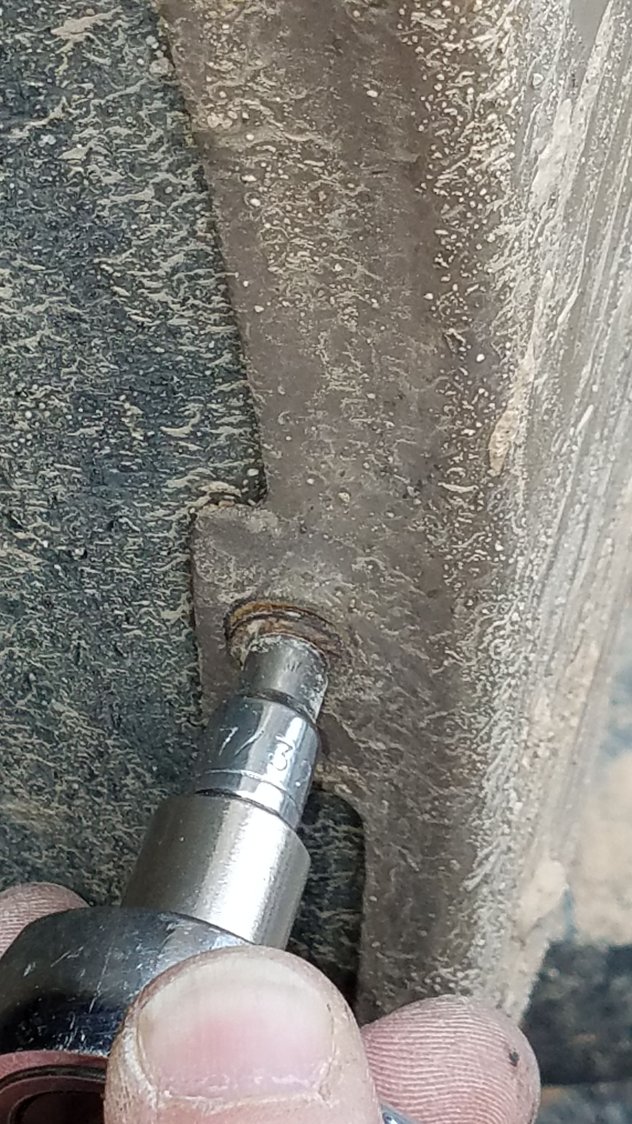

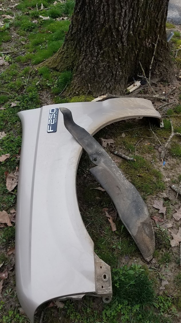

Next we started taking the quarter panel off. 4- 7/32 bolts in the fender well.
3- 8mm bolts in the headlight area. And 3 bolts under the hood. 2- 8mm, and one 13 mm that is also the anchor post for the hood strut supports. Use caution removing the hood strut. I found out the QUICK way, One strut would not support the weight of the hood. I'll be replacing them soon too.

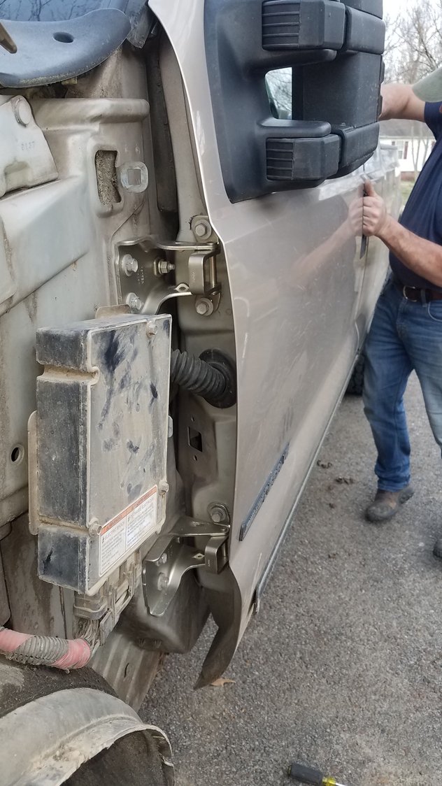

There are also 2- 8mm bolts removable in the door hinge area and 2 that were under the running boards. Something else is in this picture that is no longer a part of my vehicle.

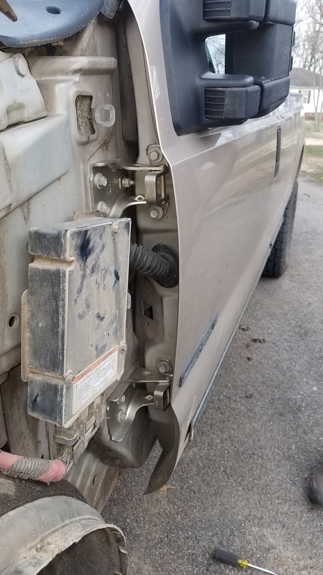

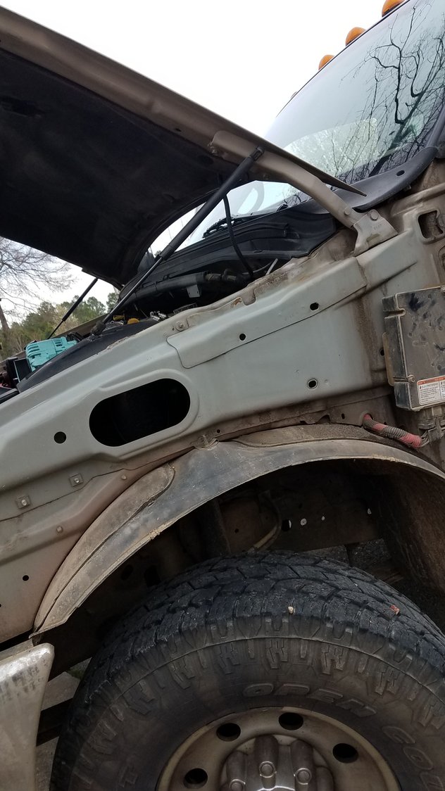

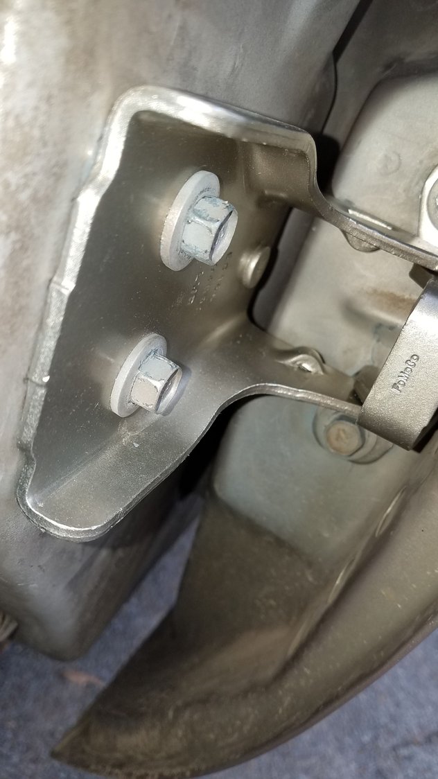

This is the reason i removed the quarter panel. Full access to the door hinge bolts and one nut on top hinge. Now i do not have worry about paint removal with a rubbing tool and the adjustment needed was Simple.

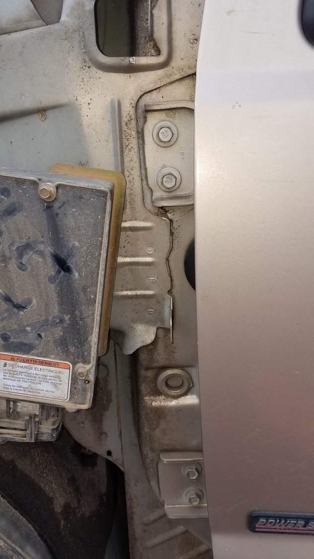

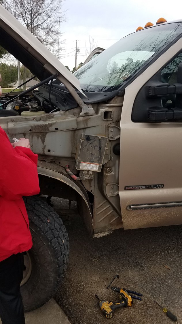

In this picture????? IDM or PCM? which is this behind the quarter panel?
Full access to the hinge bolts.

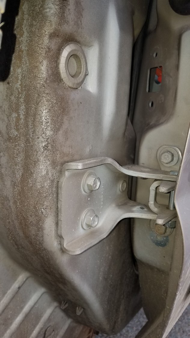

It was still a bit challenging removing old and placing new door hinges. We did the bottom one first. That door if freaking heavy.

Removal of door hinges.
In stalling of new hinges. After we got new hinges in places we shut the door. With the door shut we snugged the bolts to the frame work. I had her push to hold the door closed tight and i tightened the bolts to the door. Top and Bottom.

It's the IDM
Well done dude
