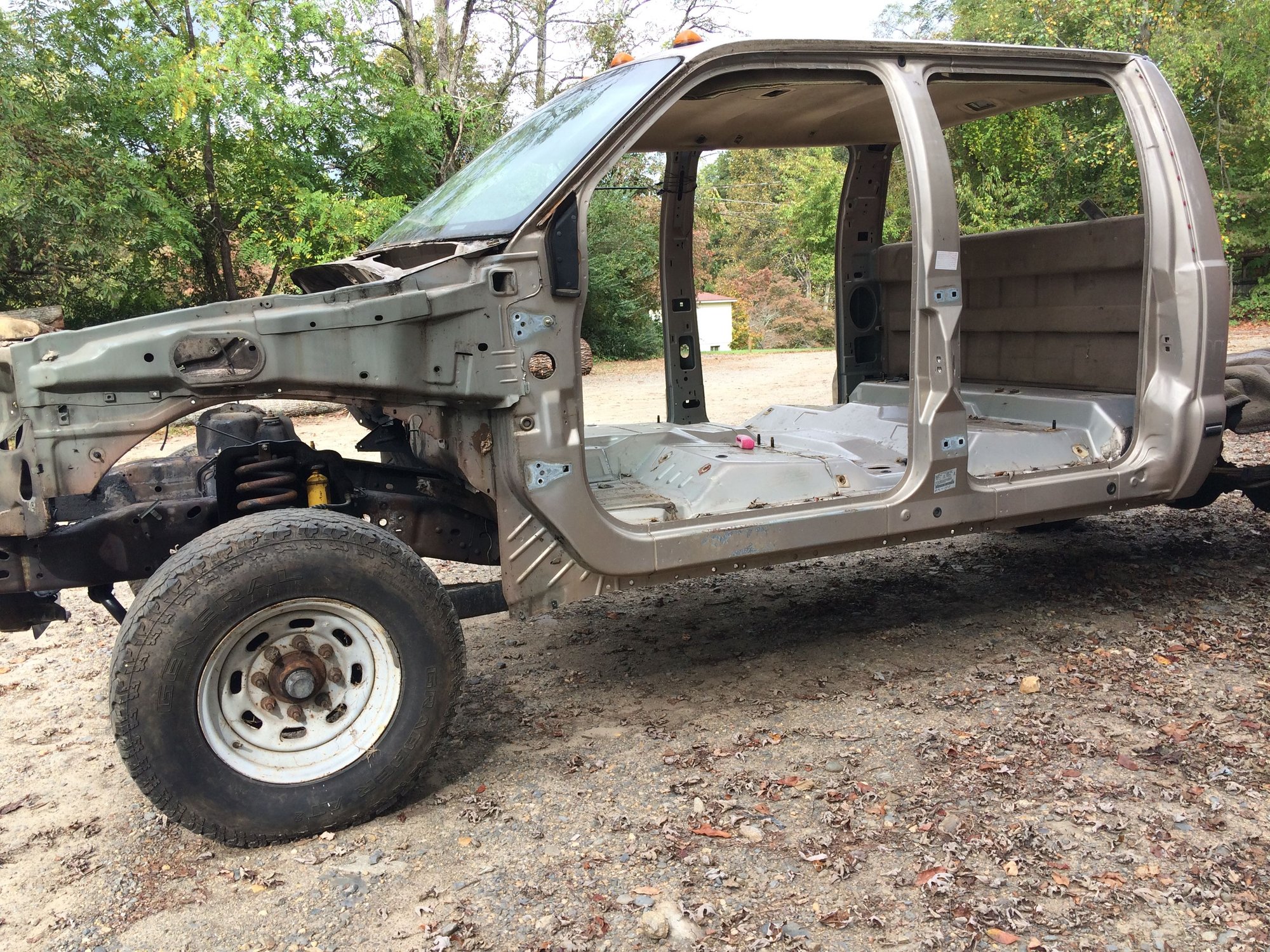

Jason, can you show me on this picture I barrowed from you. Where or how do I get to this bolt? The hinge one my truck at this specific bolt does not sit flat on the body for some reason. It almost seems as though the bolt has a shoulder on it that needs to be maybe be
turned to fit in the hinge. I've tried several times to tighten this bolt, but again it leaves a gap between the hinge and the panel where it should seat.
