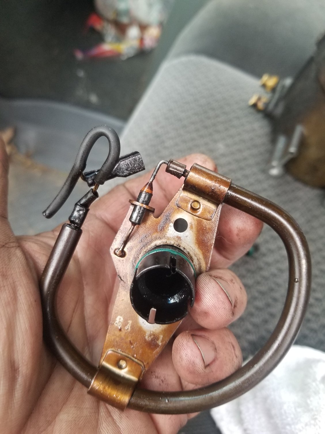

I am concerned currently with the fact that my fuel bowl is holding so much pressure, and suspect some obstruction of fuel flow out of the bowl. That is my target today. Any advice on that topic? Fuel bowl diagram, maybe? Trick for testing without a gauge? Sous mentioned the standpipe in the bowl having slots that need to be properly aligned. Anybody know about that?

The "standpipe" in the center of the fuel bowl is spring loaded and the spring holds a valve shut that is disengaged by the fuel filter. This prevents the engine from getting fuel with no fuel filter in place and if that nipple on the inside of the fuel filter is broke or missing, your engine will not get fuel. IDK how to check fuel pressure without a gauge.

I pulled the fuel bowl, checked everything for obstructions. Found the valve inside standpipe to be stuck closed. Tapped it loose with a screwdriver and now it doesnt close all the way. Reinstalled standpipe into fuel bowl and fuel bowl into truck. New fuel filter and cap. Thought that would be it... but still won't start. But at least my fuel bowl is gunk free for now. Moving on to... I don't know yet.

The fuel pressure regulator is a spring loaded plunger on the top right of the fuel bowl as you look at it from the front. I believe that the return line attached directly to it. If it is damaged it could cause higher fuel pressure but I know now what kind of trouble that could cause, if any.

Checked the spring loaded doohickey on the return line when it was out, opened easily with a screwdriver and I blew through it from the outside and nothing funky came out, blew through easily, tasted like crap.

Bill at PowerStrokeHelp is a bit of a nutcase, but there are some good nuggets of information in his ramblings from time to time. I don't like to quote him, but he has a pretty good description of the standpipe and the slots in it that will can misalign and cause an issue. A couple years ago someone on here (wish I could remember his name and find the post) that had done some service to his fuel bowl. Turned out the slots were misaligned and that was restricting the fuel flow. The truck would start, but any throttle input and the truck would stall.
Anyway, at 4:00 into the video below, Bill shows the standpipe and you can see the slots in the standpipe and the internal pieces of the standpipe.

Thanks Sous, I have seen this guy in other videos I have watched. I did remove the standpipe valve, but the top plunger was stuck in the standpipe, had to tap it out with a screwdriver, after which it did not seat all the way leaving the valve ports on the side slightly open, but it then moved freely. Thought that was it, but it still won't start as before. Fuel pressure regulator was very easy to open.
