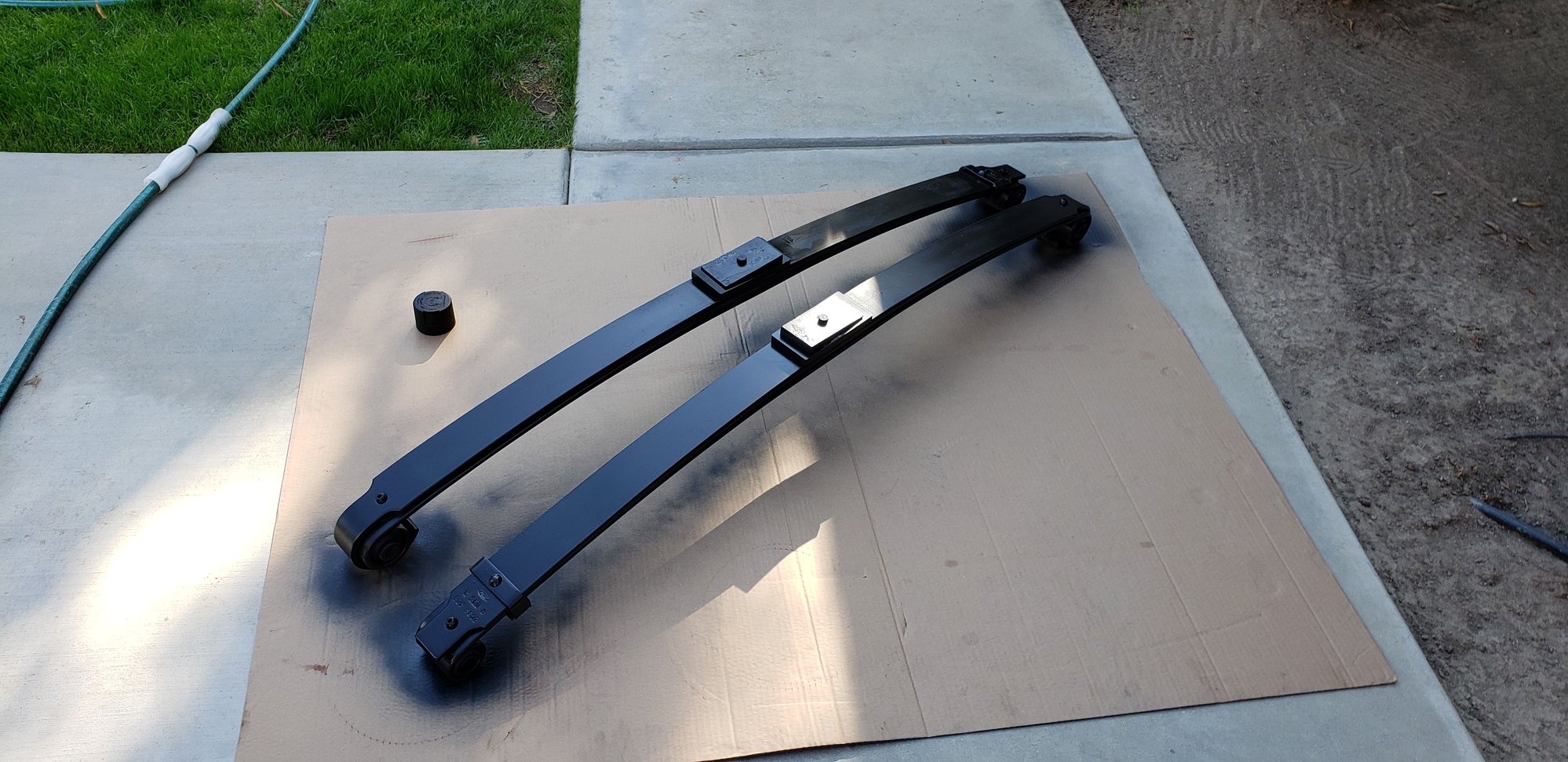

Did some more work on Shamu this weekend (surprise surprise, my wife always says). I did my oil change with the new Delo, truck seems to really like it so far. We'll see after 5000 miles.
But today I did some major work to the front end. and PAINTED IT! I picked up 2 more cans of the Seymour Stainless Steel paint (knock off STEEL-IT AGAIN), and sprayed the whole front end. My Dad (58 years old) got out there on his hands and knees and helped me pull it all apart, we were both crying in agony at the end though lol.
Got the whole front end apart, springs and all, and we sprayed the frame wih Black first, (so many runs, either we buy the *****tiest Rustoleum, or we're terrible at painting, probably the latter haha)
All of the suspension parts and axle got painted with the SS paint. Very little prep work went into these parts, only a wipe down with some Purple power and we shot them! The Seymour SS paint works AWESOME! It sprays nicely and even if you lay it too thick in an area, it self levels and you cant really tell. It also is dry and ready to touch/install in less than 10 minutes. I LOVE this stuff!
Springs went regular black for some contrast.
Nice looking shackle
Springs installed.
Axle and brakes installed
Shocks, steering, and tires went right on.
Upskirt haha
Shot from the rear.
And drove her home. All is well.
