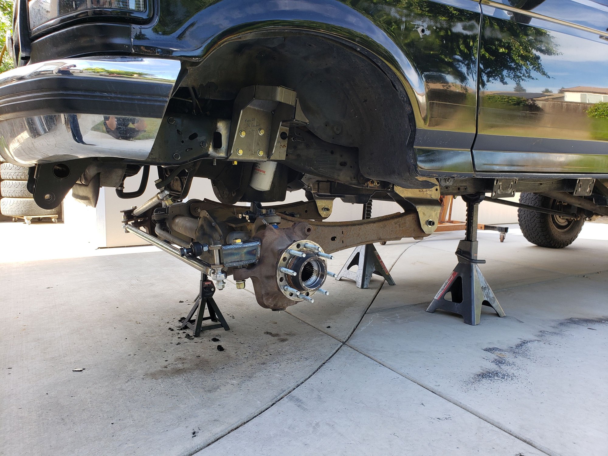

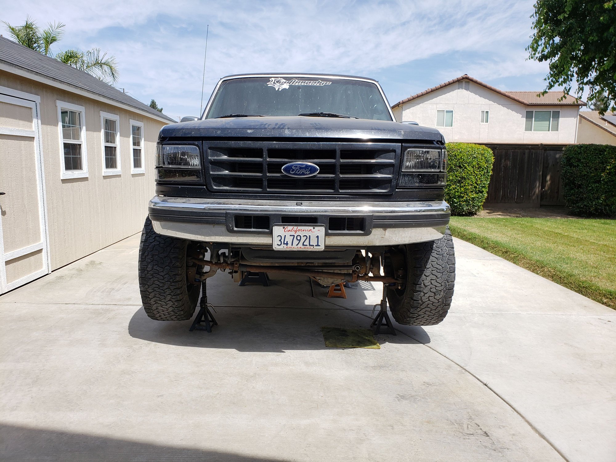

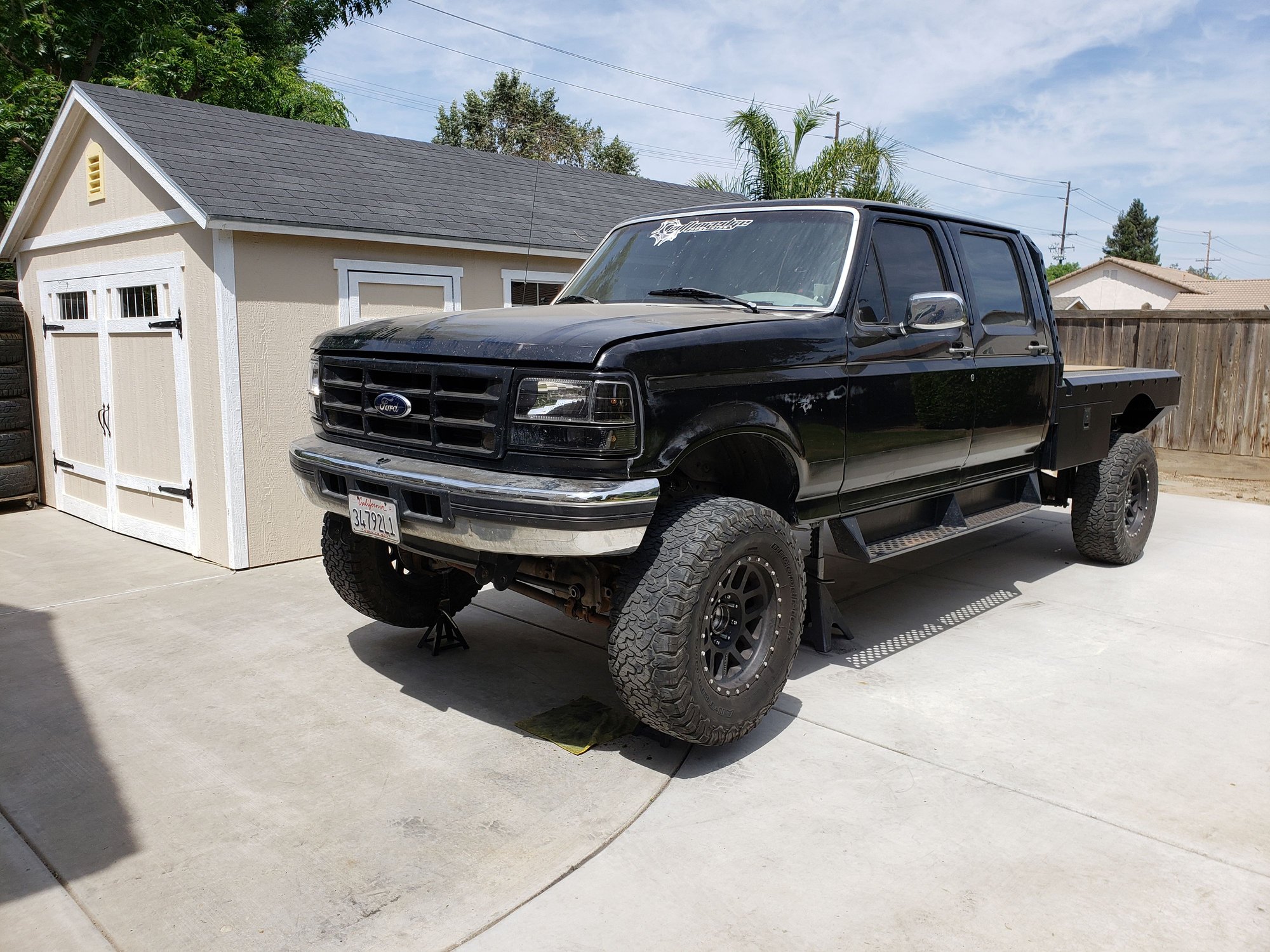

Got to work on Shamu a little more this weekend. Got the axle swap started.
Up on stands
Axle out
Sandblasted the new axle to make things a little easier
Then after several hours of grinding/cutting my old shock towers off, I semi-assembled the new axle and slid it under the truck.
Next is to finish cutting off the rear shackle hanger that I welded on from SORD, and then cut the front hanger off too. After that, I scan the frame/axle in place, CAD up my radius arm mounts, shock towers, track bar mount, and sway bar mounts. Then I can cut/form/weld and test fit everything, make my drag link and center link, and then send EVERYTHING off to powdercoat, then I can do the final install... looking at atleast 2-3 more weeks, but after that, I will be able to offer a full bolt on kit for the OBS to 05+ axle swap.

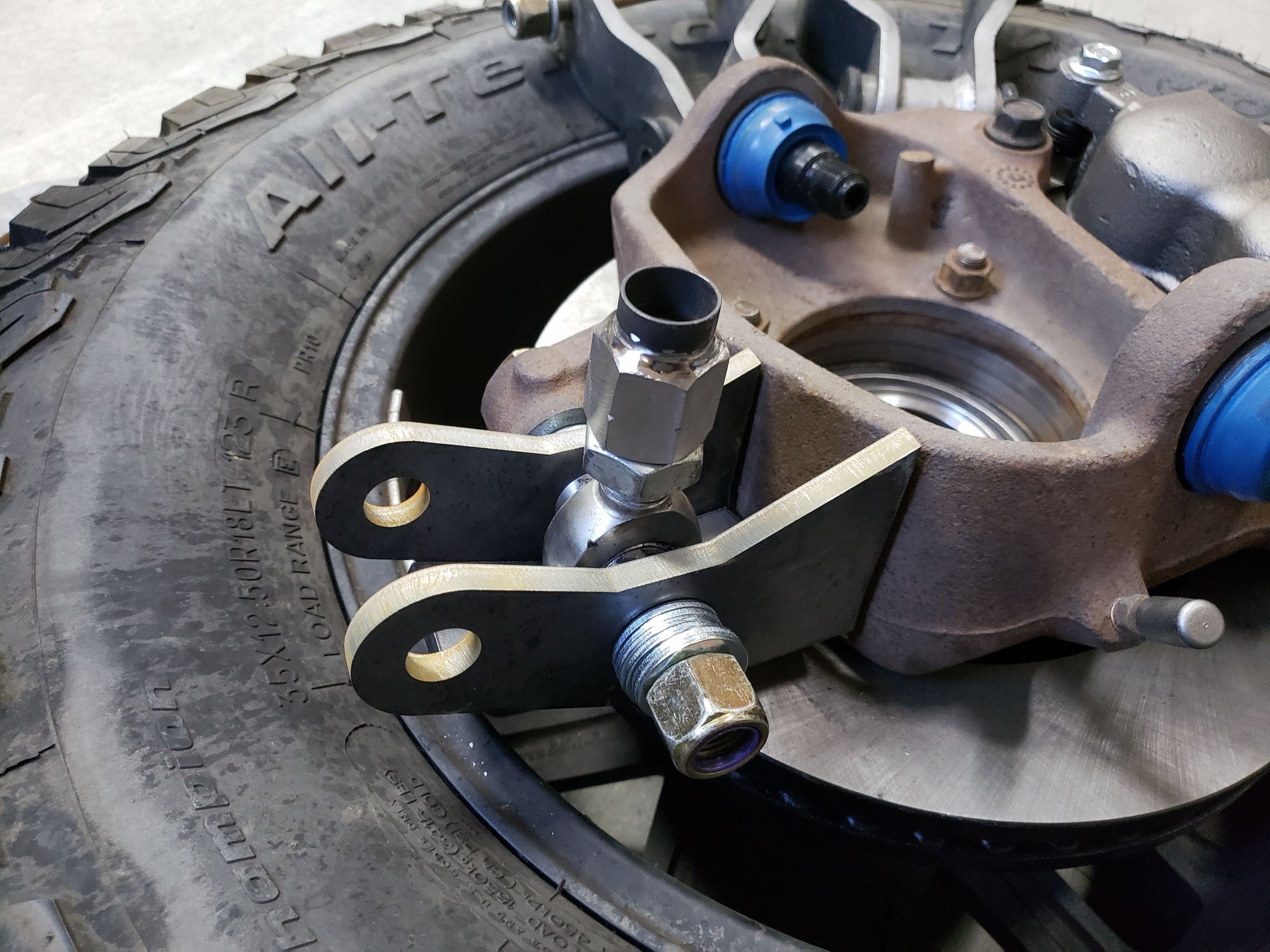

Finally got around to cutting the double shear steering arms. They fit pretty good. Can't wait to weld them on and try them out.

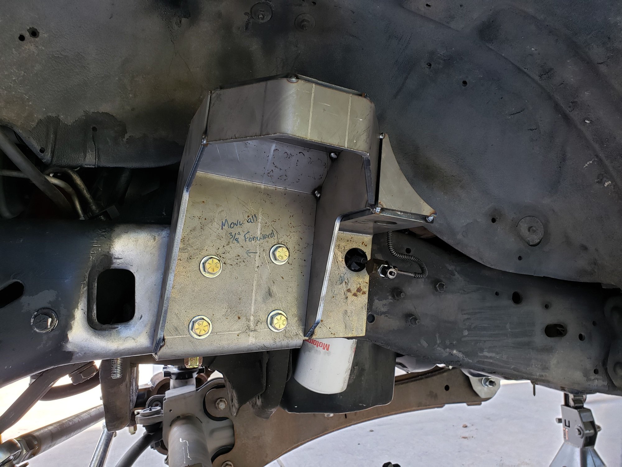

Got more work done on the 08 axle, got the brackets cut out and bent up. I test fitted them on the frame, and some small adjustments need to be made for any future kits, but these will do just fine for me. Most of the holes are drilled (which I hate drilling holes in anything, frames are the worst), the axle is installed, custom high steer arms are welded on, and all the steering is made.
Now I have to make the track bar mount, sway bar mounts, drill a few more holes, weld everything together, do a final test fit and maybe a test drive, then it all comes back apart to go to powdercoat...
