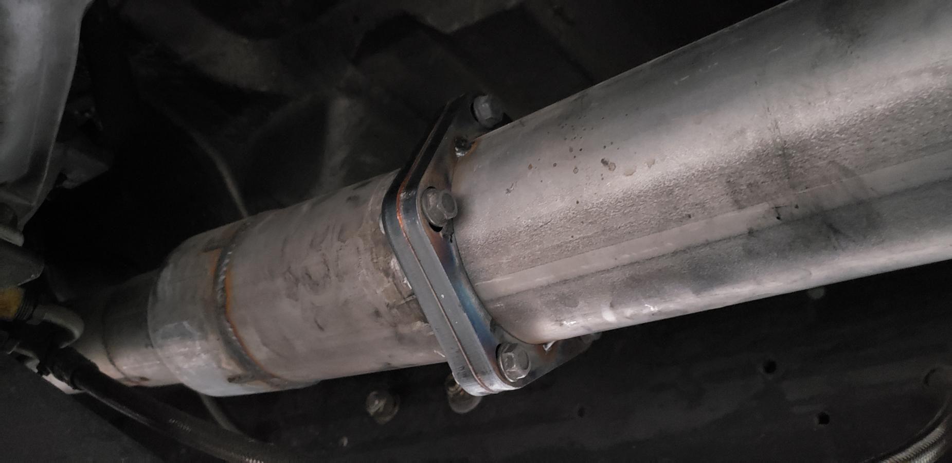

I was tired of the cheap *****t* exhaust u-bolt clamps, so I welded the whole system together and put a flange in at the front and back. But I kinda messed up, and put the flanged head bolt too close to the tube, so I had to weld the INSIDE of the tube to the flange. Atleast its clean and low profile though. Uses 5 bolts to get the best clamping force that I could. Using .060" Copper for a gasket, and 3/8" mild steel flanges, all cut on our laser at work, perfect fitment, and no leaks!
I used a press-in nut, (Or PEM nut, is what we call them), makes for easier installation and no wrenches required.
